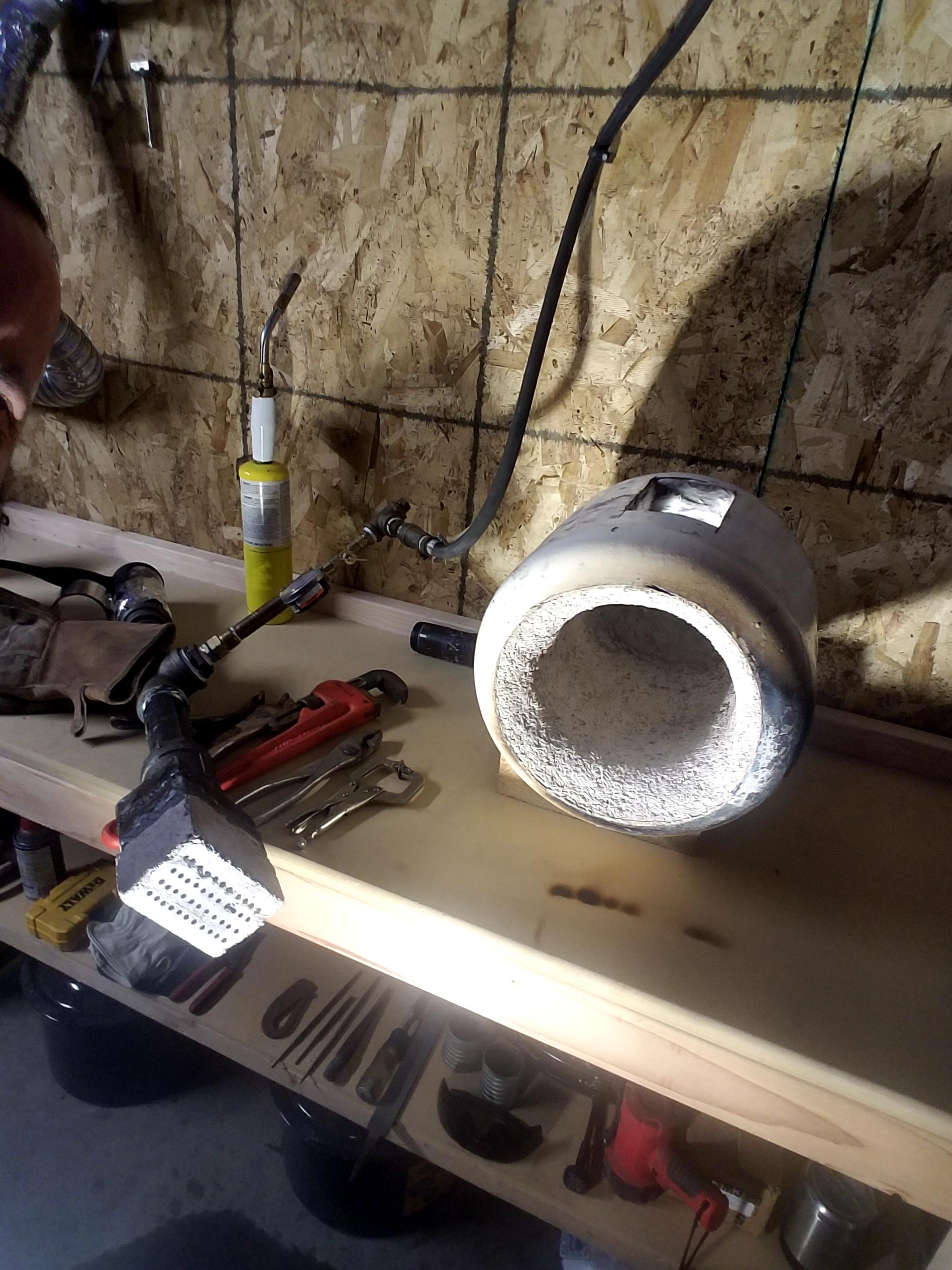

  2. Ok, so after over a week of setting, curing, etc etc, i finally have results, and im more then pleased, simple specs, 5 inch ribbon burner, 1 1/2 inch pipe 12 inches total length, .030 mig tip, 20 gallon propane tank. Ran at 10 psi for 15 min, then down to 6 psi remainder, forge weld heat achieved, and usage of gas dropped dramatist. I found that i could turn down the psi from 10 psi, down to 6 psi, i even went as low as 3 psi but i could tell heat exchange was loosing temperature. 6 psi seems to be the key in my forge, will it be in yours? I cant tell ya, here are some pics of the build, xxxxxxxxxxxxx for more info and pics as i dont want to make the post outrageously long, much info on this forge will be xxxxxxxxxxxxxxxxxxx All in all, im more then pleased, and very happy with my results. Advertising removed

  8. Arctic, i have done the same thing your doing, ive been forging now for 3 yrs, i always read through these forums and thought well i can tweak this, or try this, andhave spent more money then i probably should have and have lost more time tearing down and redoing my forges... Ive learned alot actually paying attention to what Frosty and Wayne and a couple other notables have said and taught, Id follow there advice andspemd the money once instead of 4 times like i have, btw, here is my ribbon burner , i made myself, cost me 13 dollars US to make.
