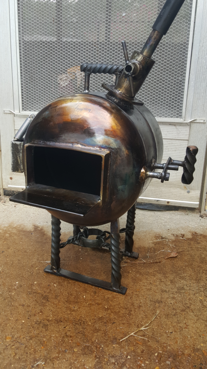

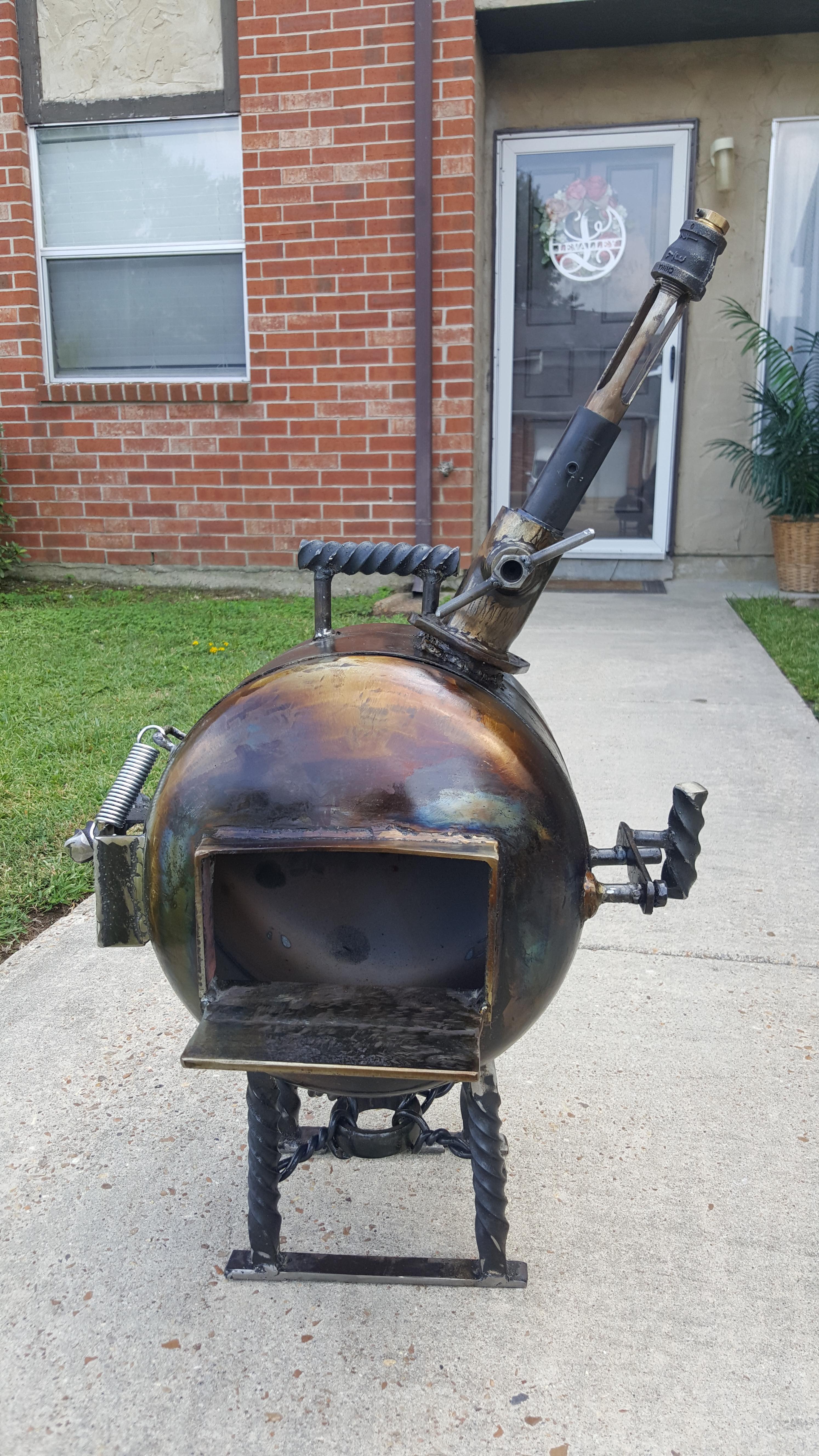

1st forge build from propane tank.
SwampFox Rocketry replied to SwampFox Rocketry's topic in Gas Forges
Thanks guys -

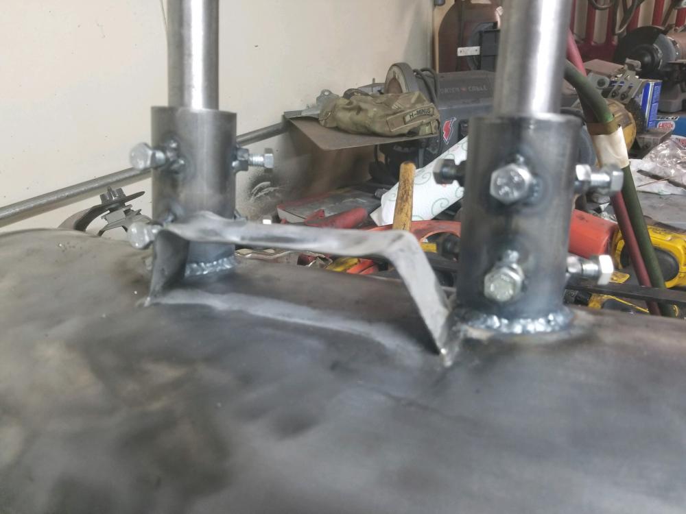

Thanks MotoMike i agree with the steam punk look. Irondragon forge and clay you are correct in the narrow legs. While sitting with door closed its very stable door open leans it wants to lean over slightly. Yes I agree extending legs will help too thanks for your thoughts guys and recommendations. -
Thanks stevomiller will do. -
Here's my 1st forge build after buying a welder and feeling creative. The builds off scraps and low buget in mind. Using burners from my other forge on this one as well. Steal was scavenged from trash people were throwing out and stuff I had left over in the metal pile. But was a fun process thus far learning and creating.

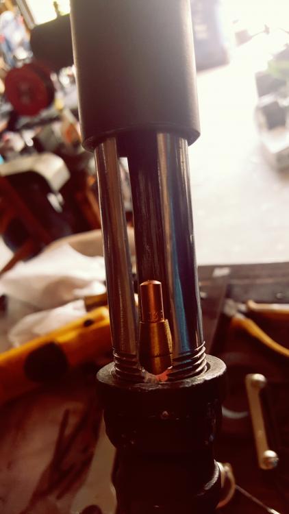

Are these burners running right?
Made air slots wider to see if I can adjust a little more from the choke, and filed down my contact tip a bit until i cam order some that are tapered. Slots still ruff will smooth them out when i get back to the house. Ok will do. Thanks guys -
Thanks mikey i think i know the tips u speak of the ones shaped like a pencil ill look into getting them and you say i should slide to 3/8 of an inch to air slot opening ends. Will do mikey appreciate it. I brought the tubes to work and im working more on bevels with a hand file appreciate all your help. I will continue to improve it thanks. Made air slots wider to see if I can adjust a little more from the choke, and filed down my contact tip a bit until i cam order some that are tapered. Slots still ruff will smooth them out when i get back to the house. -

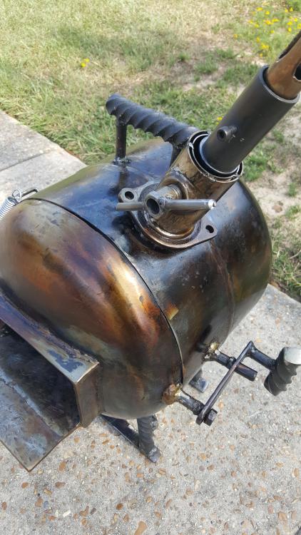

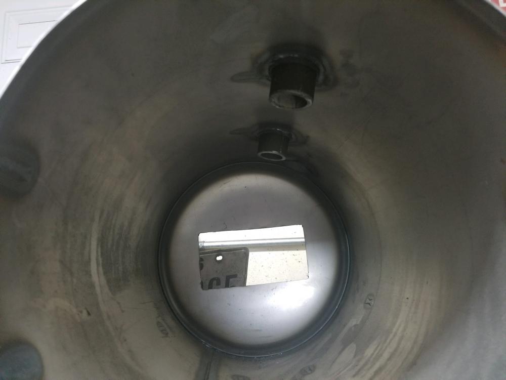

Here's my gas forge build its made of a 40 dollar air compressor tank. Has two mikey style burners which the kind folks on here have help me improve, and 2 inches of kaowool with rigidzer and refactory. Its inside deminsions are 18 in length 7 inchs wide and tall. I had to order some more refractory and will be finishing shortly.

I beveled the bottom ones on the inside of tube its been a pain with files i currently have will keep at them though. Off to work thanks for ur guys help though. Ill keep u posted. Heres a before and after photo of flames -

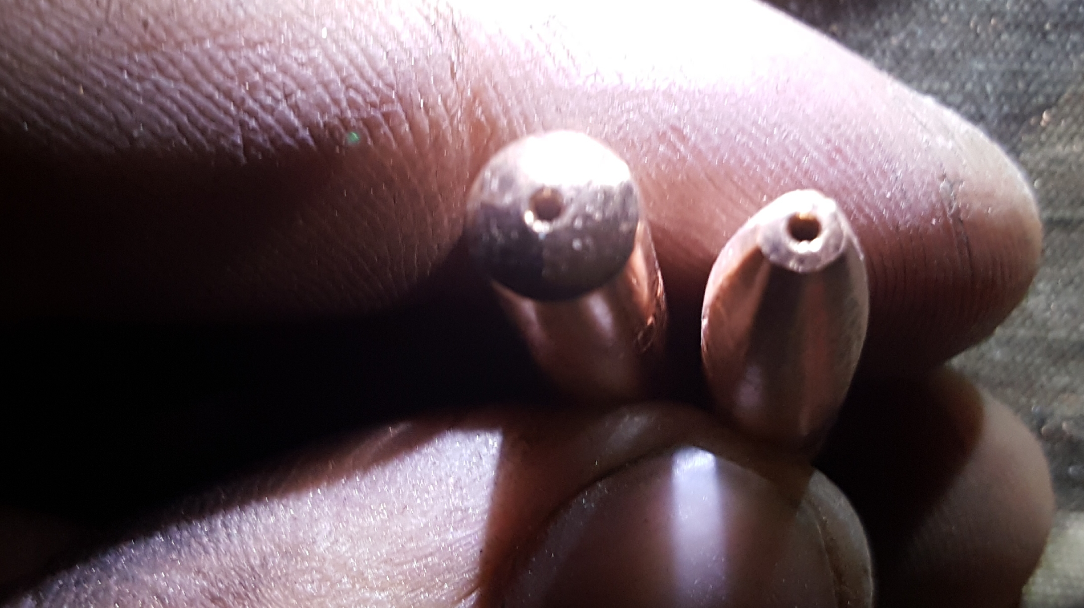

Here's a vid of testing different psi to burners i went with the .035 mig tips and was able to get a bigger flame. Still plan on making ports a bit more wide but its working alot better than it was. Vid of different psi test. 20180516_155644.mp4 -

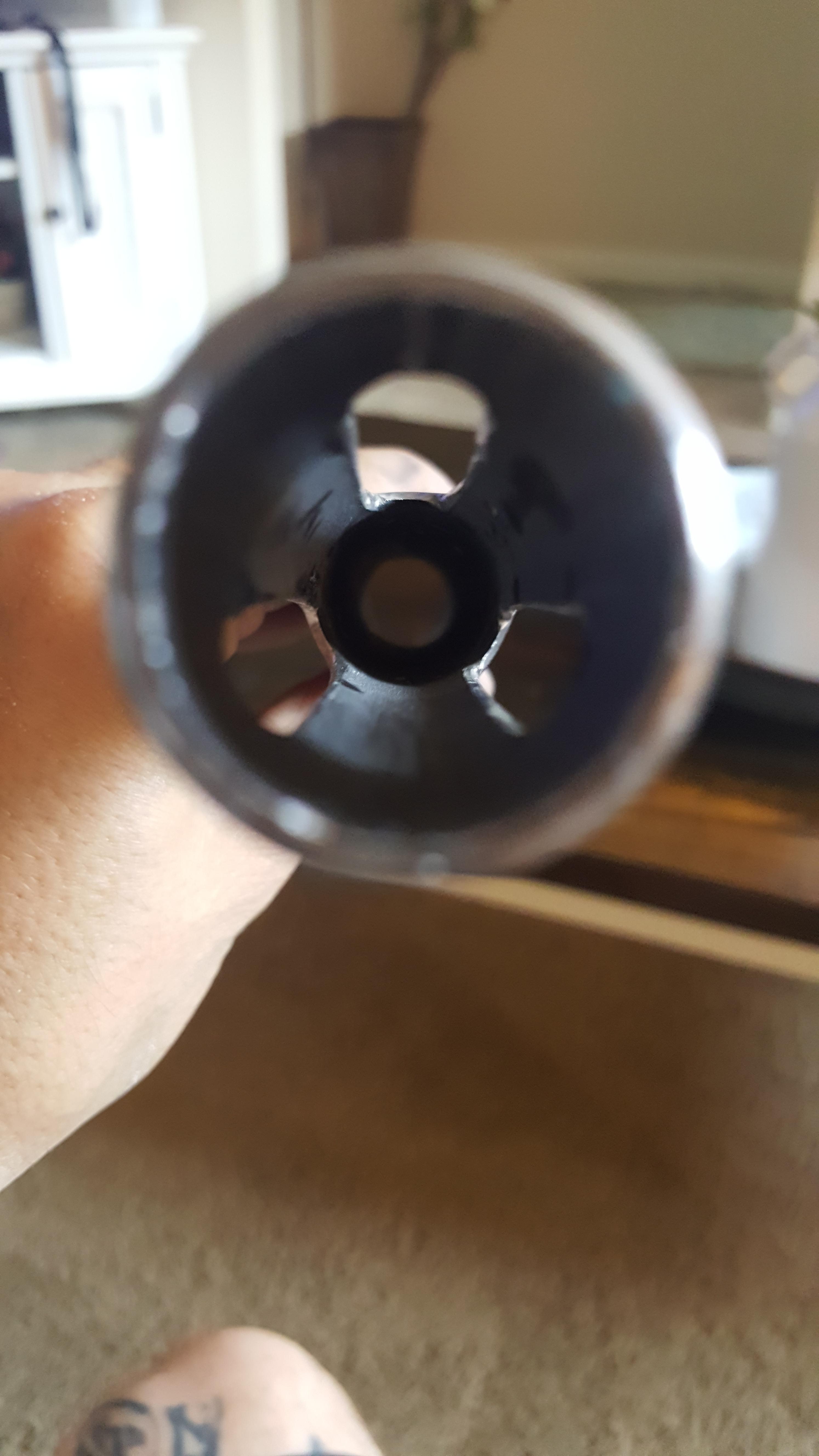

There being cut already to slots but will post when done should be able to do some test burns today as well. Here they are thus far still smoothing out and make a knife edge on bottom of intake slots. -
Thanks for the burner breakdown just got back from lowes with some .035 hobart mig tips and some cutting disk as to cut out my intake slots. I will bevel them and get them smooth. I did some measuring to clear some things up of what i got to work with Mixing tube is 10 inches 3 of that being holes already drilled in so slots will be 3 inches to start with. Its 3/4 inch ID. The flare is 1/4 thick x 4 inch long and inside diamater of flare portions goes to 1.1/4 inch. The accelerated nozzle is just over 5 inches but have a set screw to adjust depth in burner tube -
