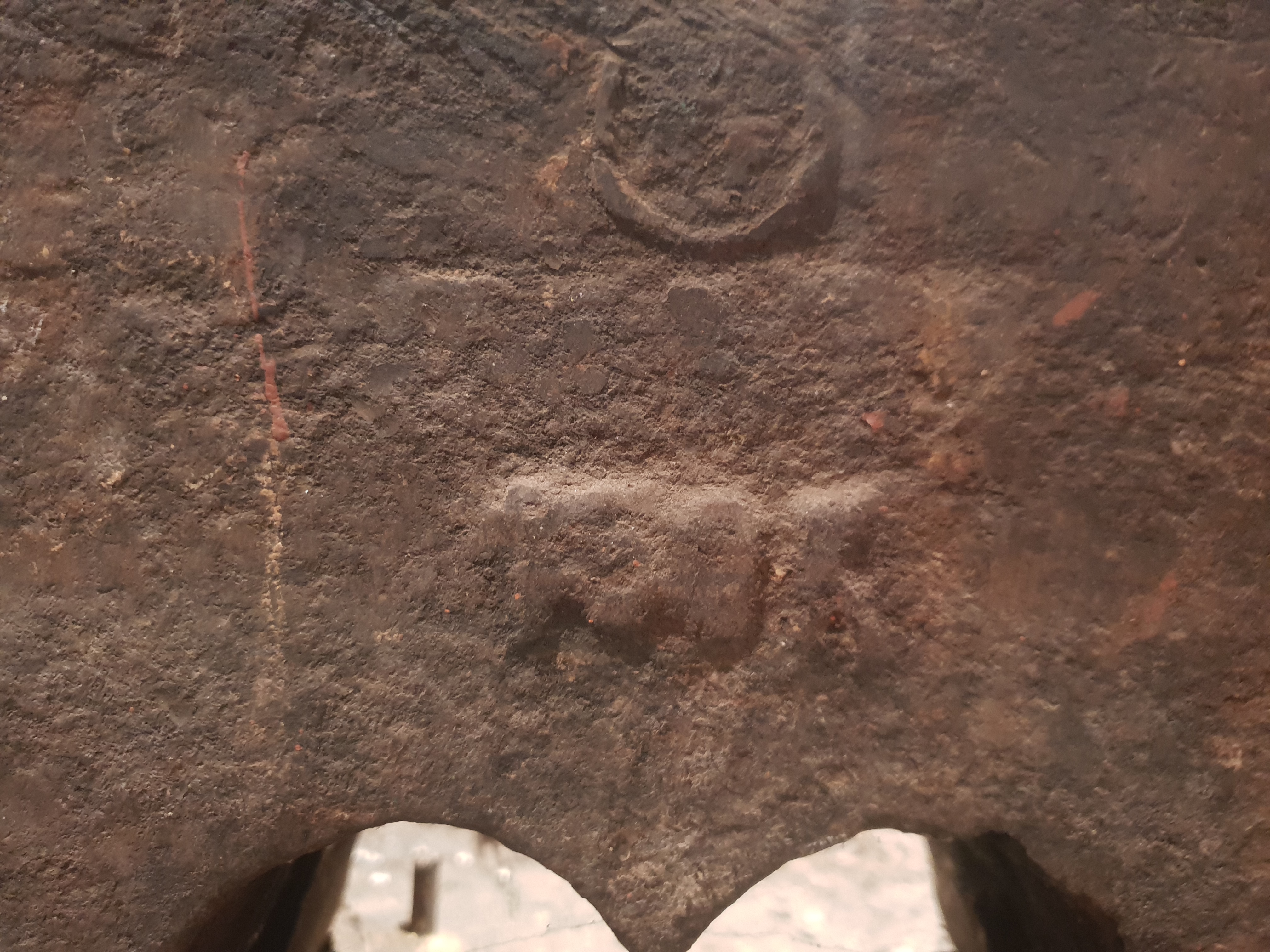

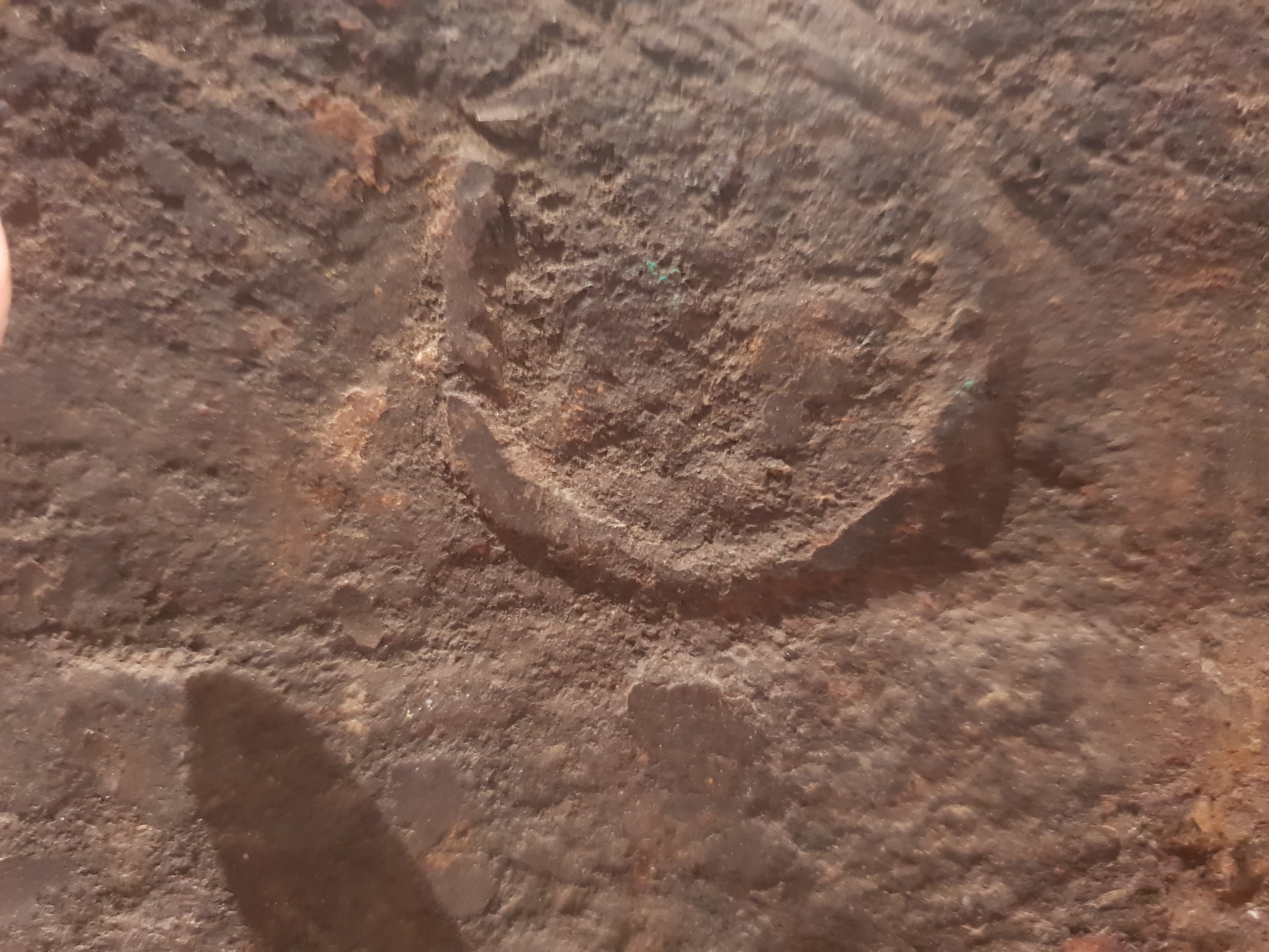

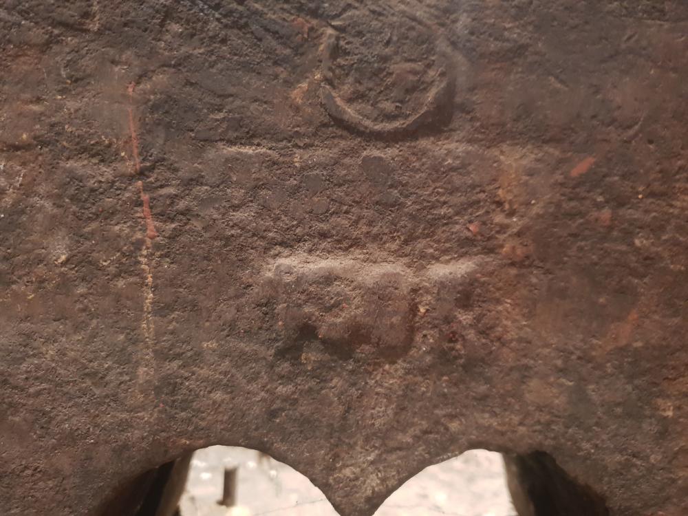

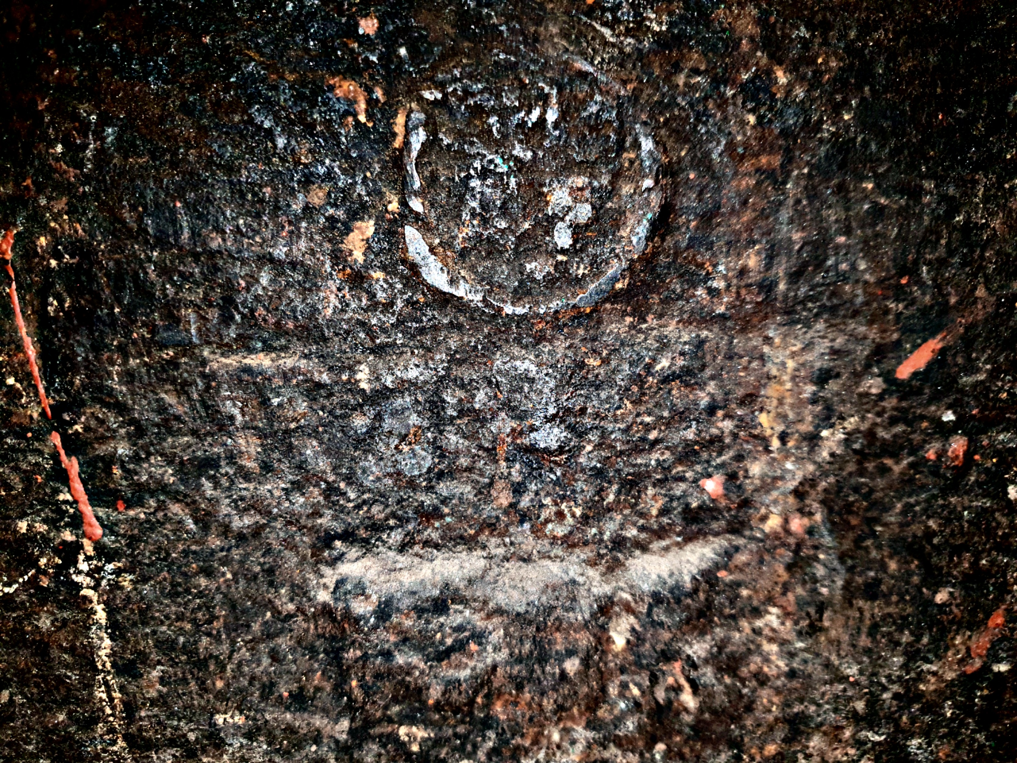

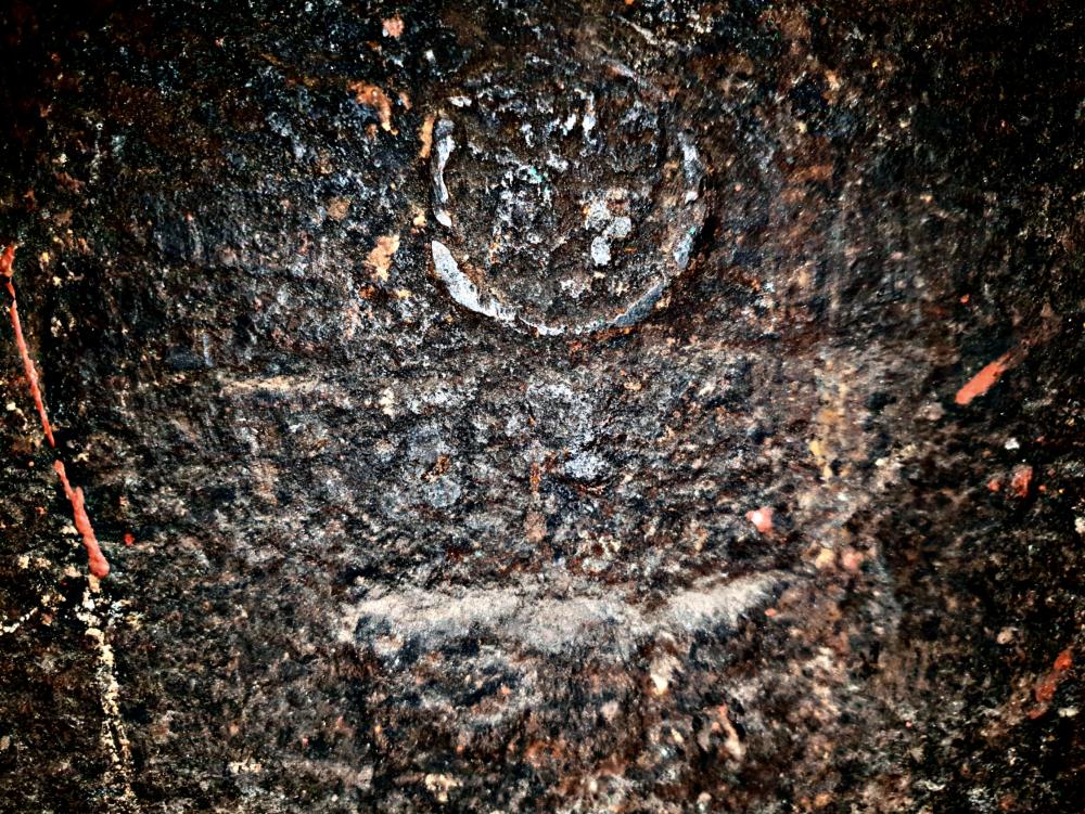

  6. Well from what I found, I'm thinking. Marking is UAF, made by Société des Usines et Aciéries de Feignies in Northern France, formerly Sambre et Meuse until merger in 1942.

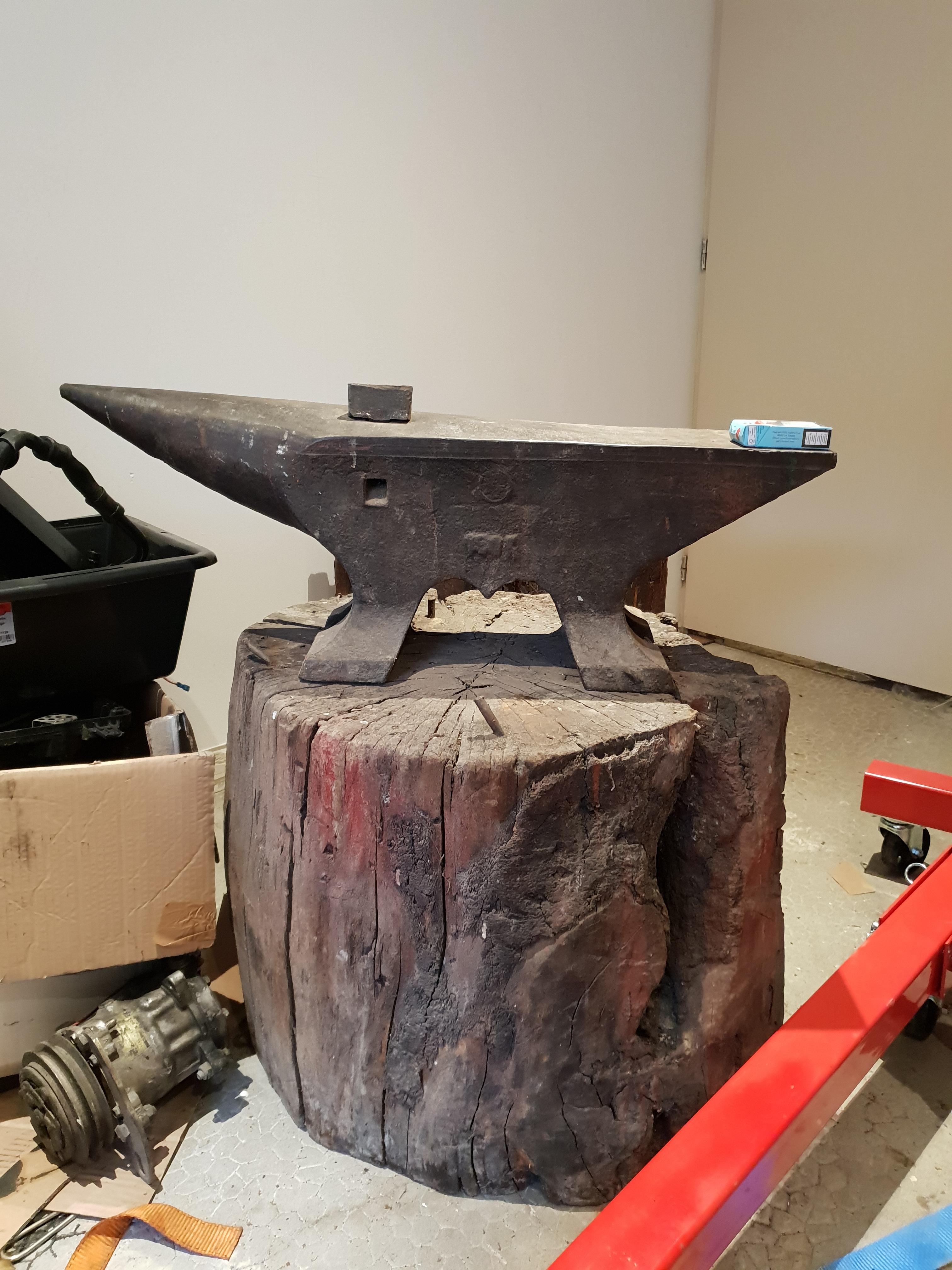

  7. Hey just picked this up the other day, it's a 4 foot, body is cast with a hardened face, 135kg, 85cm length. I can't really make out the markings, other than the weight. Looks like maybe an "A F" in the bottom portion of the circle mark. Definitely something between that and the weight too. If anyone has encountered one like this or has any info please chime in! Thanks!
