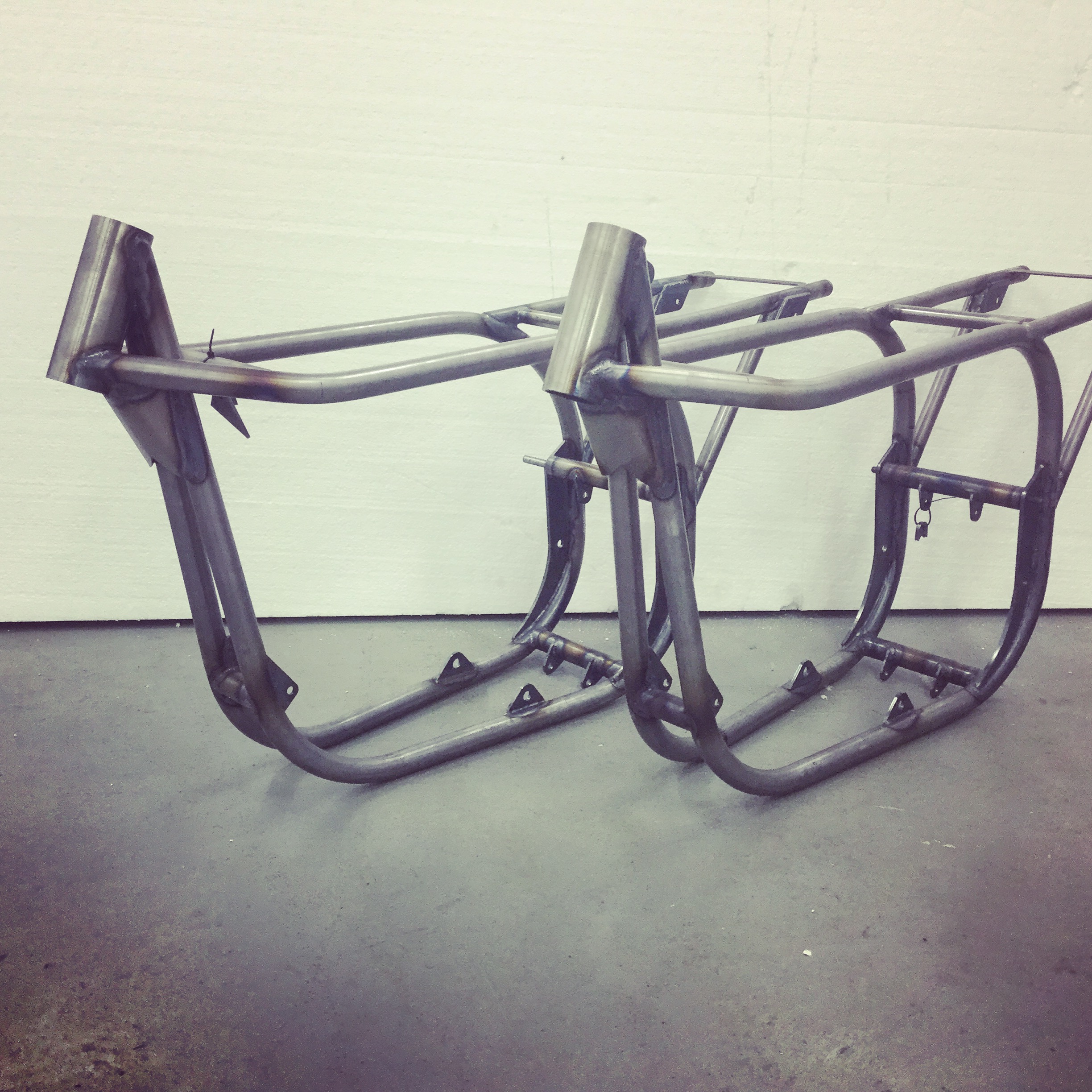

Not a certified welder but I can weld I build norton bike frames for a living, I know it has to be stronger than a bike frame I'll manage ok cheers.- Hydraulic press
