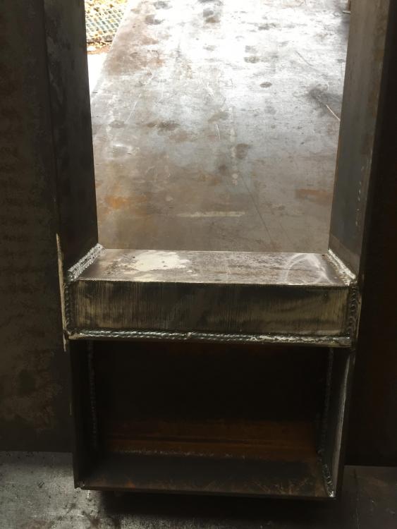

  10. Well got a bit more done on my press almost done the frame and ram parts tig weld first to get a good bite then 2 passes with the mig welder Should be enough to hold it I can’t see it going anywhere should only have about 24 ton should have it painted before the end of the week

  12. Well ive started my build 8”x5” h girders still waiting for the laser cutting should have all the main welding done today i think I’ll do three welds on all the 20mm parts that should hold it together It Will add a 20 mm top plate and underneath the top H girder there will be a 60mm striking anvil block should be very strong
