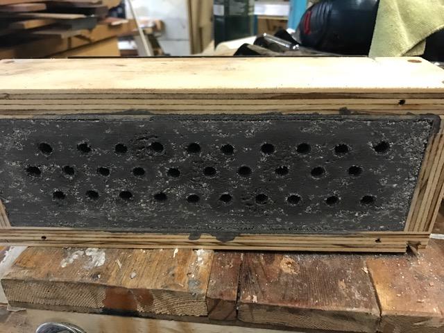

Burner mounted and test run. Air adjustment is a bit touchy. I'll be scouting for for a 1 1/4 inch gate valve to allow a bit finer adjustments. I currently have a blast gate over the blower intake but that is a bit crude. I was able to easily produce reducing, neutral and oxidizing flame fronts, though because of the air adjustment, the oxidizing flame was a bit unstable. Had to shut it off after 3 minutes as the structure started glowing a bit. Lol. Burner body had no leaks and stayed cool to the touch. So far so good. Your comment made me look at it a little closer. The end of the pipe WAS touching the baffle. I think it affected the lower settings. I shortened the threaded section and added holes around the edge to make the tube part of the baffle system. After that modification I was able to get flames about half an inch long. Prior to that, at lower pressures the ports furthest out would not fire properly. Thanks for the thought Wayne. Checking the baffle clearance definitely helped.

Wall thickness is 5/16. So a bit more threads than it appears. Test fire showed no leaks or issues at join.

Finished the burner. Following John Emmerling's path with a couple of exceptions. Instead of using crayons, I used lag bolts that I was able to remove after the refractory had set. I didn't like the idea of drilling out the crayons. Also I thought the spiral left by the lag thread might aid in mixing. Additionally I chose to thread the fuel pipe in to the burner instead of welding it on just because I had the appropriate sized pipe tap available. The excess plywood at the end of the burner form was so I could mount my orbital sander to the form tto vibrate the concrete and get rid of any air bubble easily (that worked great), I am now working on the plumbing for the air and gas. I will have pics of my test fire soon. In the mean time here are pics of the burner. They are out of order but I'm pretty sure y'all can figure it out...
