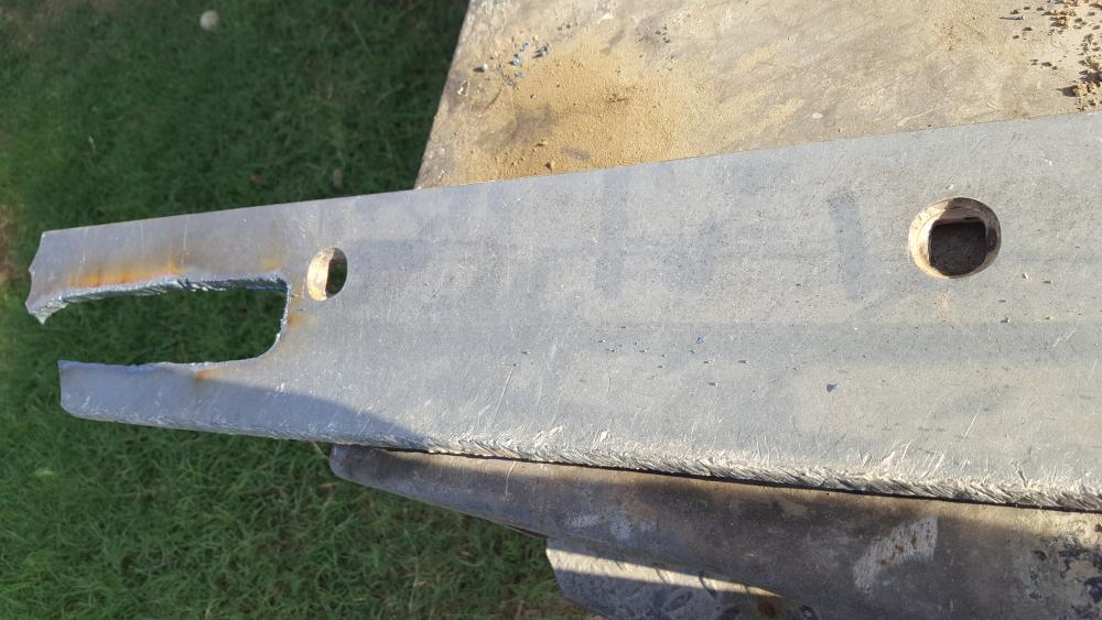

  5. I have a friend that can get all the cutting edges I want from motor grader and bulldozers. Does anyone know if they will make blade steel.
