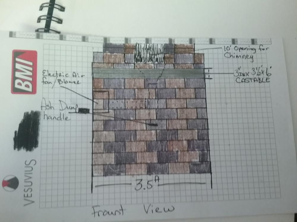

  9. Brick for the most part ,so are you saying to build it the same general way.I do realize you are given me help.And I am sure by everyone's redirection to previous posts or archives is an easy way to blow off someone who is just getting started. Wichita is understandable who wants to answer the same ridiculous questions over and over again. I mean I get it. These are some sketches I have made to give everyone an idea of my plan and to feel free to comment on or suggest and changes in in what I already have in my head. Top view will be posted soon and the table height from the floor to the top of the table is 31in. Thanks for your valuable comments and suggestions it is appreciated.
  10. This is what I thought would be best for my smithy or at least something similar. I have pot dimensions and I think a side draft would be my best option size wise not huge but the one pictured is in my opinion perfect. What do you think about a brick table or castable I am unsure because bricks may shift or heave but castable may crack but can be patched pretty easily.
  11. 2Yep and I have a pretty good idea on what I'm looking for . trying to figure out what type of hood will be best.I want the hot pot to be 10inx12inx3.75in ,table size 3.5ftx4.5ft.trying to decide whether Wether to use castable for this or fire brick. Also trying to figure out if I could use carbon brick for the pot.I have 220lbs.of Vesuvius brand Criterion65 high aluminum content ,55lbs of Dry Pack Grout 088b50its a non shrink structural grout refractory and No.200 Volclay about 55lbs,all the hard fire brick I can handle and carbon based brick for lining and blast furnace which is the working surface. Not to mention 15/20 yards of lump coal from Pennsylvania. So he'll yea I want to build a permanent forge . Wouldn't you if it was all freeeeeeeeeee?
