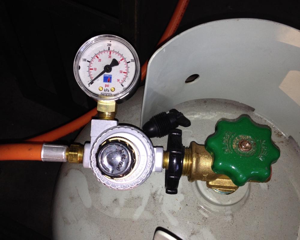

  13. Dunk_c replied to Dunk_c's topic in Gas Forges
    Just an update: New picture showing gas valve extension tube added to reduce temperature of the valve (as suggested, it worked). Also showing refurbished bernzomatic mini forge, now on refractory board with proper torch holder (previously used too much wood in build, that eventually turned to charcoal!). Using a cheap eBay thermocouple, the chamber tempersture only reaches 850-900 Celcius (steel is bright orange to my eye at 7psi) but I was able to straighten out a Pandrol-type rail clip with a large hammer. Might try higher psi to see if temp will rise. Forearm injured from long-screwing some timber so cannot get stuck into a project at the moment.

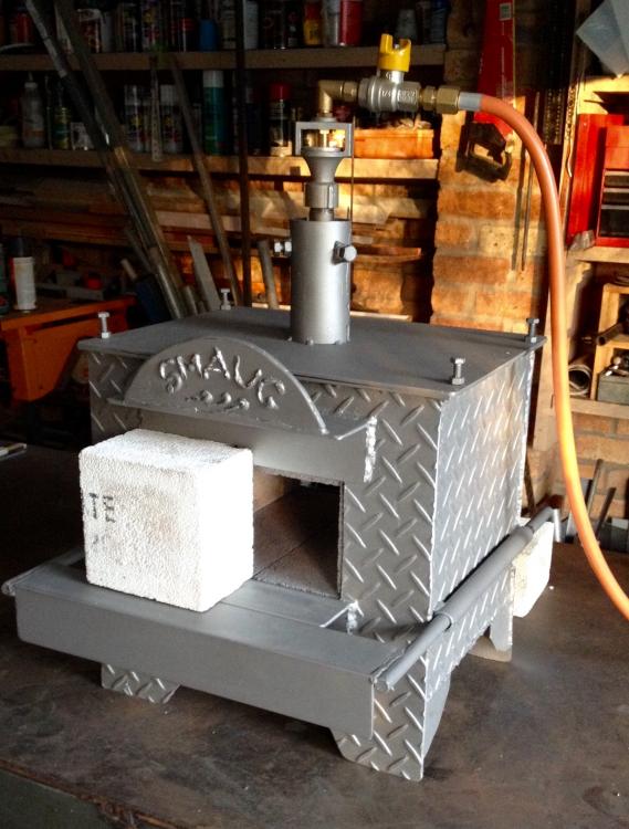

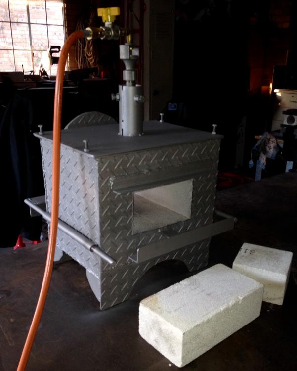

    Thanks MF. Goeje Avond ( Dutch wife!) I have the community to thank for many design features. I searched the net and picked up ideas from what people had shared online. The vertical burner configuration was one I found on some commercial sites (farriers forges for example) so thought there must be some merit (or more likely economy of manufacture). I had read about he chimney effect also. Wrapping a kitchen fire blanket around the top vertainly protected the valve from the head radiating from the top of the burner with choke closed off. I think I may have to get an extension to move the valve away. The burner designer tells me he had not inte ded it for this tupe of configuration but it certainly seems to work quite well.
  21. Dunk_c replied to Dunk_c's topic in Gas Forges
    Thanks for the suggestions. If the heat is getting to the valve by conduction then presumably it would need quite a few inches of extension. If the heat is getting to the valve and tube by convection then presumably lagging would be a solution. Any ideas? - probably both play a part. Wish we had easy access to the refractory materials in small quantities here in Oz. Thanks for the nice comments. I tried to leave a 5mm brick edge all round but my plasma cutting skills let me down a bit on the backside. The checker plate is quite thin and during the first burn the heat escaping around the brick at the backdoor cause the metal to buckle; had to bend it back and add a piece of angle iron as a strengthener. The porch is to deflect heat away from the air intake and was also added after the firt run. So not so much planning as fault fixing! You may be right about the soft brick as my first micro forge cracked rather quickly. However, I drilled out the brick centres and the wall thickness was greatly reduced. Hopefully this will fair better, and I will not be forging every weekend for a while, so I could still get some mileage out of it. I chose bricks also because high temperature refractory board is either hard to find or too expensive. I would apply a lining but these items are also not readily available in OZ in small quantities. While I do not intend to do any welding, I do have a scrap sheet of stainless steel I was going to cut to shape as a floor just to protect the brick from heat, abrasion, but not particularly for borax. Would that be of any benefit?
  22. Dunk_c posted a topic in Gas Forges
    Hi my previous posts showed my old anvil and my first attempts at tool making. My reason for starting to learn blacksmithing was to make items that I cannot buy easily or at all. I don't have time for hobbies at the moment so this is all about gaining ability and skills, and items I need. Anyway, my first gas forge was made from two hollowed out soft kiln bricks and a bernzomatic propane torch and it worked very well. Size was a problem but I was able to make a few things but only just managed to make these anchors for a new building I need tied down to a wall. To make things a bit easier I needed s slightly bigger forge: Ibought a commercially available burner, soft kiln bricks (1400 C) and some ceramic fibreboard (1100 C). I knocked up this forge over the weekend from some scrap metal. I trialled the burner before finishing the design and was finally able to get a stable burn with wide open throttle and about 7psi, at lower pressure the flame front kept jumping to the forge floor. The forge volume is about 200 cubic inches and the burner has a 1/2" tube with a heavy duty flare. Not sure what nozzle aperture is. Here are some pictures for anyone interested.
