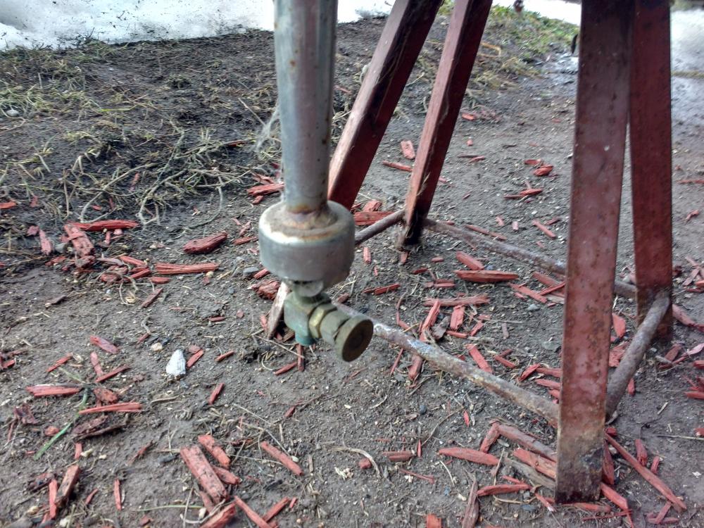

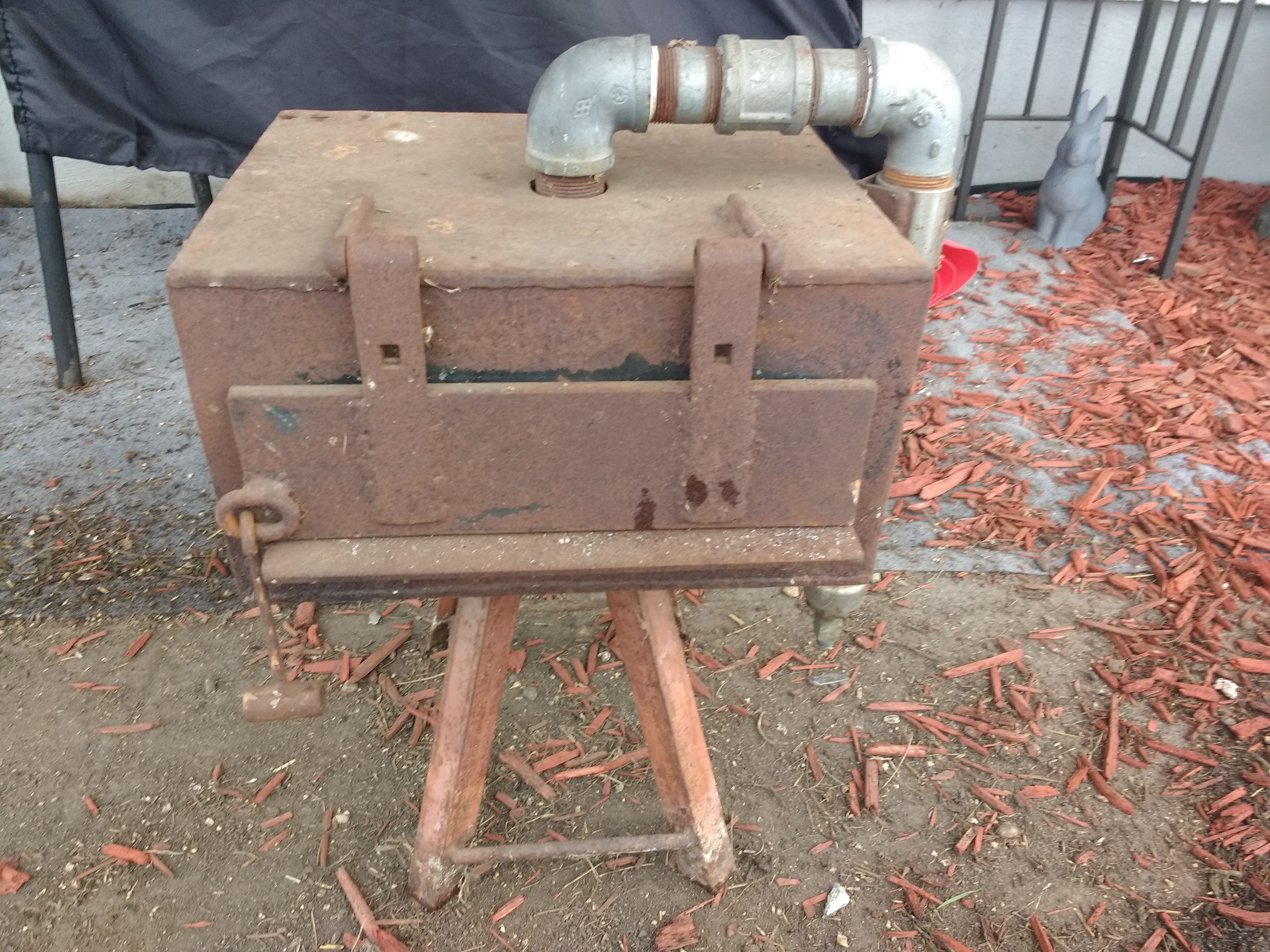

  21. Hey guys its me again I was givin this forge last night from a good friend who was a ferrier yrs ago it works like a hot dam fired right up let me know wat ya think I ain't done nothing in er yet but the flame looks good and it gotwarm real quick is wat I'm saying hahaha

  24. Thanks Frosty I really appreciate the 2 bits I've seen your name on here alot during my research haha you seem to really know your stuff and I'm glad she's good to go I have been doing a lot research on forges and while I was a friends house tonight I was given a gas forge as he was a farrier yrs back I'm so excited to get er fired up tommaro and see wat I can create haha if you are interested I can post a pic tommaro i have bin incredibly lucky getting started other than the rum and the courses I've taken its bin a free startup!! Thanks frosty
