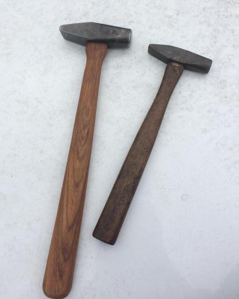

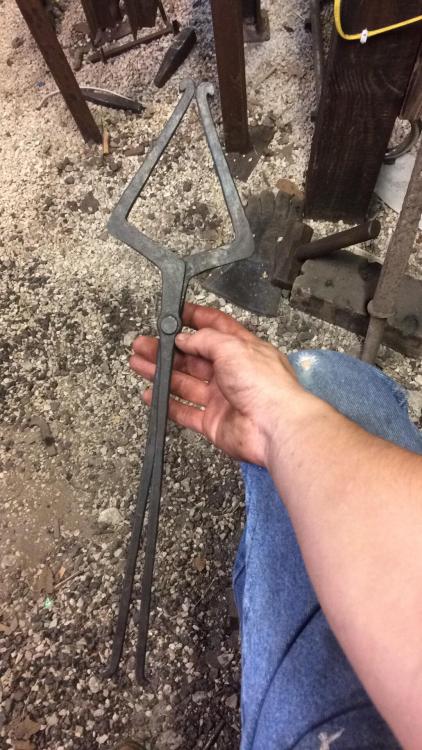

  1. Yes. Smart man. Got it a bit of time, forged pair of 1/2” v bit tongs and my first ball pein, what I’d consider to be a proper ball pein, with the eye punched in the center and so equal weight faces, what I find to be the logical way of doing it, haven’t figured out the reasoning of having an un balanced head.

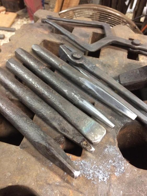

  3. Didn’t get as much done as I’d like to have, got up late and ended up not starting till after lunch. Made a couple eye punches, round punch, slot punch, and fuller, cupping tool, flat jaw tongs, and hammer tongs. Also got to finish the legs for a coffee table which I’m excited about.

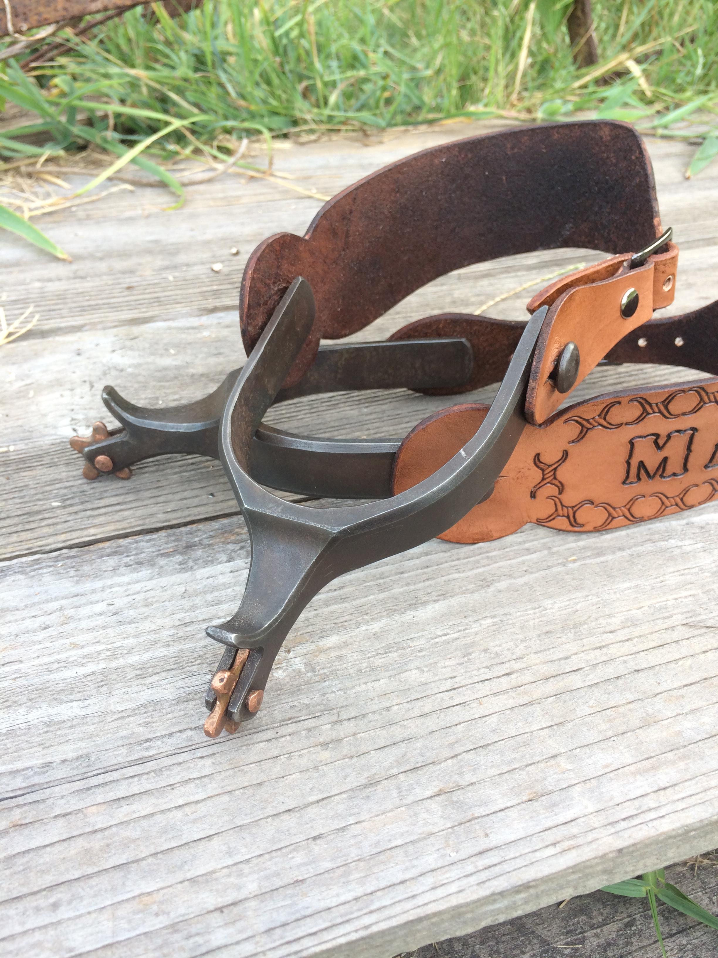

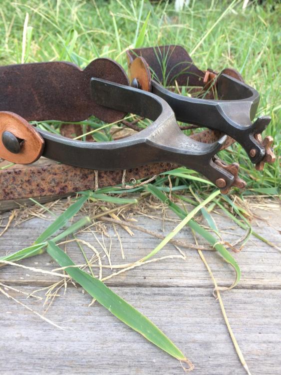

  4. Here’s another set I did this past summer. Did all the leatherwork too.

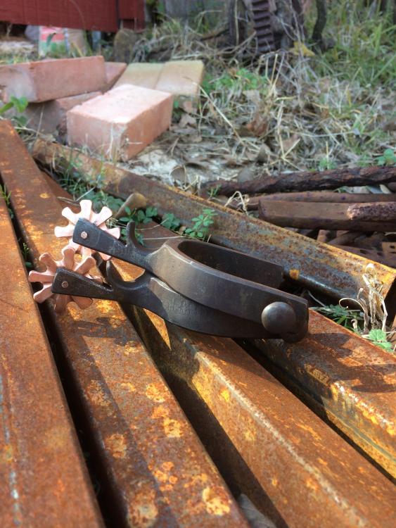

  5. Thank you. Yes the rowel is copper, cut a sliver off the end of a 1-1/2” round copper bar, and filled to shape.

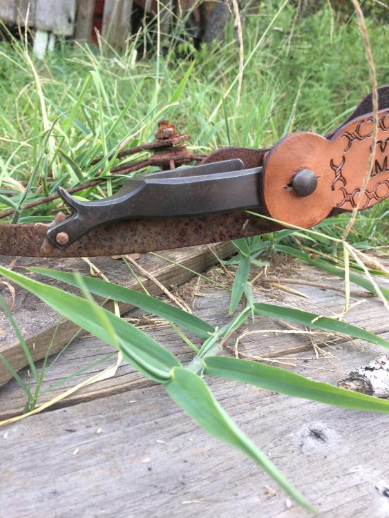

  6. Forged a pair of spurs. One piece spurs, forged from 1” square. Included a picture of them part way through, gives an idea of the isolation of material done with butchers.

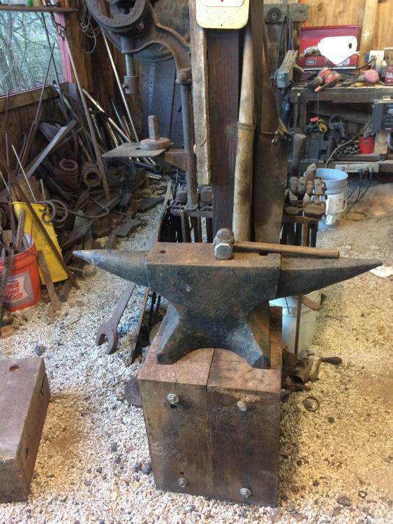

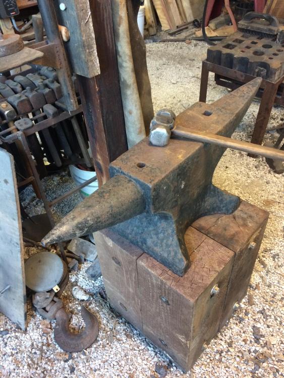

  14. 283lb English double horn anvil. Paid $900. Won’t probly get used for other than a cooling rack, just too big of an anvil, but I still like it.

  17. Hey guys...been a while since I’ve posted. Lots has happened since the last post a year ago or so. Anyways. Picked up this anvil the other night, probly won’t use it much but at $900 I figured I’d pick it up. Weights 283lbs, the only marking I can see is the stone weight and maybe part of a U? It’s pretty pitted, and didn’t know of maybe one of y’all would have an idea on the maker. Also included a comparison of it sitting next to my 170 or 180lb (don’t remember) Keen Cutter.

  22. Oh ok that may not be so bad I thought it was flush. Yeah it looks German I like the German style ones I want one.
