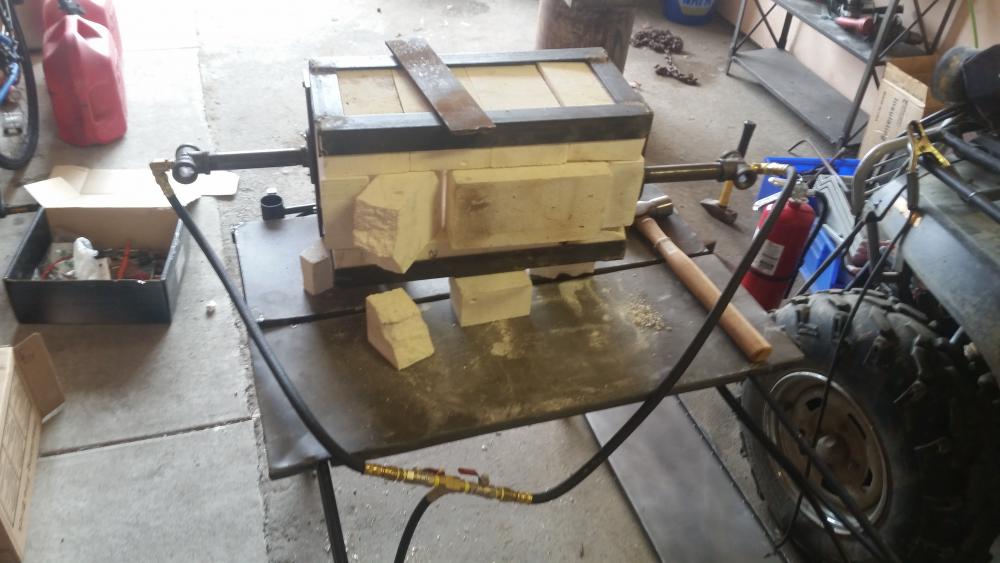

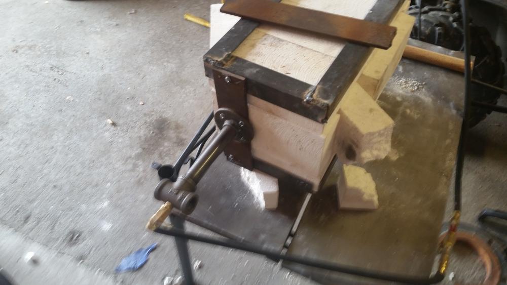

  21. New axe maker posted a topic in Gas Forges
    375cui inside diameter 2 3/4in frosty t burners Burners aren't fully tuned yet but they do run and the make the metal hot so they will work until I able to fully tune them. Not to sure how well they are burning at the moment but they do not chug it's a constant roar.
