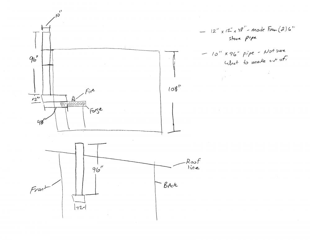

  13. So no grease cans around, everything is plastic. I was going to use the two 6" chimney pipes for the horizontal run, what are the thoughts on galvanized sheeting? Or using a 8" stove pipe already at the 8 foot run Heres the layout

  15. What can I make the horizontal tunnel out of? I see a bunch of ac ducts but they are galv steel. I was thinking to use the 6" pipe zipped together but I think that's the same size as vertical pipe. Sorry for the confusing dumb questions.
  16. Frosty thanks never thought ofof that . Anyone use 8" pipe successfully?
  17. Been looking at side draft design. I have some 8" pipe about 10 ft from a old stove. Can I use this with a 12" x12" x3 ft rectangle that would go by the fire. Will the 8" work??
  18. I wanted to put this in a post I had already started, but the forbidden bug got really old. So here goes, I wanted to build my blacksmith building over the old chicken run. I started my building this weekend. The actual dimensions are 7.5ft by 12ft. The old chicken run was a little smaller than I thought! So my question is how far from the wall can I put the forge? The body of the forge is 26”x26”. I was thinking about 6” from the wall on all sides. I would like to run the chimney up the side and exit at the roof peak. What is the average distance from the forge to the anvil and vise? I was thinking 1 step to anvil and 1.5 steps to the vise? Do I need to side the barn in metal or can I use wood siding? What is the easiest way to make a hood? I currently have 8” chimney pipe that is 6 ft in length and two section of unzipped 6” pipe that I was going to try and make the hood. Thanks
