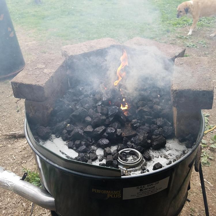

  2. I just now put my forge up just going to have to add wheels to help move it. I'm planning on doing more once it quits raining.
  3. I fired it up Wednesday afternoon and took a peice of rebar and bent it to form a coal rake. Since it has been raining since I haven't been out there yet again. I have learned one lesson and that's not to have it near a 3 sided building due to the smoke.

  6. My brother-in- law has one but with no truck its hard to move the forge and he's 2 hrs away from me and he won't meet half way nor bring the welder to me. I may check with someone at church who may have one I'm not sure how much stuff he does have as he keeps buying and selling it all even if its just for a one-time project.
  7. The holes are 5/16 and 1/4 inch drilled thru some cutouts I had here. I have plenty of brick here is that just the regular red brick used for brick houses? I don't have access to a welder so I went with the plates. The five holes barely move a sheet of printer paper when held 18 inches above the lip of the forge.
  8. So I finally got it finished and have 25 lbs of Bituminous coal on its way.
  9. I'm planning on small projects i.e knives, and repair of my farm tools. The lip is a 2.5 inch lip added and yesterday I added a steel plate to keep the coal in and not falling down the blower tube, drilled holes 15/32 for air flow.

  11. So I started yesterday on my one forge, I had planned on working on it some today but I woke up to 2 inches of snow on the ground and a arctic wind blast. I have included a photo of what I have done so far which isn't much, as I have to put the blower system together and find a source for some coal. All I did was cut the hole and it was a bit tight but just a tap of a hammer and it went in.
