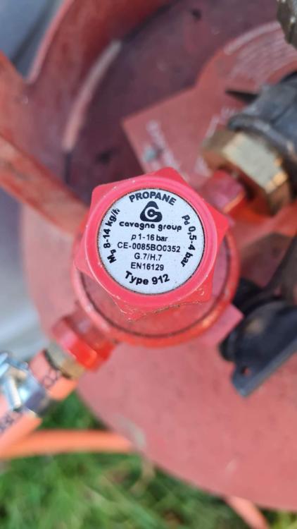

  2. First question: what are the gas jets in your current burners? Are they drilled holes, or can you swap them for smaller ones (many burner designs use MIG welder tips as gas jets)? - Yup mig tips, will check the size. Second question: Where in the UK are you? It's not very likely, admittedly, but there may be someone fairly local who can help get your current burners running better. Newport, Wales - just over the bridge from Bristol Amal - I am looking at these actually as you're the 3rd person to recommend them! Attaching a pic of my reg - What do you think? Should I get a better one? When you say welding ones, do you mean mig/argon
