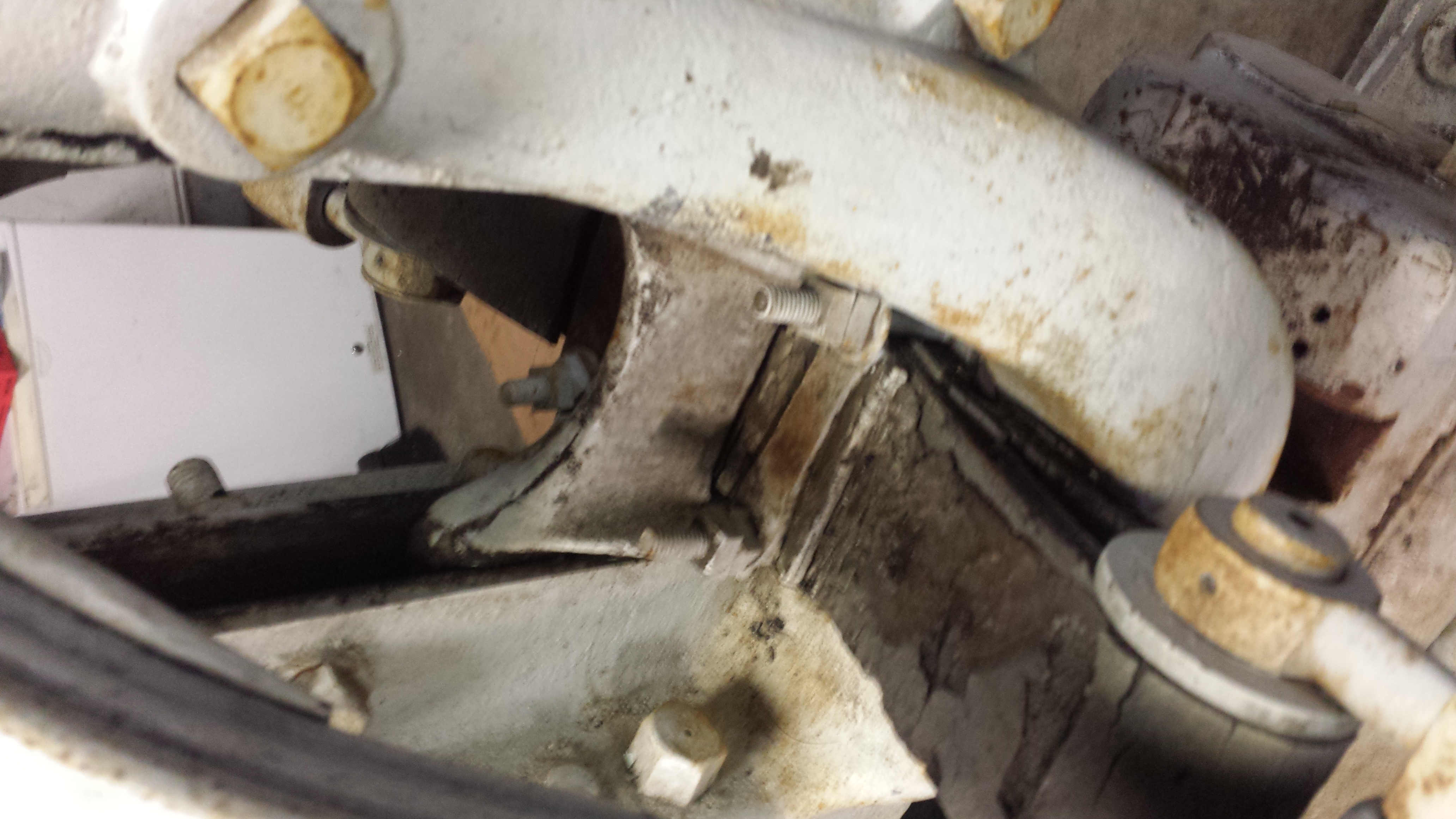

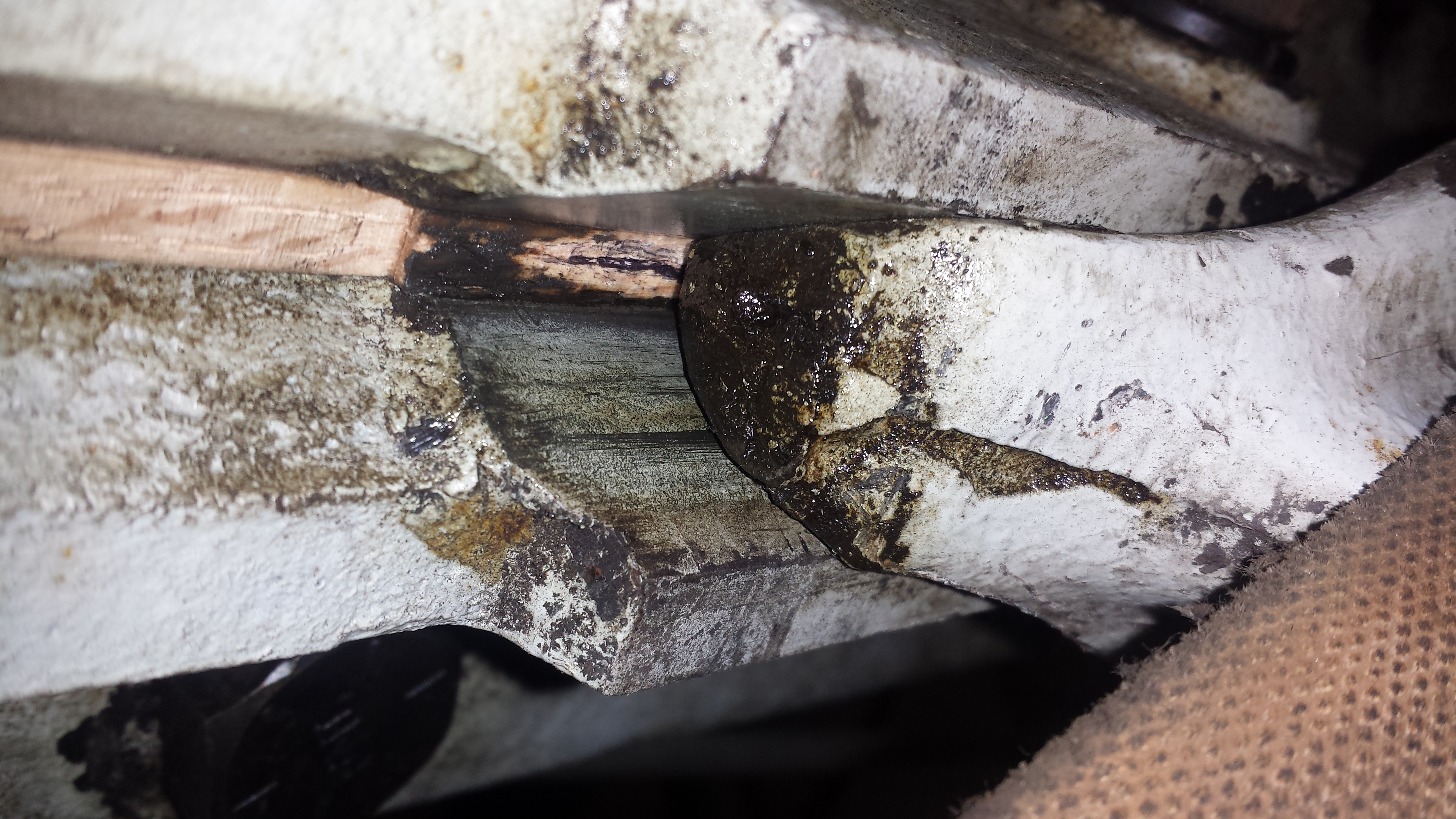

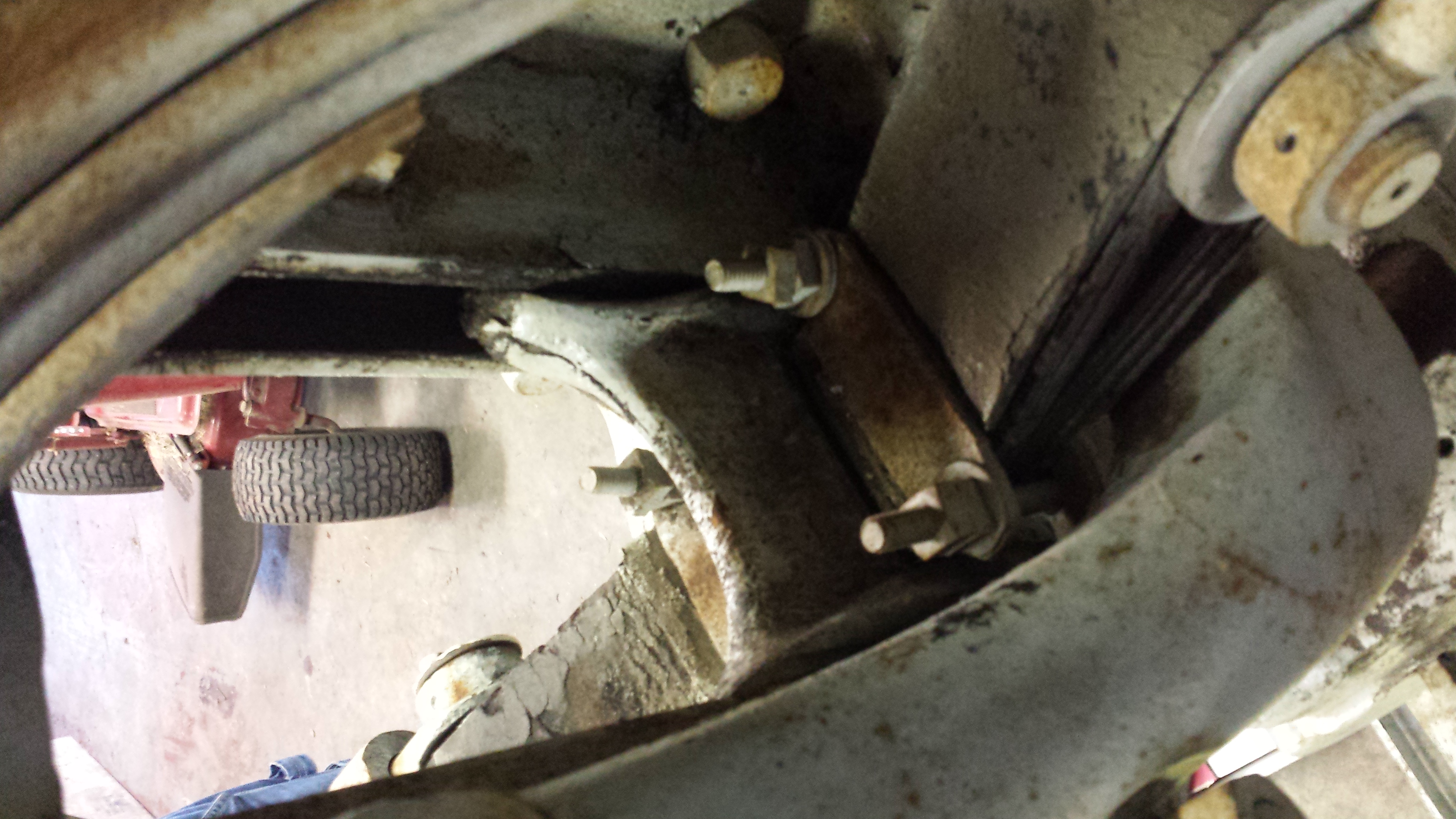

  2. Pics are as follow, first is the rear guides at BDC approx .085 play. Next is front guides approx .030 play. Final is rear guides at TDC .050 play. Its hard to see but on the left side of the tup it is visibly worn. Front looks good. Im not sure shimming less would help in the back unless I shimed in between the frame and the guide as well to angle it in. Let me know what yoy think.
  3. Judson, removing existing material is not a option im in favor of. There are shims between the front and back guides on the frame. Due to how the guide is mounted to the frame i fear I have taken all the slack out I can with the shims. I know with the front shims I shimed until it stopped binding. The back are the loosest ones at I'm going tk approximate at .075 with my measurements. I was under the impression with the tensioner on the shackles of the spring is how I tightened the belt. I may have to re wrap with the eyebolt nuts as loose as they go but unless I have concrete instructions that

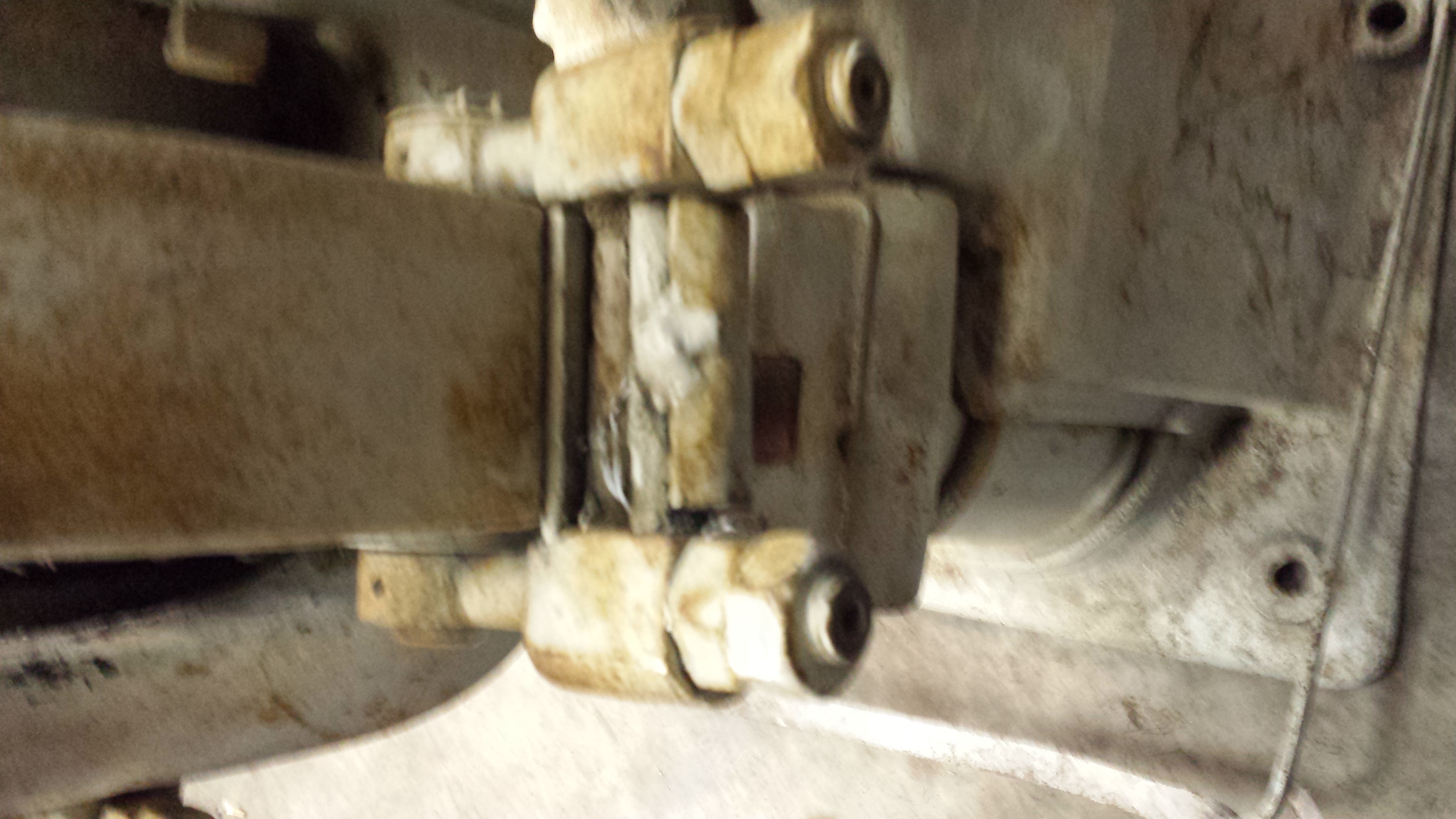

  4. Where would I find said patents? And for what brand should I look for?
  5. I am afraid to have the tup repaired since it is cast. It would have to be built up with weldment and machined back down. On the left side of the rear slide on the tup it is visibly worn down. How much play am I allowed to have?

  7. Black frog, I moved the clamps out to stop them from rubbing against the ram. It was causing a lot of ware on the head. Also do you know how much play I'm allow in the ram guides? Either I'm holding my steel wrong or my ram is floping enough to cause my steel to diamond. I've eliminated as much play as possible, my only other option is to pull the ram and have the slides built back up and machined down. Unless yall have another idea.
