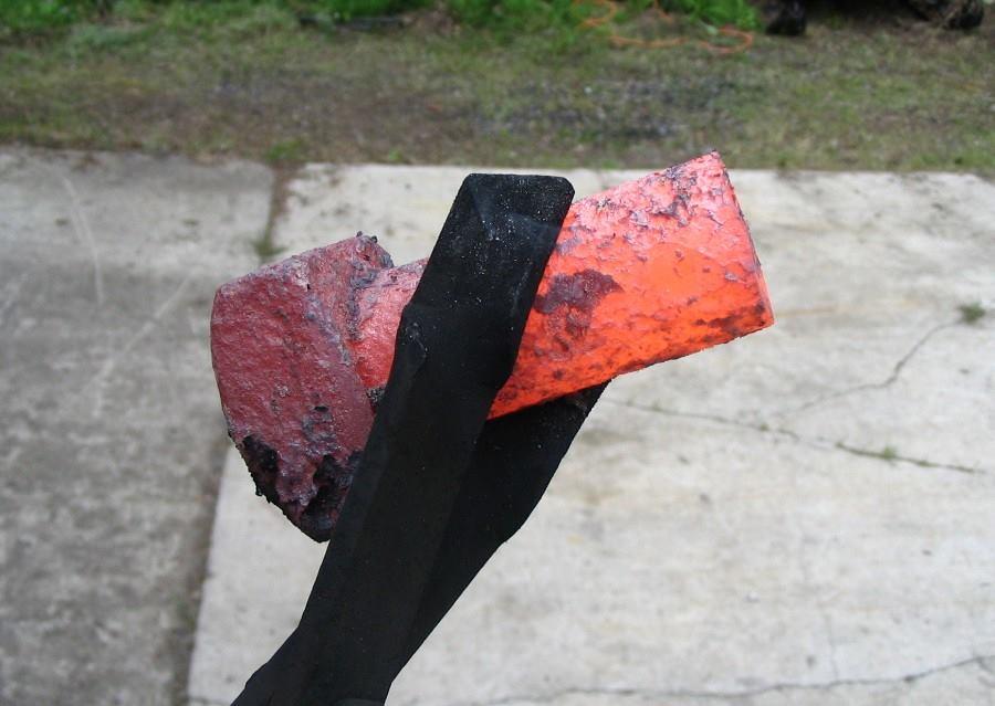

  6. Welcome AKNewbie: I built a post anvil from a 3" steel pipe, a Toyota rim and a 1" steel top and it works well. The 3" pipe fits into the rim center hole and the 1" top had a 1" hole it. I used it to compensate for the missing hardy on my anvil. It holds my cut off tool and my mandril, both are homemade. Once you have a forge, you make the tools you need, usually as you need them: tongs, hammers and forge coal tools. My forge is coal fueled with a blower from a dryer and plans f rom a book by Randy McDaniels. The book also has plans for a welded anvil that looks like it would work. The pictures I'm sending shows a 1" bridge bolt. I got it that red hot in 3 minutes. I drifted a hole for a handle and I use it as a flatter . You don't hammer with it, you hit it to flatten things. The bolt was 18" long and I made a hammer and mandril from it. Now that I have a heat source, I melt aluminum and glass it it. It is all new to me and is very exciting and great fun even the mistakes and outright failures. My fellow blacksmith burt a 1" hole in a lawn mower blade he was going to make into a knife. He had a gas forge and was not used to the rapid heating of a coal forge. I'm JUST STARTING to melt aluminum. Good luck, it's non-stop fun. John on Fishhook
