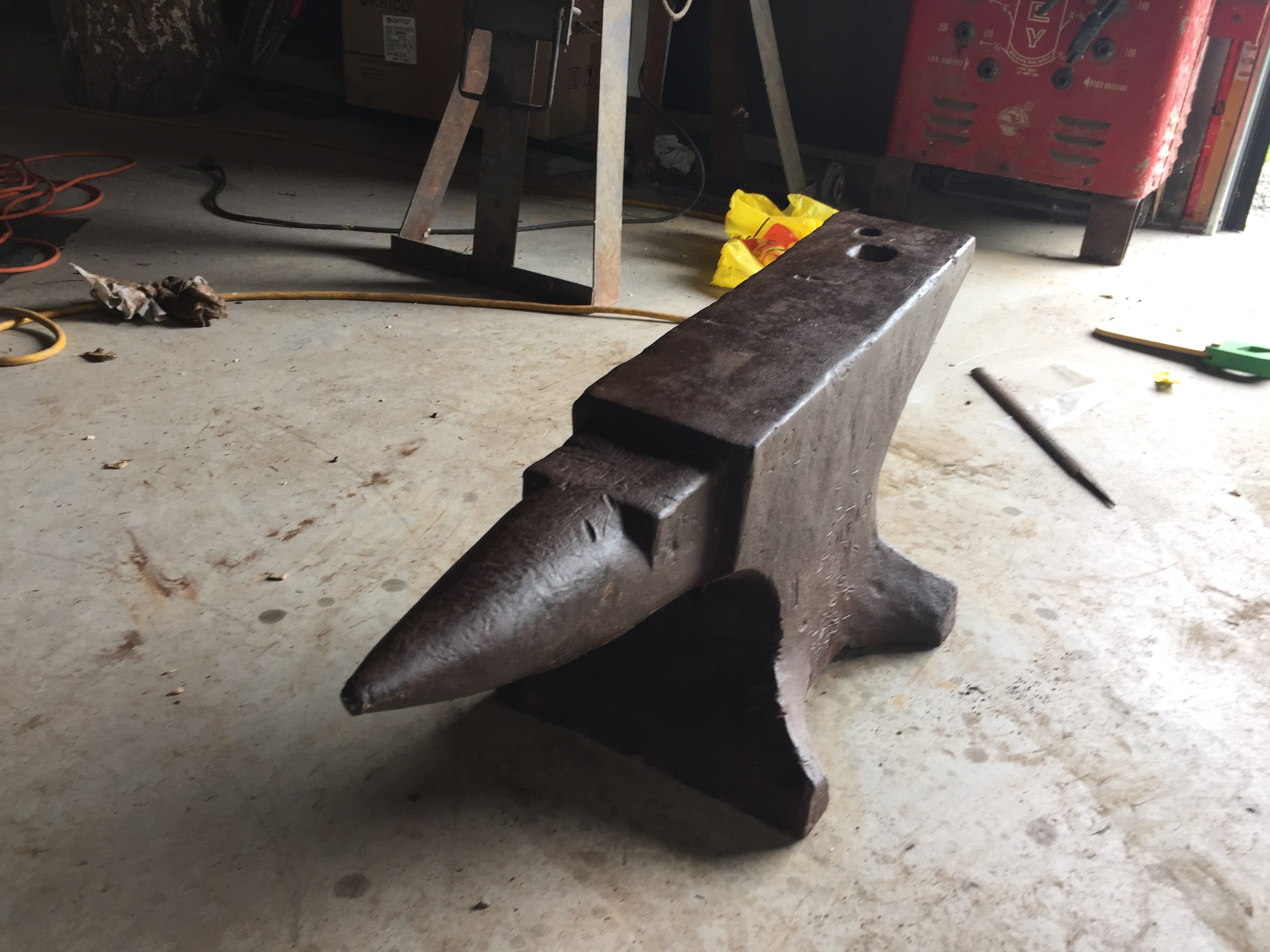

  4. Hi Guys, Just looking fort some straight up opinions. I have an opportunity to buy a new style LG 50# mechanical hammer for $4500 CAD or potentially a Blu Max 110# for $4000 CAD. Both appear to be in pretty good shape. the blu max is only 7 years old with apparently light use. I already have a 5HP Ingersoll compressor to run the Blu off of and obviously I don't need it for the LG. Just curious to get your thoughts on which to bite on..

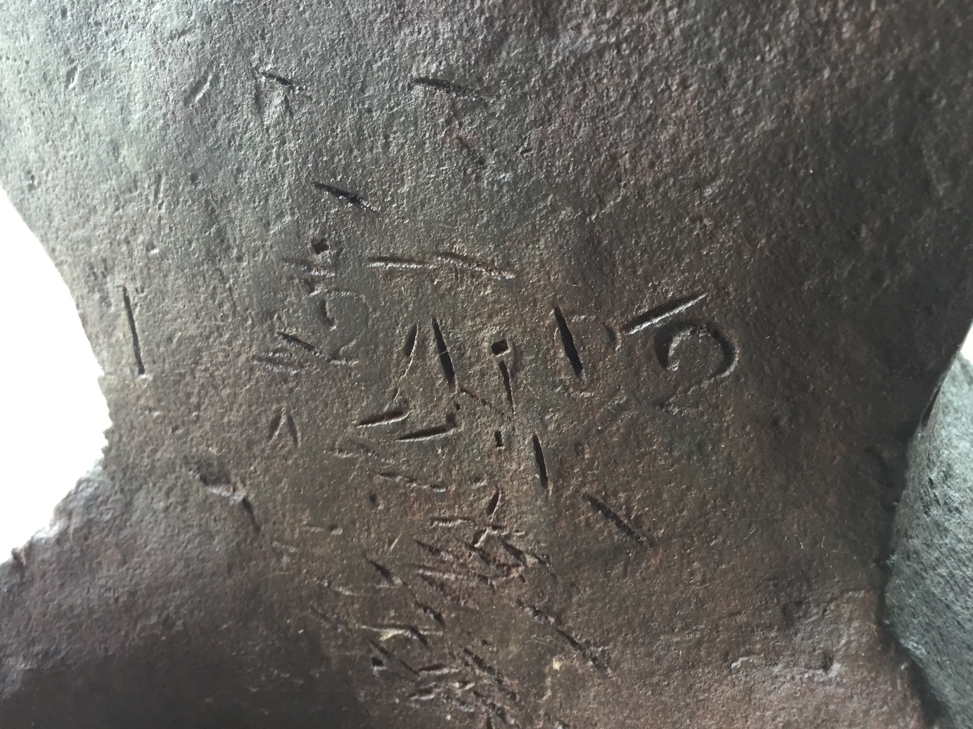

  7. Hi Guys, I just picked up this anvil from a yardsale junkie friend of mine. i agreed to the purchase based on a cell phone photo and conversation with him. Overall it looks to be in pretty good shape. The edges are in decent shape, the horn is not drooping and it still rings like xxxx. My question is this: i notice that the whole anvil face is sloped from heel to horn.. apx 2in difference in height. Have any of you seen this before in an anvil? my plan was to shim the low side when I mount it but is there a reason to leave it tapered? Also I notice that one foot is out of plane by about 1/4in leaving the anvil to rock a bit. This can be easily shimmed but just wondering if this is common or a sign of poor manufacturing quality? Also can anyone take a guess at the manufacturer? it weighs in at 198# even but the markings on the side are hard to make out. it looks to be like 1-2-something 2.. although at 198# i would have expected 1-3-2 The name stamps are all but gone but I can sort of see a C up top and a WA lower down.. Any guesses? Thanks for any thoughts or advice!
