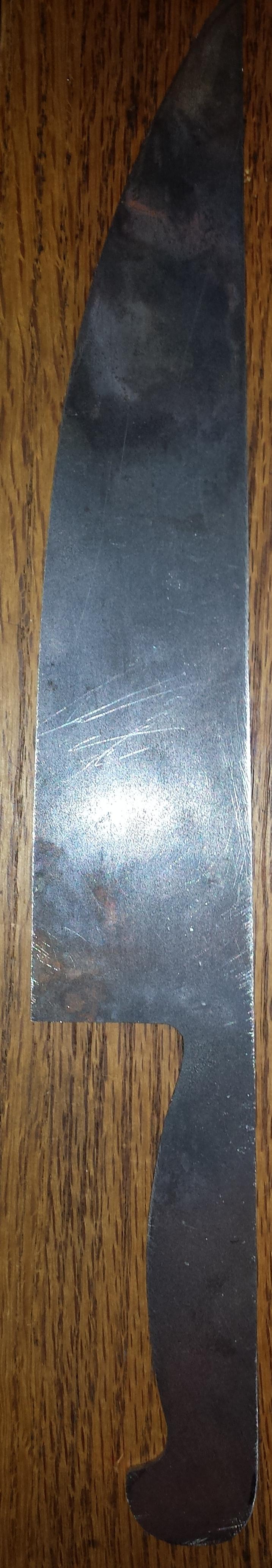

It could use a bit of work, though it is a bit deceiving. There is not really a flat spot. I checked on a flat surface and there is a rocking motion. However, there is a spot where it has much less curve that does not match the knife. And to confirm. Any company that sells HT service should be just fine for my purposes, correct? Again, thanks for all your inputs Graham.
Chef's knife help
Ok, I have taken a lot of time to do more research and I have asked my friend how he wants it, and he said flat grind from spine to edge, which seems to be a general consensus. That is what I will do then. On the note of heat treating and quenching. Clearly you all can tell that I have limited experience with those two subject matters. Since that is the case, maybe I ought to outsource those processes to a professional company? I thought about Tru Grit, (if I shouldn't be posting names of companies I'll remove it) or some other company. I figure that if a company touts their services as professional(namely, that they sell the service) then they must be able to do it well enough for most purposes. Any thoughts? I think I would rather spend 30-60$ on a service than to ruin several knives of steel that I can't properly handle without much practice.(from what I can tell it seems to be the thoughts of most experienced knifemakers anyway) The steel is AEB-L, So it is one of "those" steels. Thanks ya'll. Graham.
Chef's knife help
So full grind would be more tipical of a chef's knife. Does it boil down to the quench and heat-treat more than the grind? I guess if i want the edge to be super sharp I would want to make the edge hard but keep the spine and middle of the knife springy right?
Chef's knife help
Hey ya'll. Im working on a knife for a chef friend of mine. I have the shape finished and now I am wondering if I should do a partial grind or a full edge to spine grind. The knife is a smidge deeper than 2 inches and the thickness is .110 inches. He works in a professional setting but I still worry that if I make it a full grind there would be a possiblility that the knife could chip since the angle of the grind would be very low. Not sure what to think. I am working with files, not a belt grinder, so slower material removal.

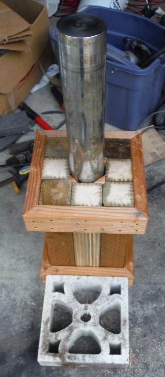

I am not sure what i should do to make myself a hardie hole for hardie tools. My anvil does not have a hardie hole since it is just a steel rod and the face is really too small to add a hole to it. I was thinking I could cut a hole into the wood stand and place some sheet steel over it so that it doesn't deform the wood. That's about the best I've come up with and getting a new anvil is not something I can do financially right now. I want to start making tools so that working the forge and making things becomes manageable. Here is a picture of the anvil and stand.
