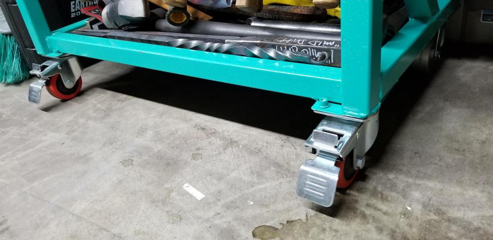

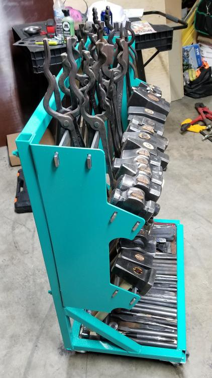

  2. Finally finished my tong and hammer rack. Sadly I still can't fit all of my hammers on it. But its sparkly and rolls smooth.

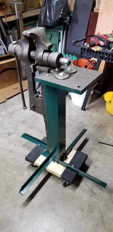

  4. Jlpservicesinc, the angle iron is going to be bolted to the floor. I am also planning to add extra bracing
  5. Good to know, I planned to use the current stand as is, until I need to replace it. Adding some bracing like you did, also look like a great idea.

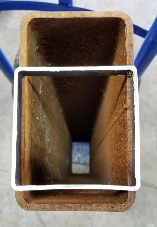

  6. Great work peeps! jlpservicesinc: I'm not too concerned about the angle iron legs- in that the upright support will likely give out first. I was just using what was available to me, without having to stop by a scrap yard or buy too much new material. The Angle iron is 1.5'' wide and .25'' thick material, it'll be bolted to the concrete once I find a location I like. A plate was definitely my preference, but I couldn't find one right away- still can't find one actually. However it's sounding like I'll already have to build a new stand asap. The 4 x 7 x .25 wall tube my co-worker gave me will be much better. I plan to use that once I source a plate for the base. Top plate is 1'' thick so I'll stick with that. Also would have to find someone to weld it together. Irondragon Forge & Clay: thanks for pointing that out. I cut a piece of tubing for it, and now realize it's not on there. I'll add that right away. This is the thin wall tubing I used, because it's all I had at the time. New stand will use this, with .25 wall. Same co worker also gave me some miscellaneous pieces of steel.
  7. haha Chicken tracks is a good one. Sorry, I should have mentioned. The dolley was to make moving the vise around the garage easier, it's only temporary just to move around not use. It's been raining, so I couldn't build the stand outside. It was easier to have the dolley, vs dragging it around. The screws were to keep it from sliding, just case I happen to run over a paper clip and snag the wheel or something. Once it stops raining, I'll put it outside next to the forge and bolt to the concrete.
  8. Man everyone has cool scrap yards except me. Forge is looking hot JHCC. Also finally finished the stand with paint. Please excuse the booger welds, I'm no good at it. I'm not thrilled about the thin wall tube on the upright, but it's what I had. Once filled with sand, it became quite nice. Although oddly enough, my co worker just gave me a section of rectangle tube that's 4" x 7" and .25" wall. Wish I would of had this prior to finishing the stand. At this point I'm too lazy to redo everything.

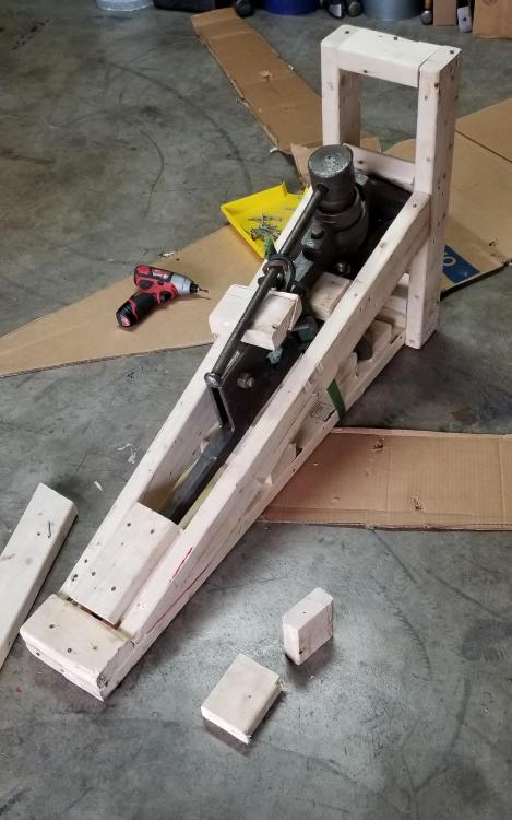

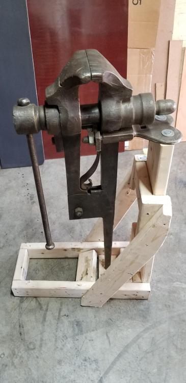

  11. Haha sorry anachronist58, I could have sworn it said anarchist. This is my inability to read correctly without just quoting on the forum. I proofread multiple times and still got it wrong. Today I worked on the stand for my new to me vise, spent about 5-6 hours on it. One hour was removing a broken 3/8-16 tap, I should have known better trying to thread 1" plate. Then drilling the 1" plate took a while also. I don't trust my 120v flux core welder to do the job, so I used a mix of m8, 3/8, and 1/2 inch nuts and bolts. It was around completion, that I realized I forgot one of the legs. stand is 55lbs also got to weigh the vise. It will ultimately look like this, plus another leg.
  12. Anarchist58 no, from what I understand, it was dated to around the 1920's? French pattern and quite hefty. Weighs around 100lbs I believe. But my extreme curiosity led me to pick up a crane type digital scale. So I'll know better once she's weighed on it. Thank you jlpservicesinc, I purchased through a very kind fella on Instagram. Happened to see a post of him restoring a vise, and turns out he does it regularly. This is a 6inch French vise, one I'm not super familiar with. But the threads are crisp with no damage as far as I can tell to the internals of the bell housing. Looking forward to using it, as a tiny bench vise doesn't cut it. I discovered a small crack on the very end of the bell housing. After asking the seller about it, he graciously offered to replace it. But being so minor, I decided to grind it off as there was still plenty of thread on it. Most of my shop time was spent cutting up pieces of square tube, to build a hammer and tong rack. Then trying to piece together some scraps I had for the vise stand. Having a small 120v flux core welder has been quite a limiting factor.
