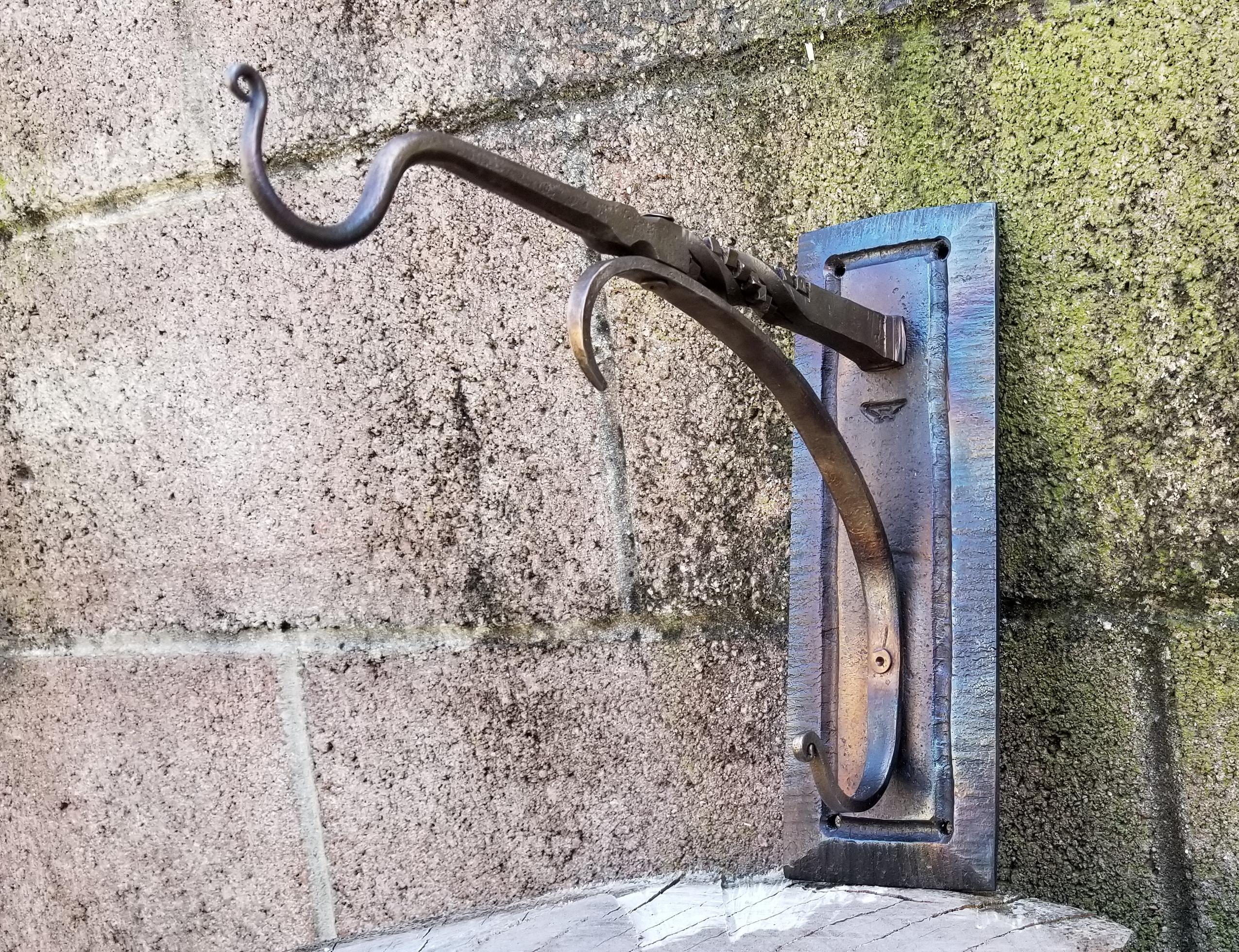

Thanks Das and JHCC. The lower curved support gave me the most trouble, I spent 3 hours making little tweaks to it and still wasn't completely satisfied. Not having a torch or open forge was difficult, after riveting in the main rubik's twist hook- which I had to do in one heat, it wouldn't fit more than 1/3 back into the gas forge. So I couldn't heat up most of it to do the extra tweaks I wanted. I did make a valiant attempt holding the forge burner like a torch to try and heat the areas, but that didn't work out either. Lucky for me, using 3/16 stock I was able to cold rivet the lower support. Something else that didn't occur to me until after, was that the hole for the rubik's twist/ lower support area was crooked. I forgot it was tapered. I picked up a cheap tiny brazing torch, thinking it would work- but alas that was a failure also. So it looks like I'll need to start saving for a torch.. question is, what do I get? Daswulf: sweet grasshopper by the way, I'm always impressed by your creativity. -

This didn't turn out like I had hoped, but I certainly learned a lot of things. Currently de-scaling in vinegar. -
