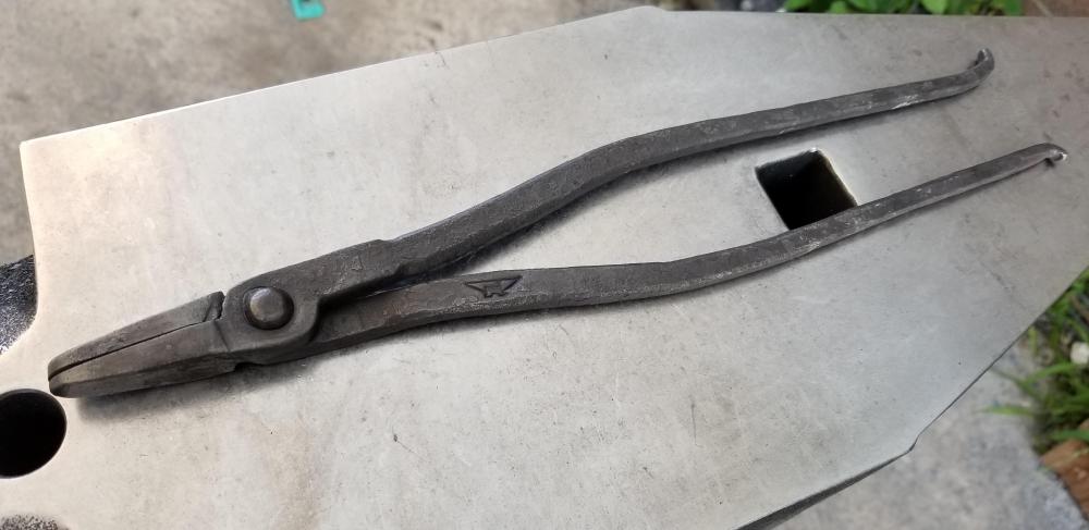

  1. Didnt have much time today, but I did manage to get one tong blank done. Had a cold shut that I foolishly ignored, but I'll try to grind it out. I've forged 3/4 down in size plenty of times, but never for the length of what would be reigns. Boy was it a workout. Still a little sloppy, but I'm pleased with what I think will be my second successful tongs from scratch. Got this done in about 2.5 hours

  6. First success at tongs/pliers. I've made few from kits via Ken's custom iron, but haven't been successful with making my own entirely from stock until now. These were made from 5/8" square mild, intended for random thin stock. moments earlier:

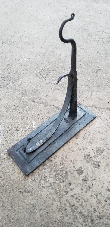

  14. jlpservicesinc: thanks, I'm trying to be very gradual with it. A snales pace if you will. Charles: that's a handy setup, those turning cams(?) on your anvil are neat. Daswulf: thank you, it was completely unintentional. The hook no longer fit in my forge, so I tried using a propane hand mini torch thing. Next thing you know, this is what happened- wasn't what I was aiming for, but I sorta like it now. I wonder if I could use the house oven to heat it up for waxing, I know my mini convection oven didn't work out so well. JHCC: those tongs look perfect to me! Frosty: thank you, it was a really head scratcher project for me. Took longer than expected to finish- due to my own lack of time.

  19. Thanks Das and JHCC. The lower curved support gave me the most trouble, I spent 3 hours making little tweaks to it and still wasn't completely satisfied. Not having a torch or open forge was difficult, after riveting in the main rubik's twist hook- which I had to do in one heat, it wouldn't fit more than 1/3 back into the gas forge. So I couldn't heat up most of it to do the extra tweaks I wanted. I did make a valiant attempt holding the forge burner like a torch to try and heat the areas, but that didn't work out either. Lucky for me, using 3/16 stock I was able to cold rivet the lower support. Something else that didn't occur to me until after, was that the hole for the rubik's twist/ lower support area was crooked. I forgot it was tapered. I picked up a cheap tiny brazing torch, thinking it would work- but alas that was a failure also. So it looks like I'll need to start saving for a torch.. question is, what do I get? Daswulf: sweet grasshopper by the way, I'm always impressed by your creativity.

  23. Thanks Daswulf. I was initially thinking straight as well, but felt like it didn't have enough pop. The main hook is only 1/2'' wide, so not a ton of wiggle room. Similar twist for the lower adds too much pop for me. Maybe I'm overthinking it? What I've concluded so far with the sketch, is using 1/8'' x 1/2'' flat stock and a small taper at each end. Although I remain undecided.
