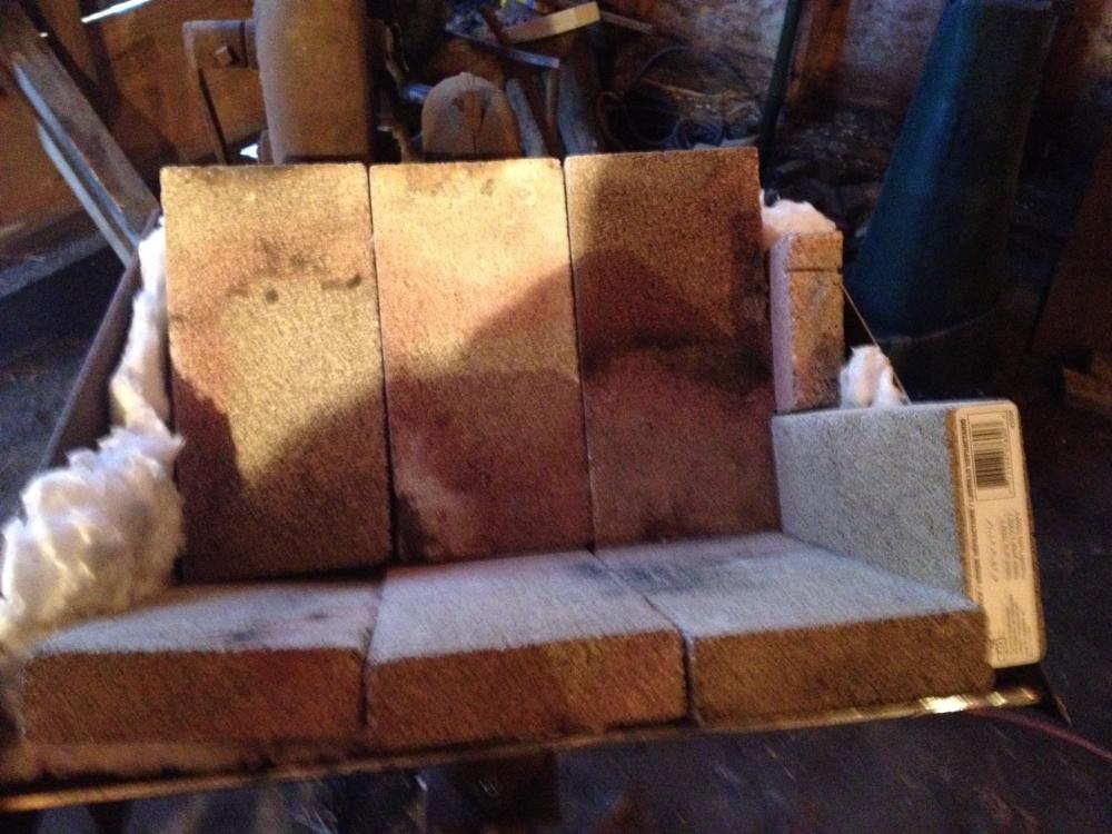

  3. Well I lit a fire today , I used a 1" nipple long enough to get about 1/3 of the way down the trench. I am sold on the side blast system! It seems to make controlling the charcoal fire so much easier than a bottom blast. Man, you sure don't need much air either. I used some maple lump charcoal, store bought, lots of fleas. Is it water in the charcoal that causes those sparks? I am going to use the forge the way it is for now till I get used to managing the fire better. I do have a idea for a manifold. My thought is to run the pipe down the outside and tee it off three times. So there would be 3 1" tuyeres evenly spaced along the side. If they were threaded you could just cap or plug the ones you don't need. I still can't believe how little air you need to forge with this system!
  4. Hmmm, it would seem I have not thought this through, as usual. Well, I guess I could run 1" pipe the full length of the box and drill holes in it, or, drill holes in the "air box". I could also just go back to the drawing board.
  5. I did build a Whitlox style forge for wood but I really did not like it. I make a lot of garden shepard's hooks of varying lengths and my thought was to get the length so I could bend the hook in one heat. The propane forge is just too small, it gets the job done but it take 2-3 heats. That is the main reason for the trench style. My other thought was that welding small stuff would be easier in this configuration. My forge welding skills are poor and I figured it would be better if I could pile the fuel up in a constricted area it might help. I will try this before I weld it up and see what happens. Most of the wood I have access to is aspen ,balsam poplar, spruce , pine and birch. So there shouldn't be a big accumulation of ash under the tuyere.
  6. I have a coal forge but at $85 cad plus tax for a 70# bag it doesn't get used much. I also have a propane forge which gets used the most but the last quote I got to fill my 100# tank was $105 CAD plus tax. However ,I have a copious amount of wood on my property , so one can see why I am entertaining the use of charcoal and I am cheap.The firebrick I have is 1" so I thought the blanket ( which was free) would be needed. I have enclosed a photo or two of the mock up any ideas or criticism is very welcome.
  7. I don't mean to hijack this thread but since we are talking about side blast charcoal forges.. I am building a trench style forge mounted on an old Canada Forge blower. It is configured to be a side blast and the fuel will be exclusively charcoal. It will be lined with firebricks backed by dura blanket. My question is; what is the minimum distance the tuyere can be off of the bottom?

    Well, here is the rough, and I mean rough, prototype of my wood forge. Already I have to change a bunch of things but I couldn't resist firing it up. So far fire management is looking to be a major learning curve. The logic of a side blast is coming into focus too. This bottom blast but that could easily change now that I have a better idea for making it from the side without compromising the original design of the blower configuration.

    Well, if I go with the side blast into a v shaped firebox , I think that would mean that the metal being forged would have to be placed over top of the tuyere. Is that a problem?
  13. dimag replied to dimag's topic in Solid Fuel Forges
    Frosty, do you think a 1" pipe necked down to 3/4 at the tuyere would work for the side blast? I just happen to have a bunch of those sizes in both pipe and fittings. I believe there are some schedule 80 3/4" nipples around here someplace that might extend the life of the tuyere that will be in the fire. This all new to me , I have been primarily a gas guy with some coal experience but never used charcoal or wood.

    I was given a Canadian blower & forge forge, or at least what is left of it. It was defineltly rode hard and put up wet. The fire pot and tuyere is completely gone, and the handle also. I managed to get it freed up today and surprisingly it still blows air very well. It is model # 210. I got thinking ( I know, a dangerous thing) that I might build a wood burning forge in the Whitlox style that I could bolt on to the unit without compromising the integrity of the blower and stand. My first idea was a pipe tuyere with a tee that would be fed air from the middle instead of the end and it would be welded to a piece of plate that could be bolted to the blower outlet, then build the sides etc. The second thought was to make it a side blast tuyere. I would have to bring the pipe from the bottom of the air outlet , which is a ash and clinker trap sort of thing, and up to the forge. Would a side blast work in a V shaped wood burning forge or should I stick with the bottom blast configuration?
