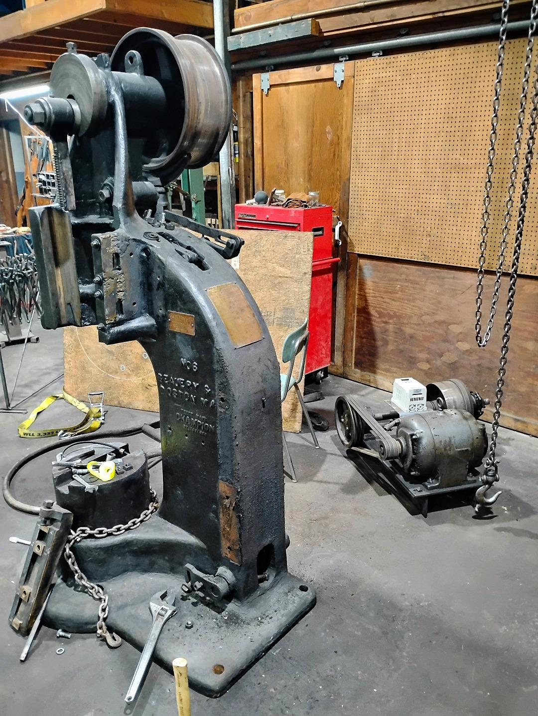

  10. The 1915 Beaudry No.6 is progressing slowly. The broken cheek for the bronze guide is bolted on and reinforced with a heavy welded gusset back to the frame (removed for the picture) and the previous electrification with homemade clutch is removed. Now the big choices 1) How to build the jackshaft tower and shafting/pulleys arrangement for the 17 inch flywheel 2) What belting/motor/speed reduction to aim for 200bpm (less than the factory suggested 275) 3) Design and make a new idler and idler/treadle connection 4) The the big looming question I am still scratching my head on is how I am mounting the hammer... For many reasons I do not want to permanently hard bolt the hammer to the floor (the floor is sloped 1/4inch per ft) nor do I want to cut the floor (7 inch reinforced concrete) for an isolated foundation... I got heavy oak timbers to make a raft but not sure how raft and jackshaft tower go together? All ears form you guys that love these hammers - I want to do this old girl right and have her running and looking her finest!

  13. My newest acquisition for the new Artfire Michigan school is a 150 pound Beaudry I rescued from an abandoned blacksmith shop in down town St Louis Missouri. Now I need to learn everything there is about getting this old girl up and running again! Who has a Beaudry and willing to share some insight? I am all ears!

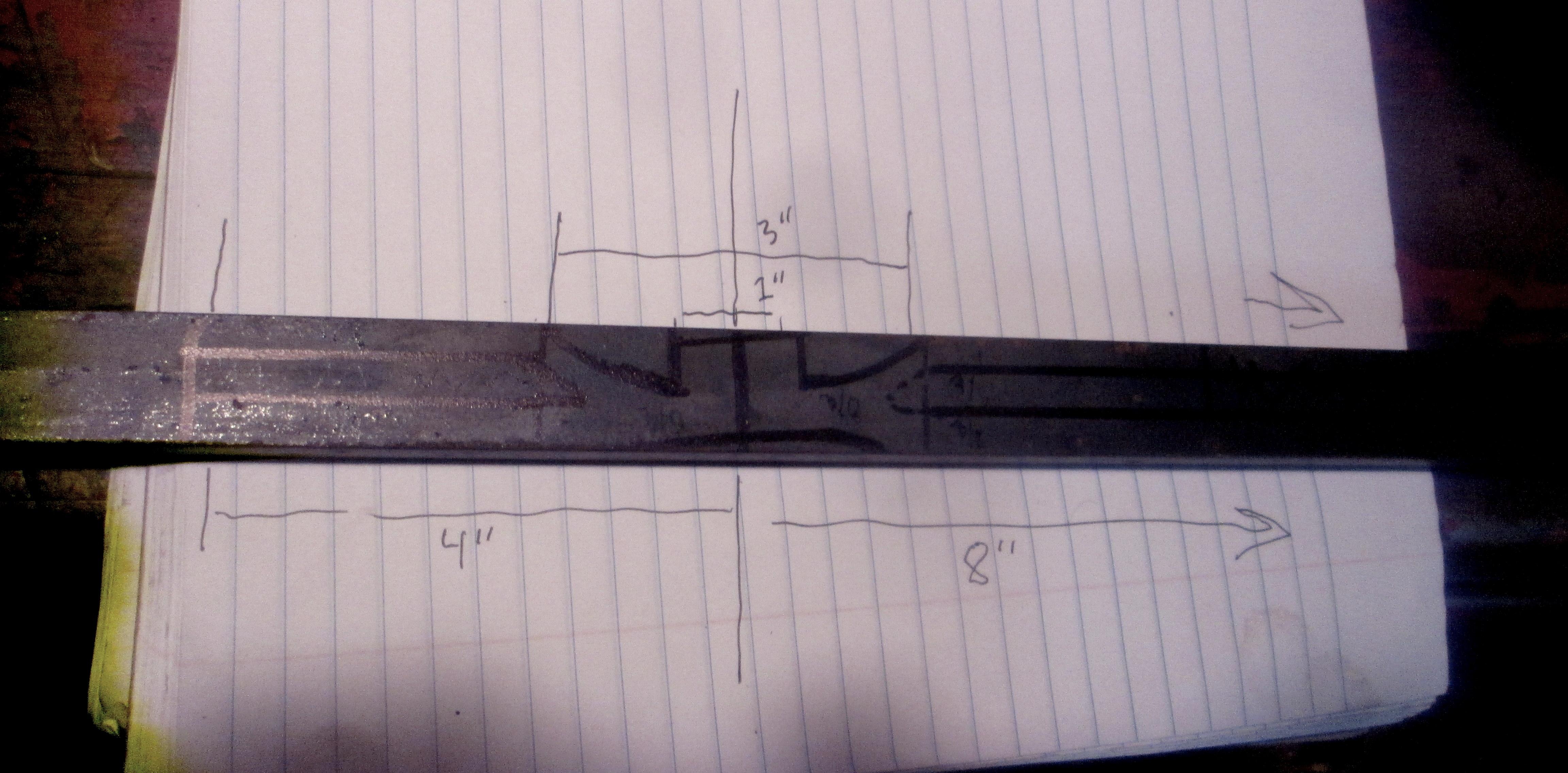

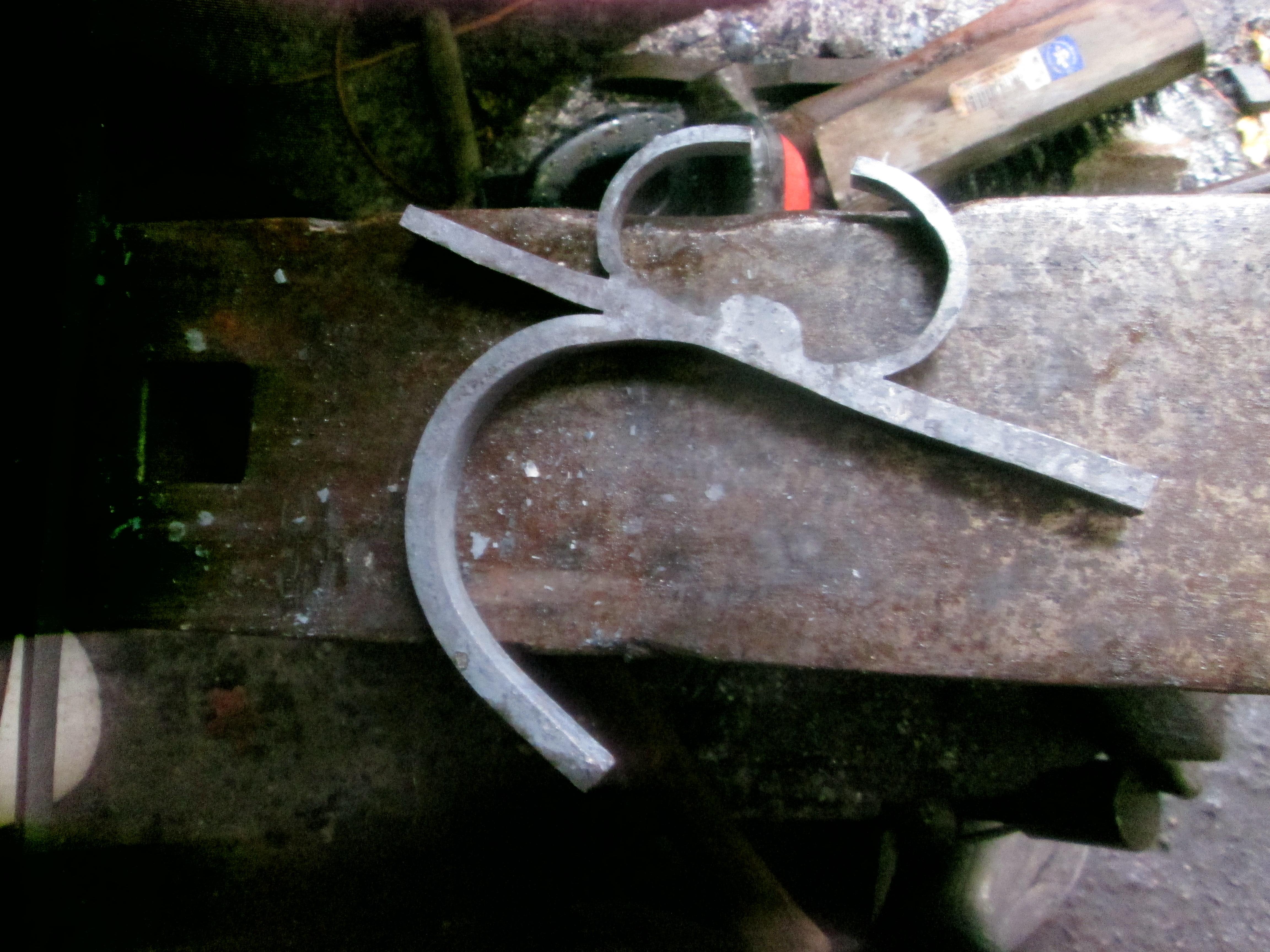

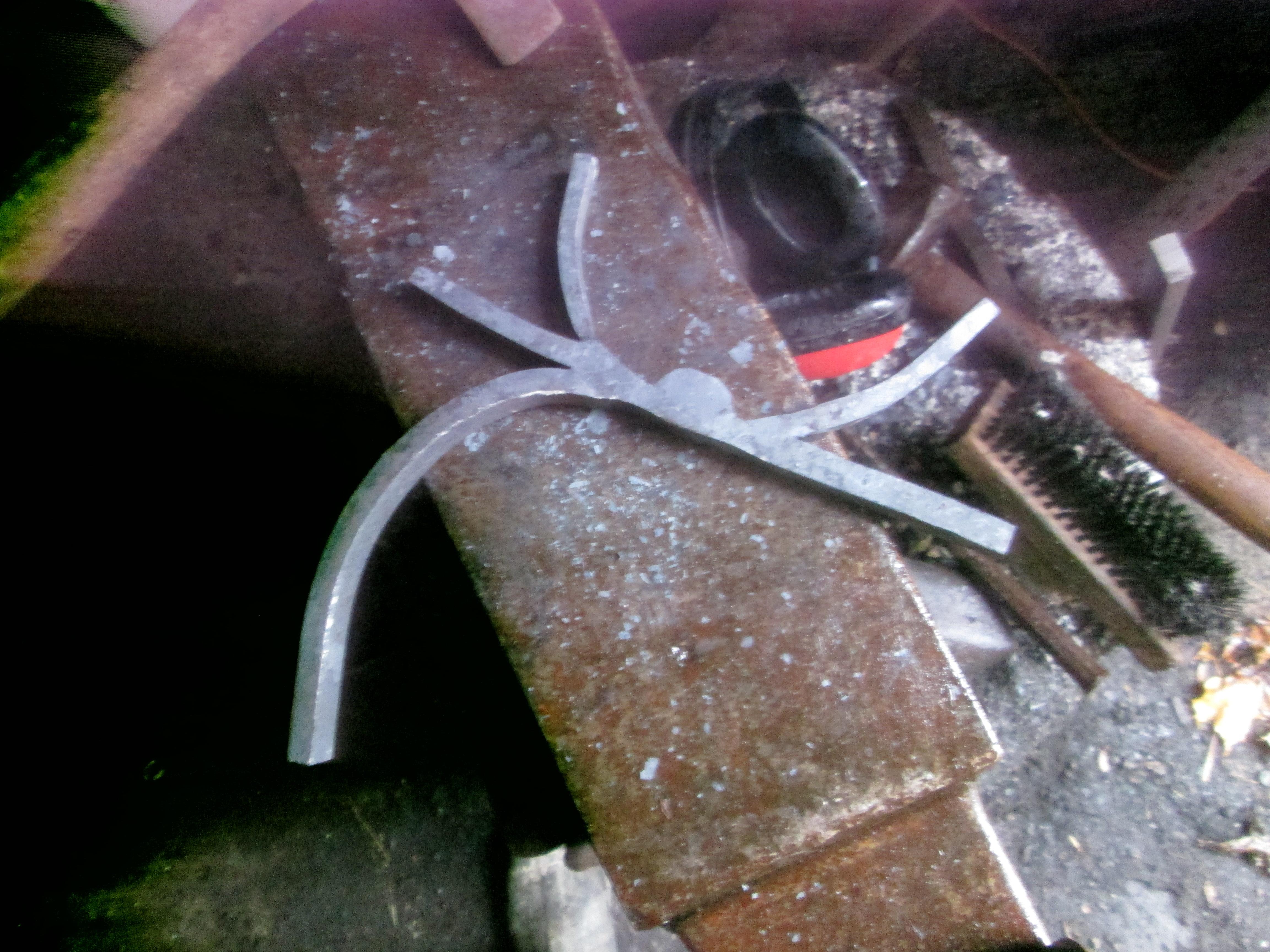

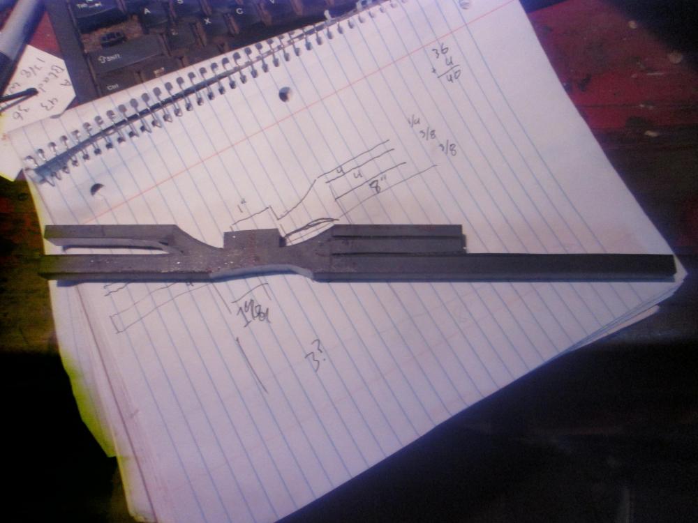

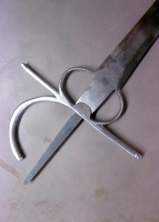

  14. Over the last 8 years I have been asked a number of times to make a very certain type of sword, and I seam to be the only person to have ever reproduced it. The sword is the Spanish model 1728 Cavalry Sword. We are lucky to have a number of originals in privet and public collections, and the original arsenal diagram for their construction. After much trial and error I have found a great way to forge the hilt from one piece and want to share. This technique works well for any semi-complex to complex hilt (with the addition of more rings once the base is forged). Here is a picture of my most recent Spanish M1728 copy (12/2/19), measurements taken from the original #7366 in the collection of Arizona Historical Society. Now the WIP of how to make it! I start with a piece of mild steel that measures 5/8 x 1 x 12 inches. Lay out the "center" at 4 inches form one end, 8 inches from the other. Notice on the hilt above that one side has three pieces (pass ring, quillion, knuckle bow) and the other side only has two (pass ring, and quillion), Lay these out as straight lines parallel to the bar. Now for the super secrete part! Draw in the block (where everything comes together and the tang slot is) at a slight angle. Remove the waste. I use a band saw, but what ever tools you have. You can see I also shortened the pass ring and quillion to their final length of 4in on either side of the block (the knuckle bow is the long piece and will be shortened once bent to final shape) I mill the slot in the shoulder, but you can also hot slit this with a chisel. Later the tang slot is hot punched with a 3/16 x 1/2 punch which opens the block up and makes a nice swell in this area Once all this cold work is done, it is time to fire up the forge! First forge the angle out of the block, aligning the quillions both sides. Once the block can sit on the anvil you can punch the tang slot (3/16 x 1/2in punch). Then begin opening all the arms Once open stop before you round over the rings so that you can get in the tight spots with grinder or files and bring all the "arms" to final thickness either forging or grinding Now bend the arms to final position and trim to final length. At this point grind / file (whitesmith) the hilt, fit to blade, etc. If I wanted side rings etc, I would weld them on (arc or mig) and file to hide the joints. But I bet one of you is creative enough to figure out how to get everything out of one piece! Thanks for looking! I look forward to seeing what others do with this idea! If you have any questions or want to see more of my work please check out my website www.irontreeforge.com
