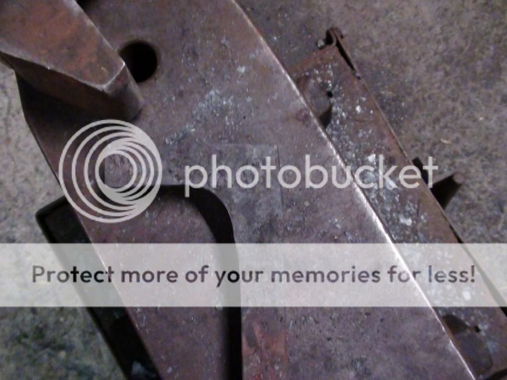

  1. Vaughn, I have a hot cut that was made back in the day that has a 90o bevel. It can be pretty annoying, since i leaves such a long rag and refuses to hold a good edge.
    Excellent work.  But, is that hot cut's bevel really as close to 90 degrees as it appears?

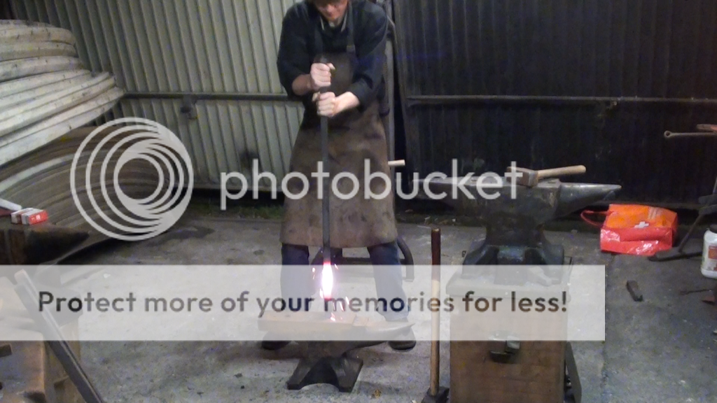

  11. Dear Dave,
    It has been my observation that it is tough to accurately judge heat by videos. The cameras adjust for exposure and depending on the camera, ambient light, etc. will not show the same color as a live eye would. Often, the video shows the metal at a hotter temperature than what it really is but I've seen the opposite too.
    It appears to me that Daniel is a pretty experienced smith and I would be suspicious of the idea of him working metal at too hot or cold a temperature. Anyone who can accurately judge welding heat usually knows one end of a hammer from another.
    Lightly,
    George M.
    Thank you for defending me George, but Dave was right with the work on the horns, there in the end it was too cold. But actually the ambient light is indeed very bright and they still must have been red. Furthermore mild steel can be worked cold to a certain degree... It is the camera as well as the ambient light that alter the visuable glowing colour so actually one can only judge it with his own eyes in a very dark shop.

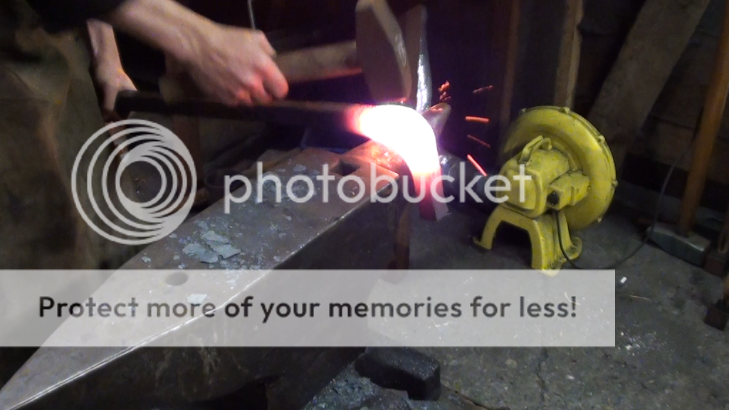

  12. A question from a uninitiated. When you where welding the piece was throwing off many sparks. Every book I read says once the steel is sparking it is too late to weld it because it is burning. Could you please explain why it worked for you?
    That is a lovely piece by the way.
    Paul
    Thanks Paul, usually when your steel sparks you burned it and you can through it away, but when forgewelding you use a flux that forms a protective coating around the steel, that keeps the oxigen away from the steel and thus allow it to be that hot without burning. If you see sparks in the fire your wait for about 5 seconds and then you take it out, it should have optimal welding temperature then. You shall not let it get so hot, that the steel turns liquid already. If you have drops coming of of the steel you made it too hot even for welding and it will kind of shatter like cast iron. The welding temperature depends on the steel and the flux you are using. Pure iron with sand as flux will have a very high temperature, high carbon steel with borax or fancy welding powders will weld at much lower temperatures.
