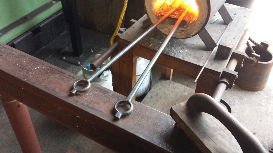

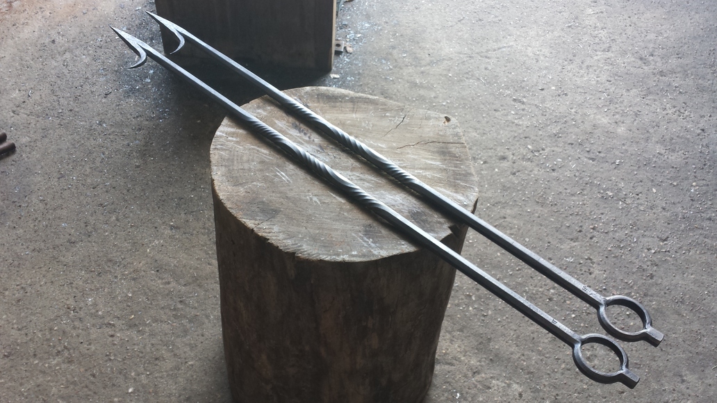

One last commission before Christmas. These started out as 1/2" square bar, forged octagonal and have drifted handles, twisted centers and forge welded points. About 31" long.

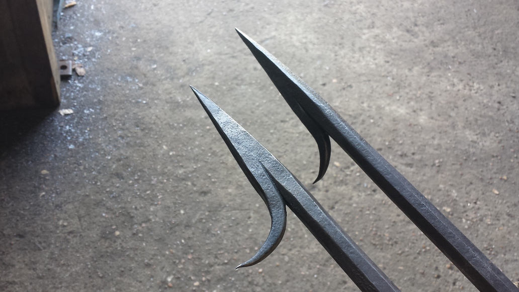

Dsw: yep, these were cut 1/2 square. I might try the hidden rivet approach on the next one.
JME: if it was 2 prongs, I would have forged them out. With three, I wanted them to be exact, so I marked out what needed to be removed and cut most out on the bandsaw. The rest was on the belt sander and small files.

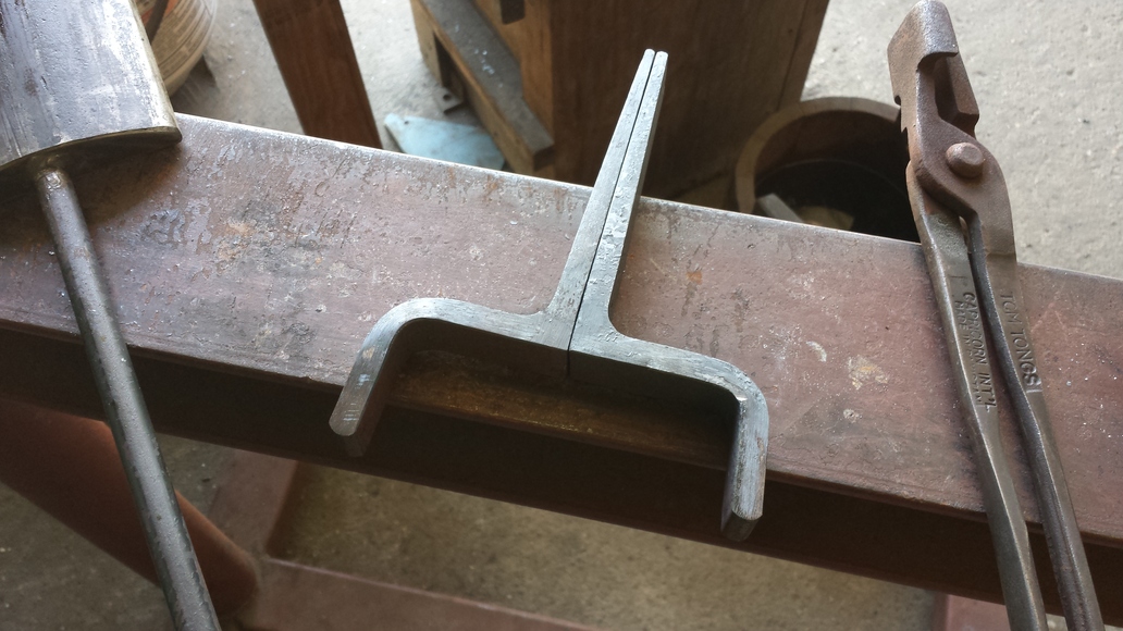

JWS, the slot punch tooling makes a centered 3/8 hole, shearing out a 1/4" thick slug. I have a no.5 flypress for this. The front clamps I adjust so there is a bit of play cold so the bar doesn't get stuck. The piece swells slightly after punching. The punch is machined from 4140 and drives down flush with the roof of the cavity underneath. The cavity/channel is slightly taller than 1/4" to account for the flashing. The horizontal bars keep the piece from getting stuck to the punch. The jig is mild steel that I case hardened. Hope this helps. -
