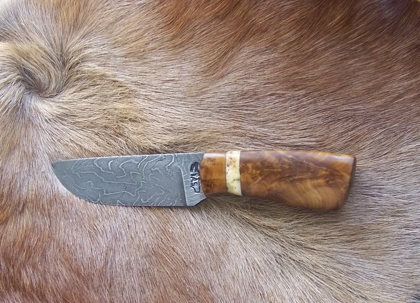

  11. Finally found some time to finish something.  A small 60+ layer Damascus hunter with Wild Olive root handle and Giraffe bone spacer. Wild Olive was a root I dug out some months back in the hills outside Eshowe.
    Thanks foe looking
    Tim
