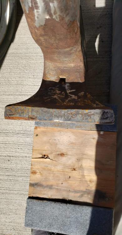

  8. That was kind of the price range I was thinking.
  9. The anvil is a couple hours away. I wanted to gather some initial info before making a trip. The guy was asking 1100 bucks but after I asked him where he came up with that number he said he knew nothing about anvils and just looked at some classified prices. I told him that anvil prices can vary $1-6 per lb based on brand, condition and performance and can go for more if they are extremely sought after anvils. He then said he was open to offers. I told him i wouldnt make an offer until i had some more info. I figgured I would let him know a low end and high end offer before I drive up to look at it and let him know i would give him a final offer when i check it out (ring and rebound)
  10. I am trying to dig up some information on this anvil. To be honest i am not hoping for much because there are no stamps or markes besides what looks like a touch mark on the far left, a weight (150) and a serial number. From the appearance I would say it looks like a forged anvil. The owner hit it lightly with an angle grinder. All the marks on the face make me kind of assume the face is a little soft but that is only a guess. What are your thoughts? Is there any way to identify the maker of this anvil and perhaps the estimated quality before I drive a couple hours to check it out?

  14. Well, maybe it is forged. To be honest I just read that were cast steel. I honestly thought it looked forged to me. I dont know how I did considering how rare anvils are around here but I paid 1100 for it. Not a steal but probably not to bad.
