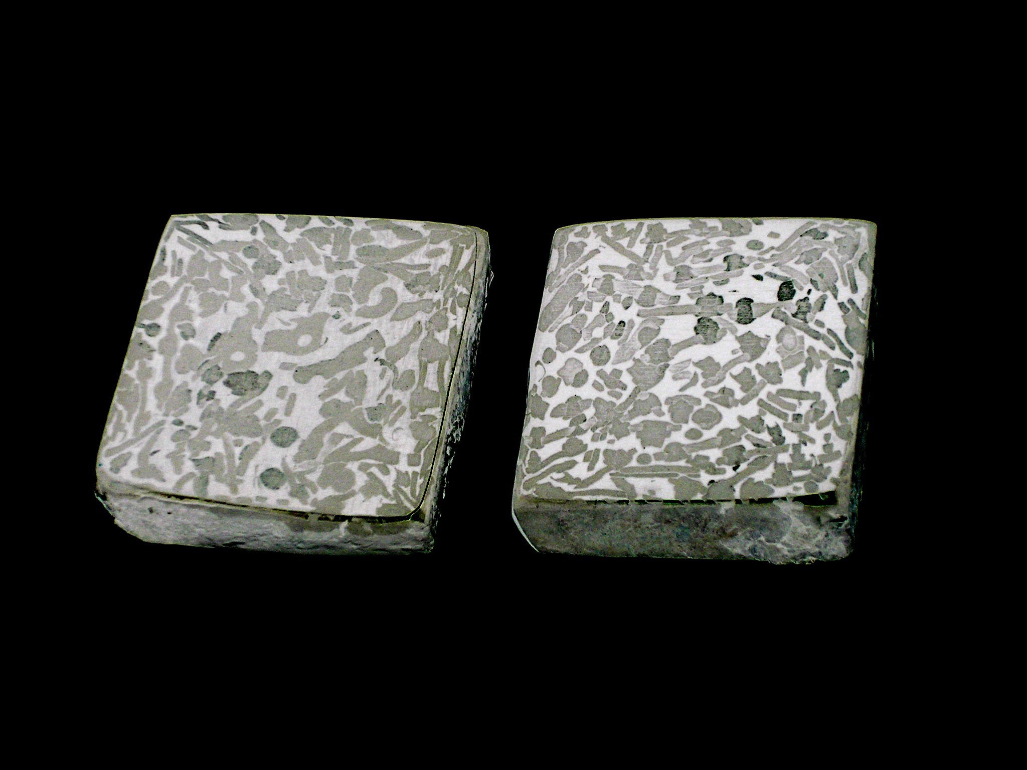

These are the end cuts of the billet I made. This is chainsaw chain parts and pure powdered nickle - the billet started as a box 3-1/2" x 3-1/2" x 3" long (filled with the chain parts and the nickle sifted in to fill all voids) - then I forged it down to 1-5/8" x 1-5/8" x 5". - JK
