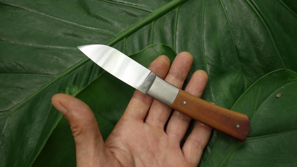

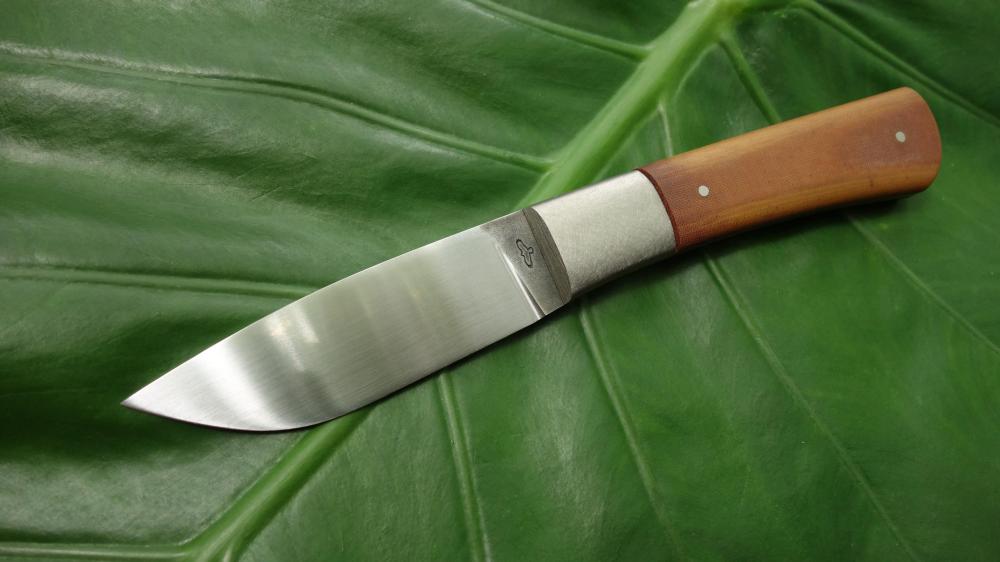

German 105WCr6 Steel (equivalent to Japanese Blue Aogami#2 Steel) those are made ca. 1960...I was born 1962 so I am Vintage as well

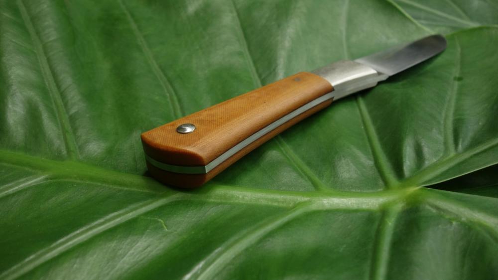

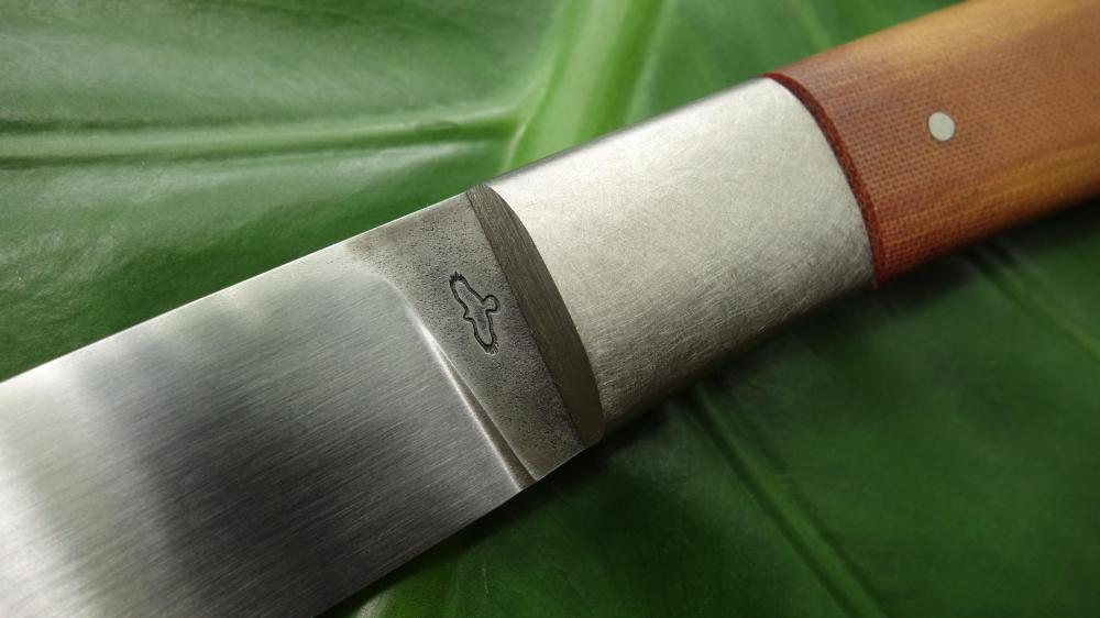

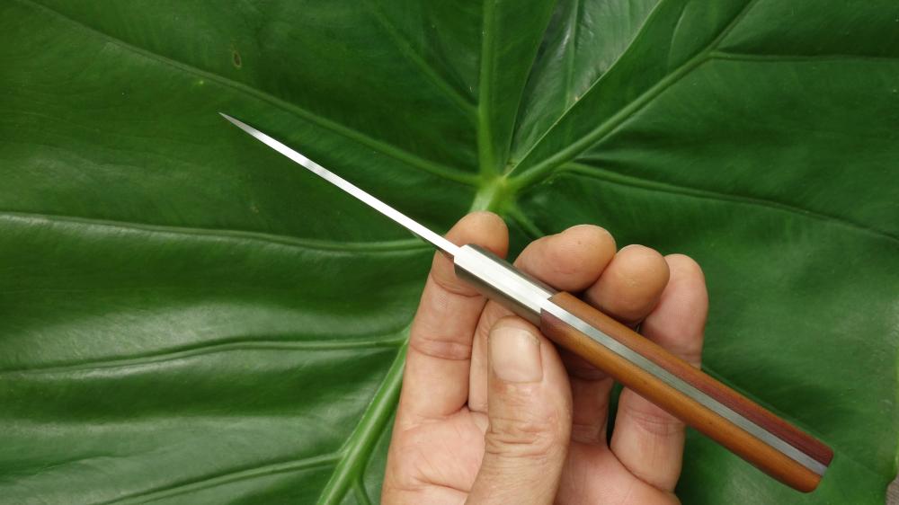

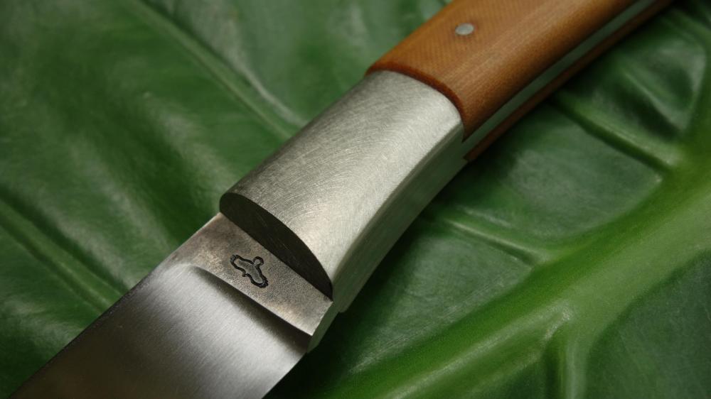

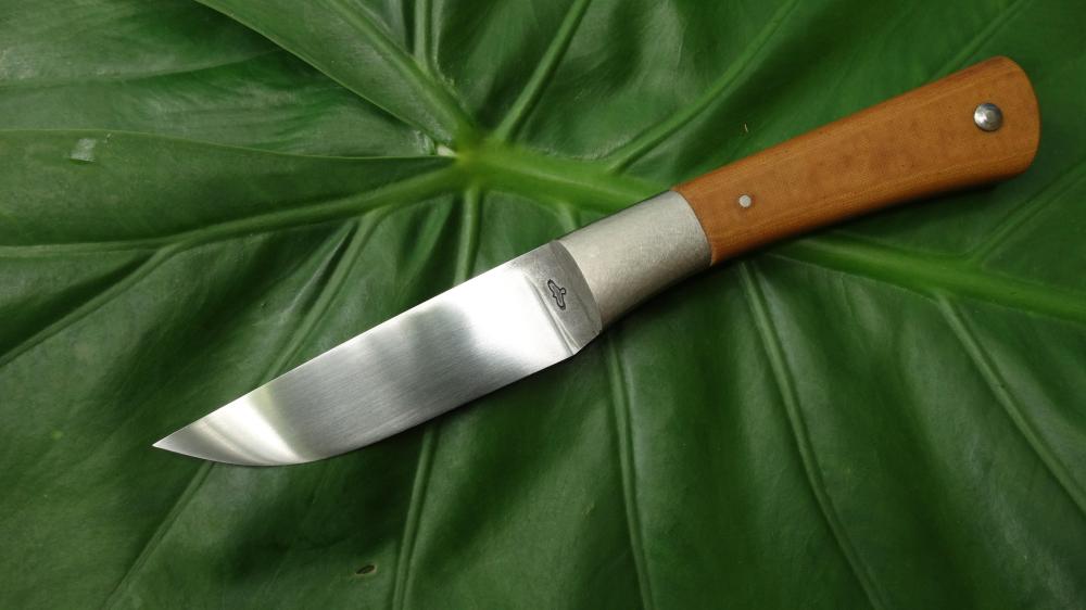

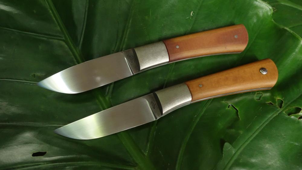

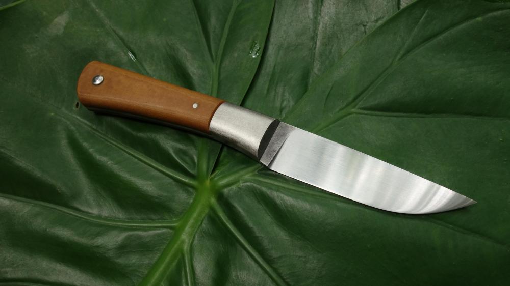

Two small EDC Users with 105WCr6 Blades. Dove tailed Bolsters, Washers and riveted Pins are made from Titanium and for the scales
I took some old vintage Canvas Micarta.
The semi-drop point has a length of 88 mm and a total length of 196 mm, the one with the back tip blade measures 92 mm and a length of 202 mm.
