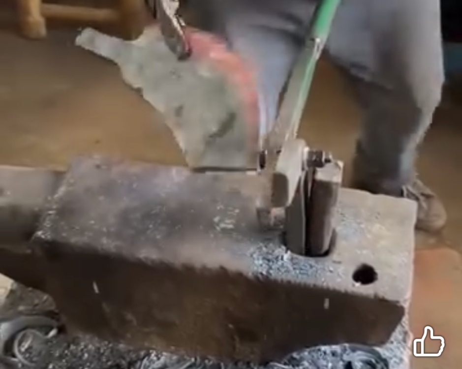

A Beverly B3 shear can handle up to 7 gauge (3/16”) mild steel and 10 gauge (~1/8”) stainless steel. If you anneal your metal dead soft, you might be able to get away with it.
That said, you might have success cutting your blades hot. I wouldn’t do it on a $1500 Beverly, but here’s a video of a smith (in China, maybe?) trimming a blade with a pair of shopmade shears mounted in his anvil’s hardy hole.
https://www.facebook.com/share/r/16KegNxXJZ/?mibextid=wwXIfr
 And here’s a cropped screenshot:
