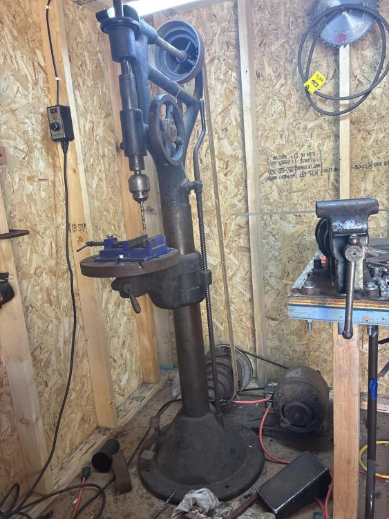

Just wanted to share my find I have had her for about 5 months now and have used it almost daily picked her up for 100 bucks off of marketplace and hooked it up to an old tig floor pedal weighs more then 300lbs and works better then the big jet brand one at my trade schoolimage.thumb.jpg.9e7c6d2bd452871ea034e4e1be9cb268.jpg
She used to be run off a line shaft but has been converted to an electric motor she is gonna outlive me even though I am only 16 lol
Yeah, that's worth a C note. Do you KNOW for sure an electronic current control is compatible with the motor? If not it will fry the motor in a short time. There are a couple guys on the forum who know the specifics, I don't. IIRC newer induction motors and rheostat power controllers don't play well together.
It's worth looking into, a nice big motor isn't cheap.

If you are speaking of the tig floor pedal then not to worry as I am just using the shell it was an old broken one from my trade school so I took the electronics out and just wired up a push button onto it
but if you are speaking of the thing on the wall I have no idea my step dad just bought it and gave it to me lol
Okay, it's the on off switch, no problem, So long as you or someone can't step on it and turn the drill on accidentally. Having it start while you're turning the chuck key or rolling the belt to a different speed SMARTS!
We're big on safety here, no criticism implied.
Yeah thanks I am going to set it up so there is a secondary switch as a hard stop and saddly the motor is only a 1/2 horsepower but she is still a champ and she was manufactured and ran in my home city of Erie pa so she is definitely worth it
Good, I'm less nervous now. ;) A foot switch isn't really necessary or even desirable on a drill press, you aren't likely to be turning it on and off quickly. A switch on the wall where the speed control is would be perfect. An old beauty like that can be hand turned for fine adjustments. Seriously, I'v been using drill presses for more than 60 years and have never needed anything but a simple switch. I have to admit I've worked with enough knuckleheads I'm highly in favor of needing to poke the chuck key in the safety switch to turn one of and an emergency kill switch.
Another word of caution, NEVER use a drill press or other rotary tool, lathe, grinder, etc. wearing loose clothing or loose long hair. For example, one of the worst imagine long hair getting tangled in a drill bit or lathe chuck. Your head WILL be dragged into and wrapped around the bit faster than you can scream ouch. If you are LUCKY it will just rip a big patch of your scalp off your skull. If not lucky a powerful machine will literally wrap you around the rotating part resulting in an arm so badly broken it's just there, rip it off or kill you outright.
As old as that motor looks it's probably a lot more powerful than a modern 1/2 HP motor now. Now motors are rated at their burn out power, to get a full 1/2 Hp out of a new motor you'd literally be burning it up as in letting the smoke out, sparks and motor death.
Old motors were rated at their maximum output BEFORE damage occurs so you could run a 1/2Hp motor to it's capacity all day without damaging it.
If it turns out drilling drags the motor down, use a slower setting on the belts. Drilling steel especially is a low RPM task. Use low gear, step pullies are literally the same principle as shifting gears in vehicle.

I am studying welding but the two instructors in my school have taught us the general way to use a Bridgeport as it is always a good thing to know how to use as a welder and the reason I put it as a floor pedal is I do cycle through a lot of different tools when using it It is not a dc motor so I can’t reverse it but I still use it for threading as on the lowest speed it is probably at most 120 rpm so it makes for a great threading tool
