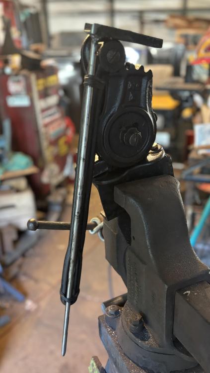

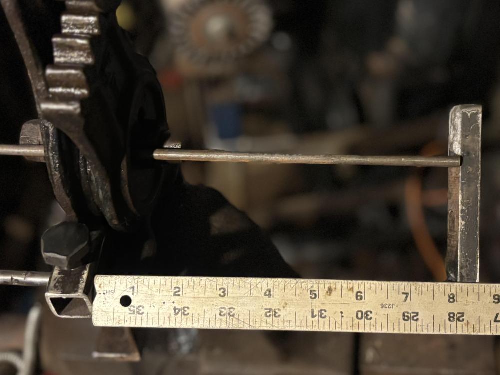

Added a length stop to the bar cutter (which I also cleaned and oiled), for cutting multiples of a particular length.

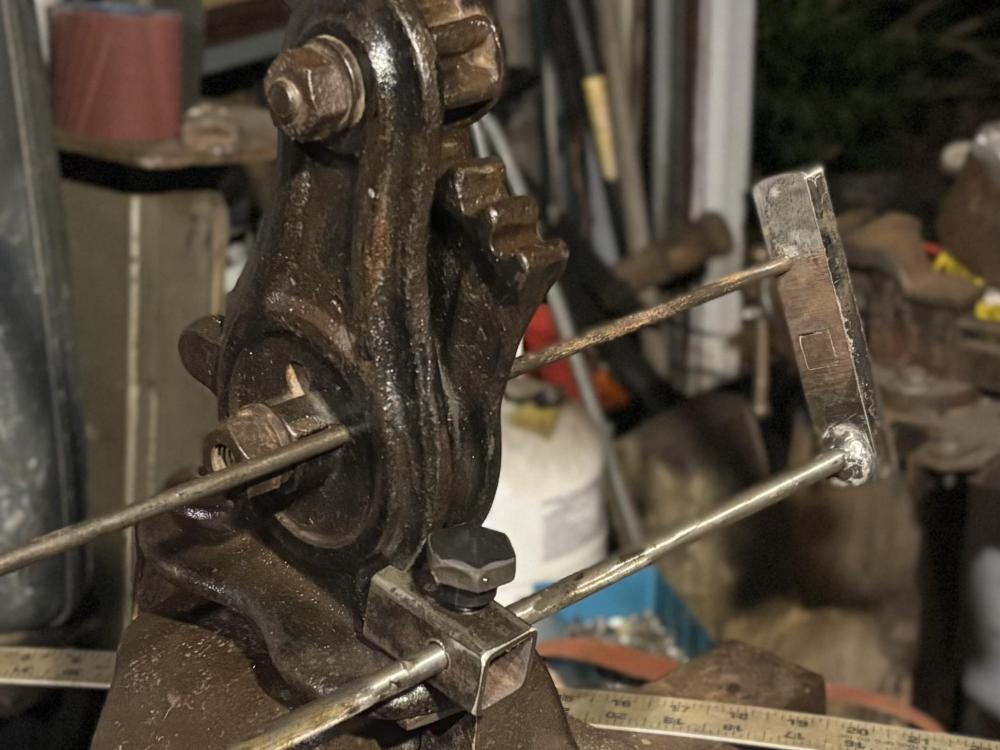

The critical part of this is the little piece of square tube. This is held down by one of the bolts that holds the cutter to its mounting bracket  (for holding it in the vise). Holes on the sides allow the adjustable stop to pass through, and a hole on top is threaded for a knob* to lock the stop in place.
The right-hand side of the tube is in line with the cutting blades**, so measuring from that side to the stop gives you the length of the cut piece.
I’m going to call that a success.
* Salvaged from somewhere, ground down to a smaller size that doesn’t bump into the base of the cutter.
** I didn’t take a photo, but I was interested to see when I took the cutter apart that there’s a pair of hardened steel cutting blades inside. Nice bit of product design.

Here’s a shot of the bracket I made for clamping it in the big bench vise:
 And here it is in storage mode, with the stop removed from its holder and secured to the handle with ranger bands:

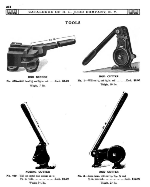

The maker is "H.L.Judd Co." (cast into the handle), and the model is "No. 1" (cast into the body).
Judd was a company based in NYC, with factories in Wallingford, CT and Chattanooga, TN. In their 1913 catalog (available online HERE), they describe themselves as "Manufacturers of Upholstery Hardware, Curtain Poles, Shade and Carpet Hardware, Picture Hardware, Stationery Hardware, Brass Fancy Goods, Brass and Iron Bedsteads, Brass Railings and Drapery, Display Fixtures, Andirons, Fenders, etc."
The "Rod Cutter No. 1" is shown on page 214, along with a couple of other similar tools.
There doesn't appear to be any provision for a stop, but I suspect that little tab is there to provide a reference point to measure from.
(N.B.: Adjusted for inflation, that $6 price in 1913 is about $195 today. I paid $20, which is 61¢ in 1913 dollars. Pretty good deal, either way.)

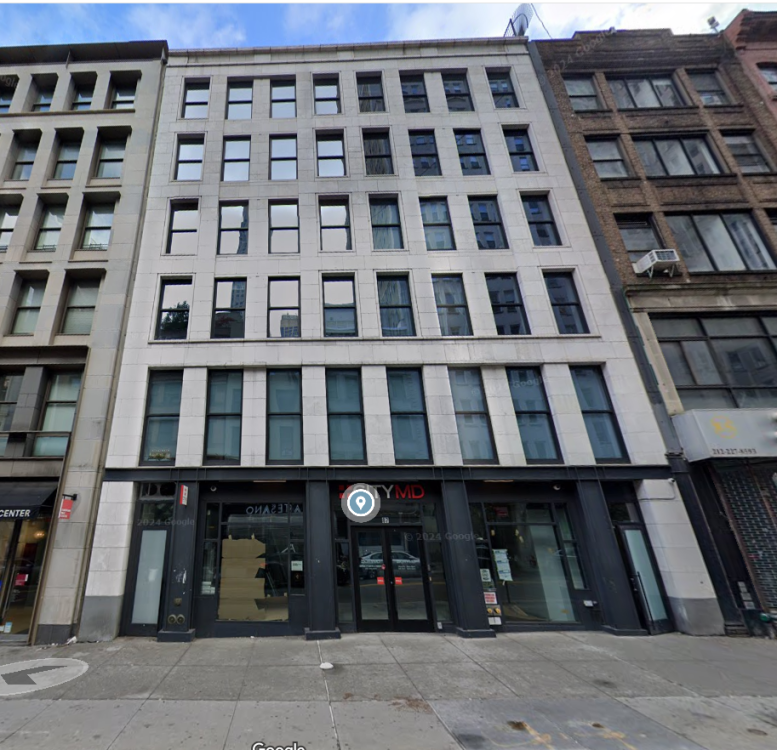

It's also an interesting window into some interesting historical connections. First of all, their building on Chambers Street (a couple of blocks from the World Trade Center site) is now an urgent care center with condominium apartments upstairs:
The building appears to date to the time of significant economic prosperity and redevelopment of Lower Manhattan at the end of the 19th and turn of the 20th centuries. A lot of these buildings were originally built with masonry-over-steel-frame construction, but with the interior structures (floor joists and floorboards, wall studs, etc) almost entirely made from old-growth timber from the South. This was after the destruction of the Southern economy post-Civil War, when one of the few things the South still had to sell was its timber. The building (now demolished, alas) that housed the furniture store where I worked for many years was one of these; it had originally housed a machinery company with a showroom and offices on the first floor and workshops on the upper floors. When we cut a stairwell from the first floor to the second, we discovered that above a thick plaster ceiling, the original T&G floorboards were laid in three layers at right angles to each other, to keep oil from dripping down through the cracks from above and fire from getting through from below.
