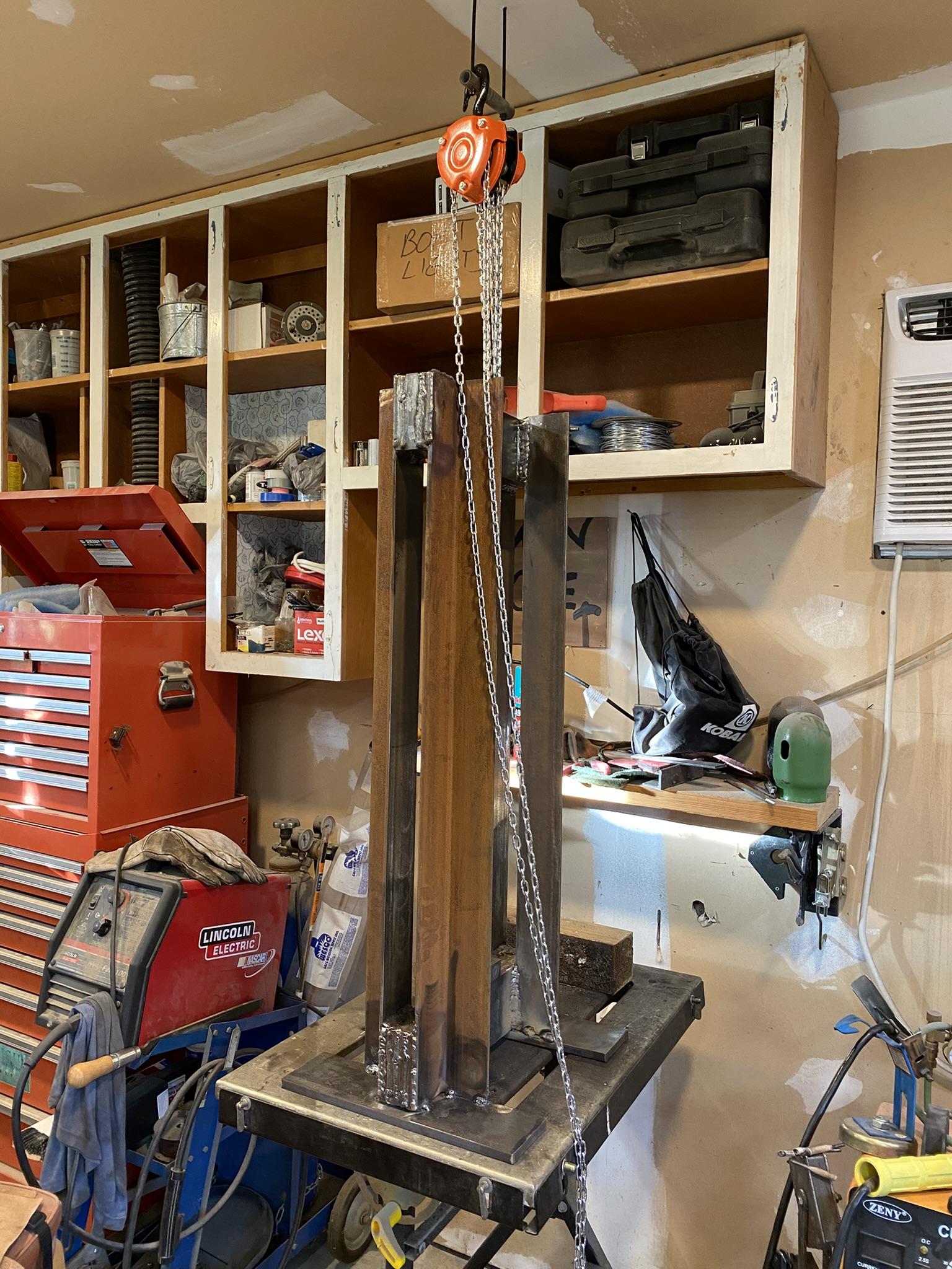

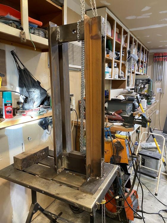

My rotator cuff surgery didn't happen on December 23rd.  Deep down inside I was relieved.  I was happy to get back to my long-shelved forge press project.
I was going to buy a Coal Iron Works 12 ton press, but I found out it isn't really 12 tons.  It's more like 9 tons.  Plus it is about $3.5K.  So, I designed this a year ago using James Batson's booklet and CIW's faux-12 ton H-frame setup and bought all the materials.
My nephew is a fresh Mech-E grad, so he did some stress simulations to backup my calculations.  The verticals are 3x3x1/4, the die plates are 1x4, the lower cross plate is four 1/2x4 plates welded together (I had plenty of 1/2x4 flat bar). I welded with 1/8" 7018.  The cylinder is 3.5" diameter with an 8" stroke.  Pump is a 7/1.8 GPM hi-lo gear style attached to a 3 HP 230V 3600 RPM motor via a Lovejoy coupling.  Ten gallon reservoir.  4-way open center valve.  It will be mounted on a stainless steel table on casters.

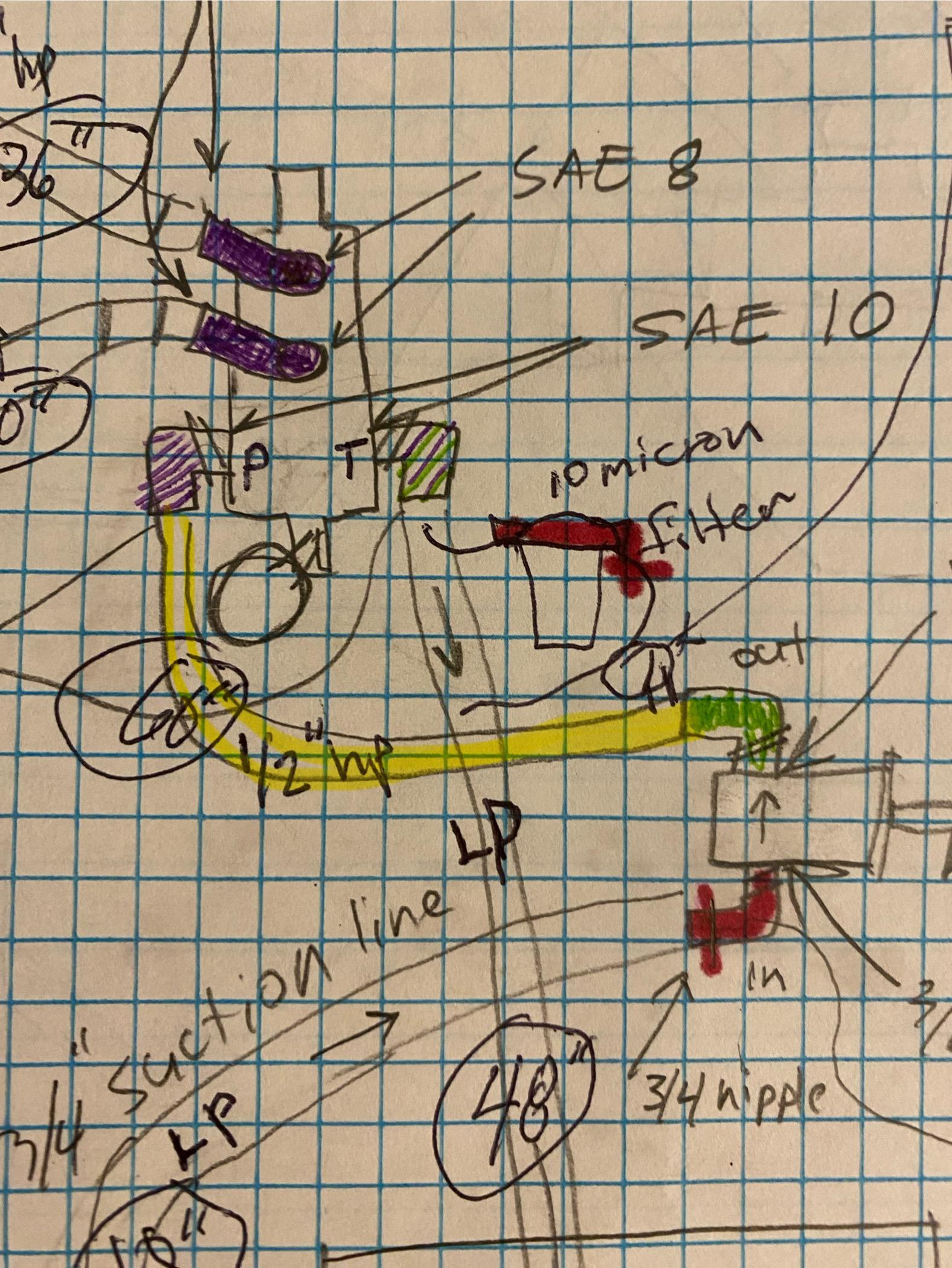

Question 1:  Does anyone have a simple and elegant way to add a pressure gauge to the hydraulic system?  I've been looking for a tee that has a 1/4" NPTF along with either JIC and/or NPT on the other two ends.  I don't like piecing together too many fittings.  Fewer fittings, fewer places to leak.
Ideally, I'd like a 1/2" NPT male (to go into the top side of the cylinder) and a JIC 8 male to connect to the HP line, and a 1/4" NPT female to accept the pressure gauge.
Question 2:  The snubber.  Does it go between the aforementioned tee and the gauge?

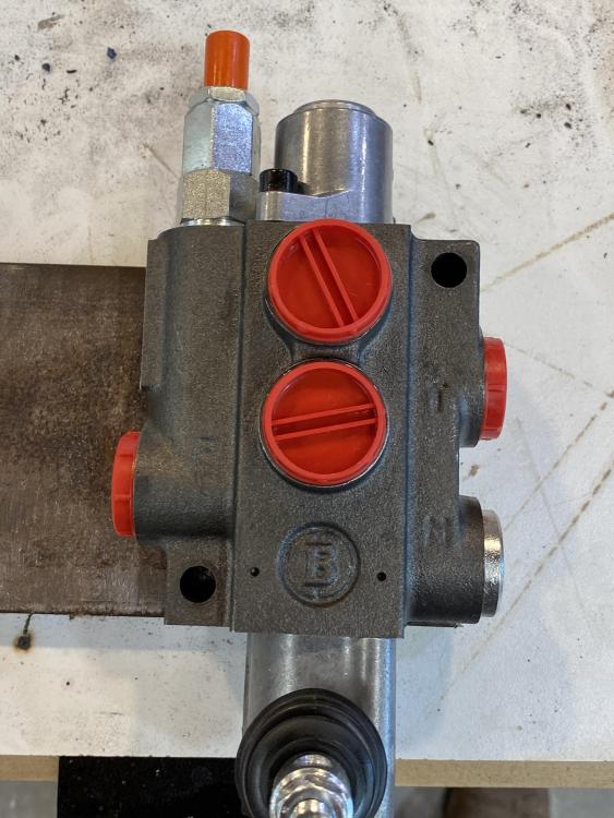

Put the gauge on the valve. There should be a ftp port for the purpose. A short "pigtail" hyd hose gets the gauge out of the way in necessary.
Do you mean NPT port?  Grok didn't know what an FTP port is.  It did mention "file transfer protocol" for those with hydraulic internet connections. :P
Here's my valve.  The spec sheet I have doesn't specify a particular port for a gauge.  In the picture, do you think it's the top port?
Also, the sheet doesn't explain how to adjust the pressure.  It's preset at 2250 psi, and I want to increase it to 2650 psi. Any ideas?

To adjust pressure, remove orange cap, loosen nut right below it, turn slotted bolt with a screwdriver (righty tighty increasy).  Small increments.
To add a pressure gauge, install it using a tee on the pump side, or the "P" side of the valve.
Snubber isn't necessary.  Surplus Center tech support wasn't familiar with the thing.  It's function is to dampen pressure spikes so the gauge needle doesn't jump around wildly.  Using a glycerin-filled gauge accomplishes the same.
