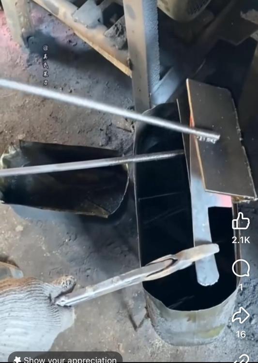

While browsing through some Facebook videos, I saw a clip of a bladesmith with an interesting twist on quenching — or, more precisely, a quench designed to prevent twisting.

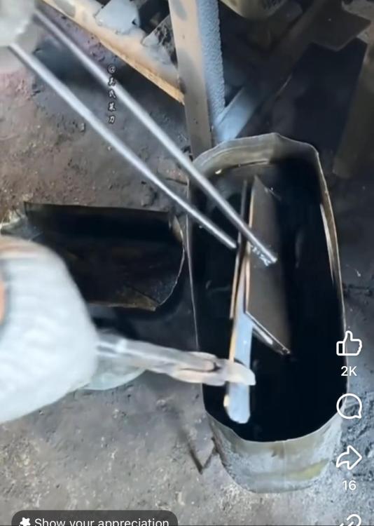

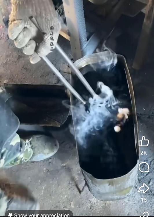

I know that there are people who quench blades between aluminum plates to keep them from warping. This appears to be a way to combine that with a standard oil quench, by hinging the plates and adding long handles both to squeeze the plates together and move the blade into the quenchant.
I couldn’t save the video itself, but here are some screenshots of the process:

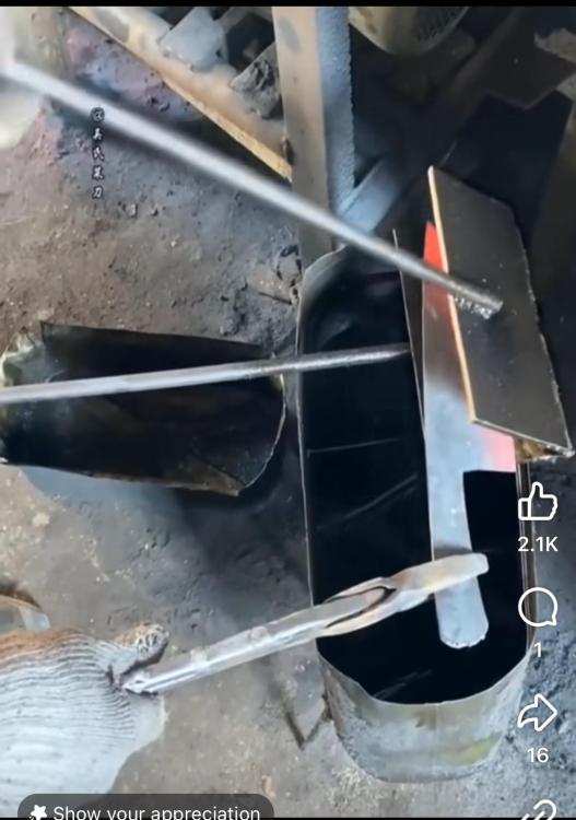

Given that the plates are clearly welded to the handles, I suspect that they’re not actually aluminum. Normally, I’d think that steel plates probably wouldn’t cool the steel fast enough to hit the nose on the T-T-T chart, but since the smith only appears to have heated the edge of the blade above critical and since the quenchant can probably flow in around the plates’ edges, maybe that’s not a problem.
Thoughts?

This seems to be an attempt to avoid warping during an oil quench more than the plate playing a large role in dropping the temperature quickly.  If that's the case I wonder if using some heavy expanded metal or something similar might even be better.
