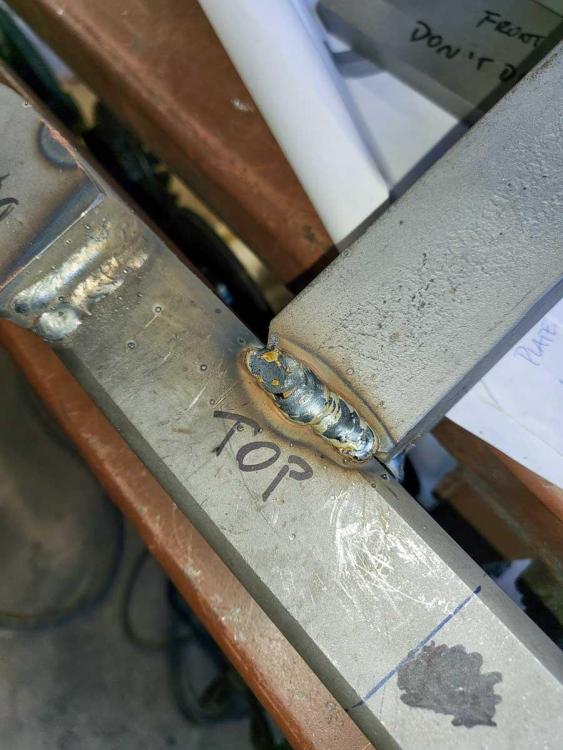

So I angle-ground some cuts and drilled some holes and then MIG welded the arm to the platen assembly. I took this before cleaning anything up. Next, I need to weld on these tiny little spacers. I'll probably glue them and do some tiny tacks.

Pretty exciting to start welding a new piece of equipment together isn't it? Competent looking weld.
Well, at least my welds hold, as ugly as they are.
It is exciting to make something and see it sort of looks the way it's supposed to. The platen assembly looks right and appears to work. I need to clean up the welds on the back of the platen—there are two bolt lengths on the back for attaching to the rest of the assembly. I don't need to do much, probably a bit of filing, and then use spacers to make sure the face of the platen is on the same plane as the assembly wheels. I mean, it really does look like what it is, so yay me.
Next is the arm with the assembly for holding the tables. All the parts are cut and prepped but I have to bend some of the bits once I have most of it in place. I'll try to get more pictures but I keep forgetting.
We have different criteria for good welds, mine comes from the pro side. Within limits "pretty vs "ugly" has little meaning or HECK the terms don't necessarily refer to the same thing. Competent means a weld that will do what it's supposed to and do it well. If I'd said it was ugly it would have meant it was NOT competent, grind it out and do a better job.
"Pretty" welds are a cosmetic observation and not necessarily a valid thing. You aren't tig welding stainless steel so pretty doesn't count. Sure your bead is a bit uneven, width and height wise but well within acceptable range and the edges are wetted well. The HAZ is wider on the side it should be and about the right width.
It's a competent weld. They'll look better the more you weld, your movement speed changed, you were probably concerned you weren't getting penetration on the corner of the tubing so you slowed down a bit and flagged towards the corner.
Next time keep the wire more on the corner near the low edge of the cut pipe and let the puddle fill into the thin edge of the cut pipe. Let the filler flow to the thin section. It makes a consistent travel speed much easier and beads more consistent.
That was NOT an ugly bead.

Don't ya love it when a plan comes together. Your welds look just fine, much better than a lot of mine and I've been welding for around 60 years.
