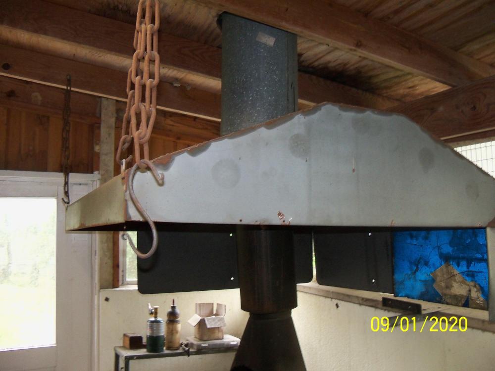

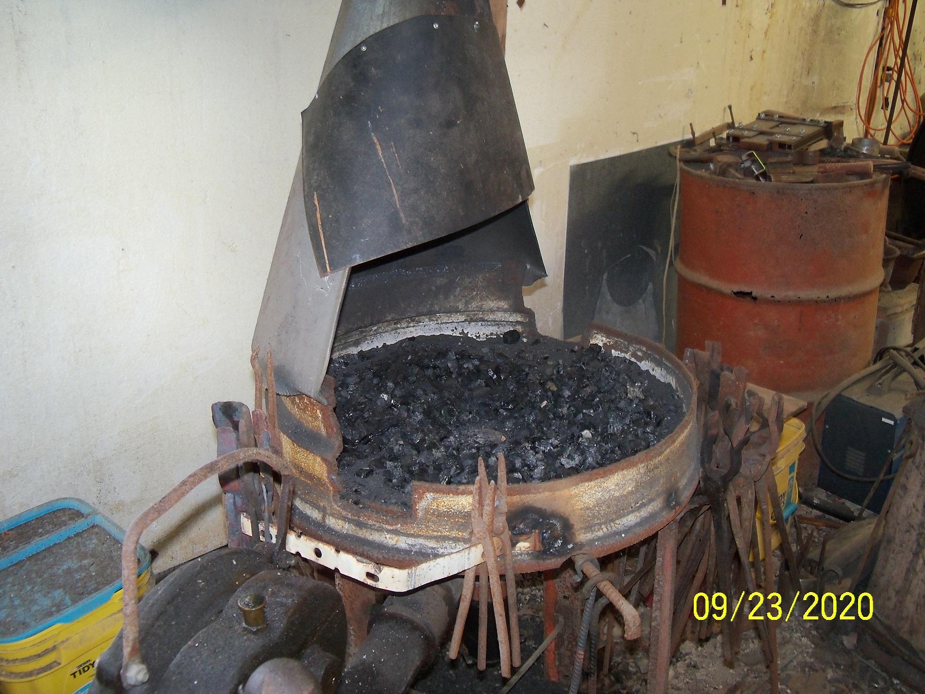

I had a similar situation as yours. The hood didn't draw strong enough. I tried an exhaust fan, no real help. My solution was to bring the chimney opening closer to the fire. It draws just fine now. Been working for about 20 years. Pictures were taken for another thread. Might put in some pictures for reference.
This was after the hood burned out some so I riveted on an extension, draws better now.
