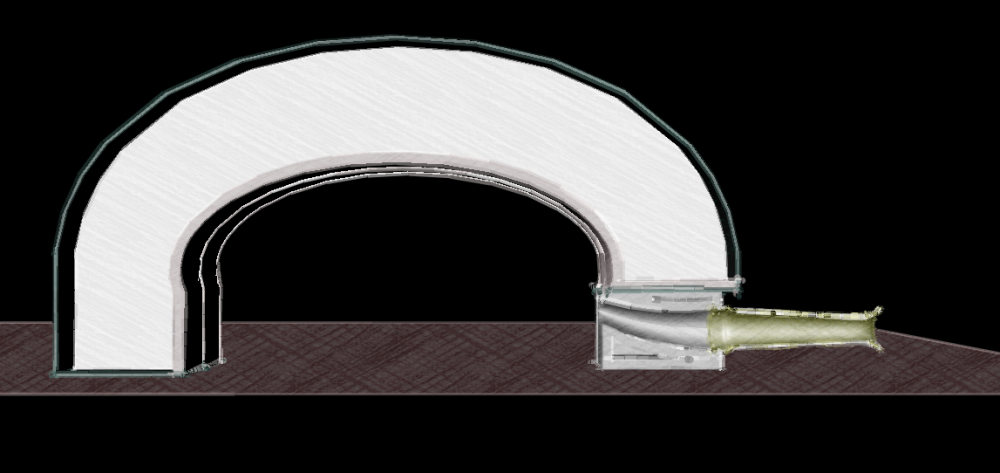

Since we only work  a few inches at a time, I am looking at designing wide body, but narrow depth forges.  We see similar in the ferrier forges with the wide side opening, but rarely are those side doors ever used by other designs.  When they are used, they do not block off the unused opening area to get that reflectance back to the forge.  So thought about the following smaller forge designs to keep from getting heat where it is not needed,  without loosing all that reflected energy.
Just a few volumes I'm considering, and will be building multiple shells for a table top adjustable forge.  I'll be keeping the burner entry as it's own entity as a 2" high wall with burner or ribbon angled up to swirl and keep from having that oxidizing hot spot, so could easily switch between designs based on needs at the time.

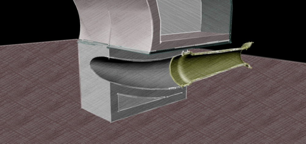

Here is an example for 10 inch wide by 3 inches deep. 5 inch high at the peak.  Gives 136 cubic inches. the doors can be closer to the openings, which would keep in more heat, but by being wider, would allow for more ventilation to keep from stopping the NA burner.   At least that's part of the thought.   This is with a half inch burner, so should get to welding heat?
side sketch 10 inch by 5 inch by 3 inch for 136 cubic inches - burner closeup.png
Yery good design work. However, you should consider a straight and parallel tunnel for your flame retention area. Otherwise, you are likely to end up getting back fires into the burner's mixing tube. Also, you would be better off raising the angle of the burner, and tunnel so that the flame is sure to miss impinging on the work, but more importantly to assure that there is no chimney effect after shutdown. Yes, a 1/2" should get this forge to welding heat. Yes, the exhaust opening's width is a plus, and I would suggest movable bricks for your baffle wall, rather than any forge door on this design.
    Thank you for posting such a fine drawing:)
Actually that area inside the block has the same area for the entrance and exit.  It is not a flare, and not intended to hold the flame inside the brick.  Simply flattened to make use of the area available in a 3" wall height.   Hopefully all the flame stays inside the forge away from my burner.  I am sure I can angle it more since nothing is stopping me from having a larger burner entrance block.

I get the better angle idea, this was a rough draft first time I have put my thoughts into paper.  And as to the paper, this is actually output from my software.  Reminded me of the old blueprints we used to have.  Can make oodles more as they really do convey the idea without worry about dimensions.
