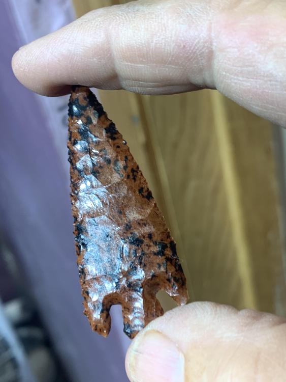

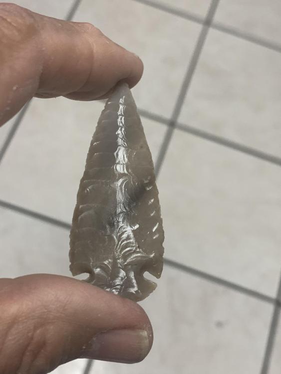

I do what is called FOG knapping. Short for flake over grind. It’s all pressure flaking.
78B66AD0-5BAF-4F5B-B27E-0B2C4C0C3AF8.thumb.jpeg.7d6be93e3261643bc1b40c62e9ef0405.jpeg74AFA5A7-7E08-46DC-BF02-A962EF506EF7.thumb.png.7d44a3a95098ef1be29c01414b9cfc81.png99201868-1E44-496C-9569-E97AE91BB43A.thumb.jpeg.b6f39e47e3c32c8cb215d87806e2696f.jpegB0A5E293-86B8-49EA-97CC-488609B33915.thumb.jpeg.123f55bf4530073f93d8f401f3a5357c.jpeg5F457681-83DC-41C5-8A12-DEA6DC2D4906.thumb.jpeg.eee0bd6854915e9eefdba2dafd9b7992.jpegF29EECA3-064B-473D-8A1D-E8865D40EA81.thumb.jpeg.7076bd6538a383c506c794b65e778132.jpegD69857B2-AEA8-405B-A30B-F989340DB996.thumb.jpeg.619bba9a1b3065faa6887b704c909182.jpegBDAE30A3-D622-4E08-BD3A-FBCB99A5367D.thumb.jpeg.05ca71ed18129b7556ced45e76821b67.jpeg Where I live here in West Texas there is what is called Edwards Chert everywhere. The problem is that all the property around here is privately owned. I can drive the county roads and in an afternoon usually pick up 50lbs or so. The chert is very tough and has to be heat treated. I usually use obsidian and plate glass because it’s easier. I do have a pile of Georgetown flint I bought years ago. It’s ready to chip in its raw state. As for collecting tools I carry a tire tool for digging and prying chert out of the ground and a solid copper bopper to field test with.
There is a knappin in Brady Texas next weekend and I’ll probably stock up on more obsidian. Mostly mahogany and dacite because it’s more affordable.

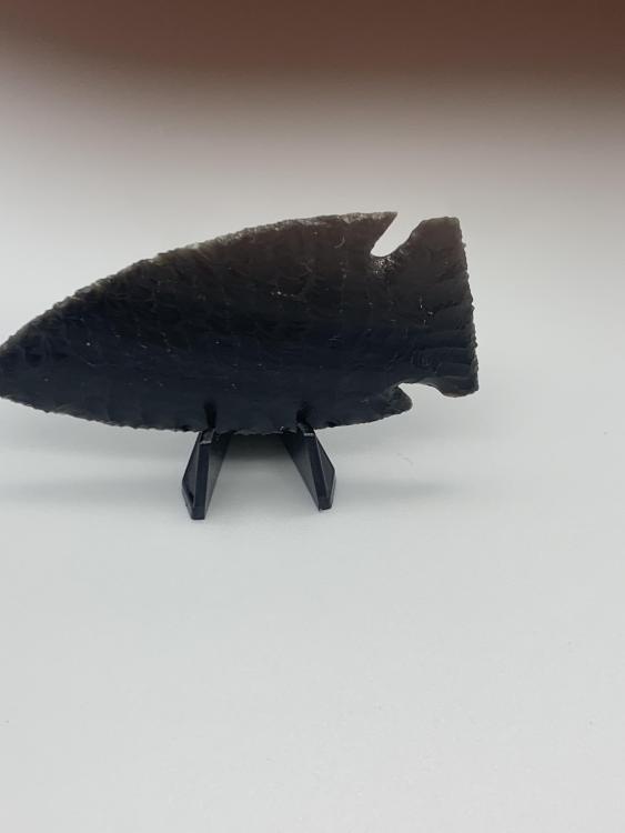

Is that a sawn blank? I've never heard the term, FOG but haven't done any reading on the subject in a long time. An acquaintance of my Father used to sell points flaked from sawn blanks of milky obsidian similar to what you show.
Nice pieces, especially the howling wolf.

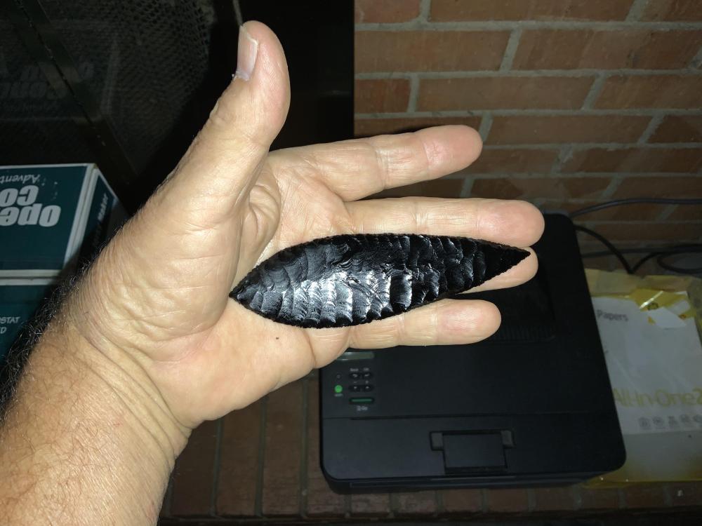

Ever work from a core? The pictured antler is more of a percussive bopper than a pressure tool.

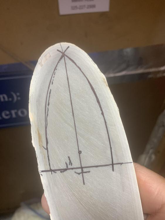

I take a nodule of material and cut it into slices with a diamond bladed table saw. I then take a slice and I cut out the preform with a diamond bladed trim saw. Hence the name FOG, flake over grind. There is more to it that that but you get the picture. From there it’s all done with pressure flaking. I’ve never gotten the hang of working from a natural nodule, knocking off spalls and reducing them to arrowheads. I can do it but they look like crap. So by doing it the FOG way I use much less material and get better results.
the pictured antler is a handle for the knife. Stay in touch if you’re interested in learning this process. I can show you videos of how I do it and even better I can put you in contact with the guy that’s teaching me. Everything is free, no worries about that.
