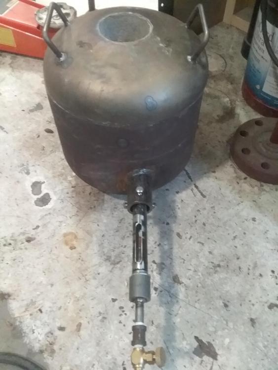

Finished this new foundry and tools last weekend. Refractory has been drying for 3 weeks so I did a cook out firing for about 2 hrs on lowest flame I could sustain until it stopped steaming. Seemed to go well i didn't get any spawling really. I used 2 types of castable refractory because I ran out on the bottom section and didn't have enough for the lid, they both seem to hold up well.I can't remember what types they were, they were industrial surplus from a job at work partial bags that they throw away. I welded several refractory anchors inside the tank, seems to hold up well so far. Orifice is a mig tip and the propane parts are salvaged from an old tiger torch. I've done a small amount of casting with a small crucible I made for my forge but it was all just pouring round stock for my lathe. But I'm new to this so it should be an adventure, lots of possibilitys with the lathe and mill.

What are you melting? What are you using for molds? Nice looking oven
Aluminum and brass. I made some flasks from 3/4" plywood and I have some sandblasting slag and powdered bentonite I was gonna make green sand out of. Now I just need to figure out a good first project.
