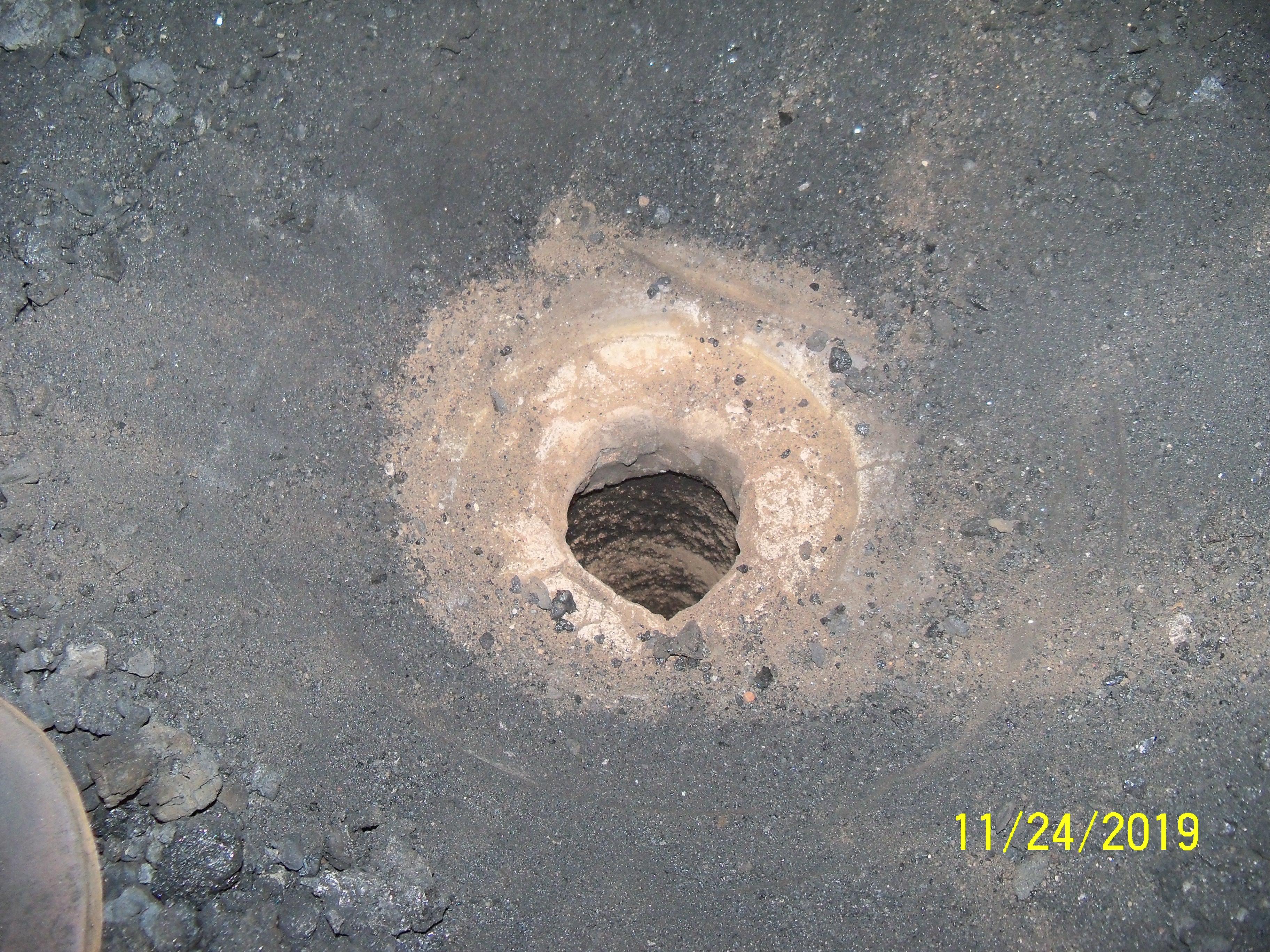

October 25, 20196 yr I mixed builders sand to act as grog into cone 6 pottery clay to shape the fire pot and hold in the grate on my home made forge. that was about ten years ago and it's still holding well. If I remember the mixture was about 3 sand to 1 clay. Made sure to wedge (need like bread dough) it well for a consistent mix. I built a wood fire without any air to fire it
October 25, 20196 yr Author That sounds exactly like what I’m looking for! Do you happen to have a photo? Did you clay all the way across at an even thickness then forge the fire pot down into that or do a ducks nest type thing? If the former, about how thick should I go in order to form a pot below it? Either way, I think I might have enough to get me going! Thank you very, very much!
October 25, 20196 yr Sorry it took a while to clean and get a couple of pictures. The fire pot is a ducks nest about three inches deep from the hearth. Originality it was seven inches deep, which was too deep so I built up the bottom with the clay with a four inch layer of clay and set the grate (which I can lift out) in the clay.
