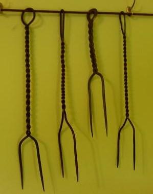

Well I prefer to have them make simple twisted toasting forks, one per person, that they then use to cook sausages/marshmallows etc with.

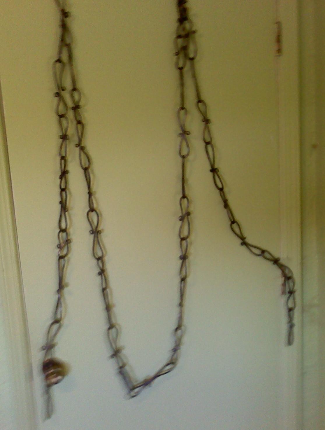

However one of the simplest chains:
Sorry for the picture we are losing the light here fast!
Thanks Thomas. That style of chain was what I was thinking would be suited but I thought I'd seek a second opinion.
Mine was made from the heavy but very mild steel wire they use to tie up bundles when ship rebar to stores that sell it over here.  It was a project for when I was just starting a demo and folks show up as soon as you light a match and want to see stuff going on while the fire is just getting going.  Very forgiving material. Makes a weak chain.
Thanks. This is more of a symbolic project than about making a strong useable chain.
There are some stronger versions that twist  the free ends around the central shaft.
