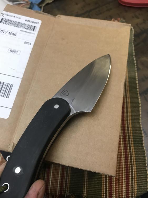

Made a skinner. Its a little heavy. Steel was forged from a slice of a 2 1/4” round drop I bought a little while ago.

Pay attention to the direction of your touchmark... so its not upside down... DOH!!

If I’m honest, I had to forge REALLY thick, to a rough shape, then anneal, then A LOT of stock removal. I’m not patient/skilled enough to keep it in that narrow of a forging temperature range. Red shorted, or plain cooked 2 pucks I cut off trying to forge closer to finished shape.

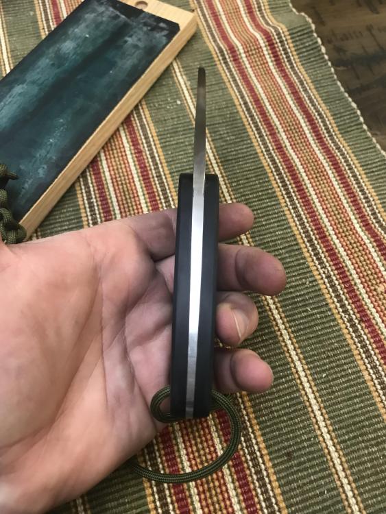

Proximal and distal taper. 7/32“ thick in the middle point.
Final cutting bevel is about 20-21 degrees.
SS foil wrap w/ some charcoal dust for O2 consumption. Heat to 1850F and held at temp for 30 minutes. Aluminum plate quench w/forced air. Straight into a semi-controlled temp/rate drop for a liquid nitrogen soak for 40 hrs.  No snap temper on this one.
here it sits above a pool of liquid nitrogen until it drops below about -100F then immersed the spine. Once blade equalized, dip right into the dewar for 40 hrs. Extra holes in tang an effort to reduce weight a few grams.
Double temper at 450 for 1 hour each run.
I actually was about ready to sand blast, I had read about that for a matte finish for grip, but decided not to for fear of not properly covering the blade portion and having some blow through. That and my cheap-o harbor freight gravity fed blaster is a little hit or miss on consistency. That was after I originally sanded the handle to a 400 grit finish, but it was too smooth, so instead I selectively went back and hit the more griping parts with a light 120 grit for a little more texture.
I scored a heavy line 1/8" from the edge of scales and ran a small bead of epoxy there after the regular paint-up of the whole tang. purpose being to squeeze out when clamped to make sure there are no gaps to let fluids of any kind get between scales and tang; should be sealed really tight.

I WAS going to use a checkering file and put some ridges in the spine from where the handle meets blade and extend to where a forefinger might rest, but since I was not doing a snap temper, I was worried about those being stress risers during the stress/shrinkage of cryo.
