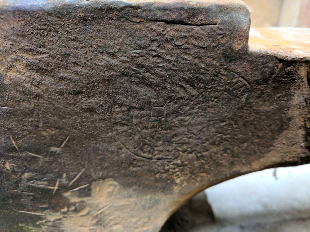

Came across an old anvil on my family's farm. Found a couple Maker's Marks. Maybe someone here can make more out than I can. Fyi if the horn is pointing north the marks are on the east side. Thanks. Can get more pics if neededIMG_20180204_144114.thumb.jpg.a8e0578086b9e597736864d9a33b6051.jpgIMG_20180204_144118.thumb.jpg.919972be89424a1bd68635ecd19ce0f0.jpg

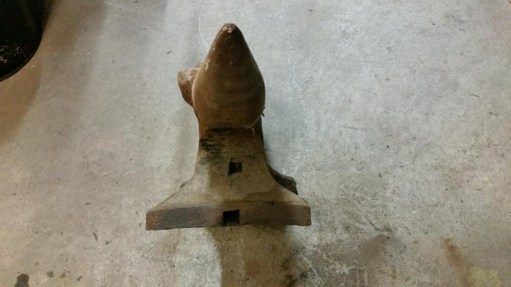

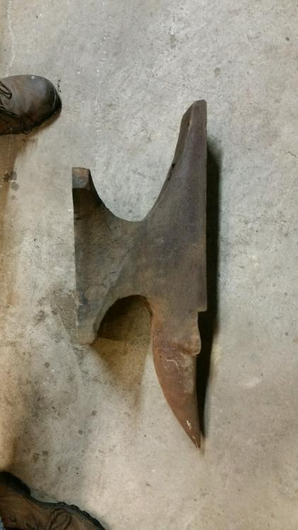

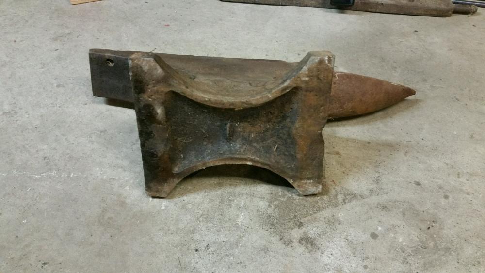

Need pictures of the whole anvil, the bottom and the edges of the base.

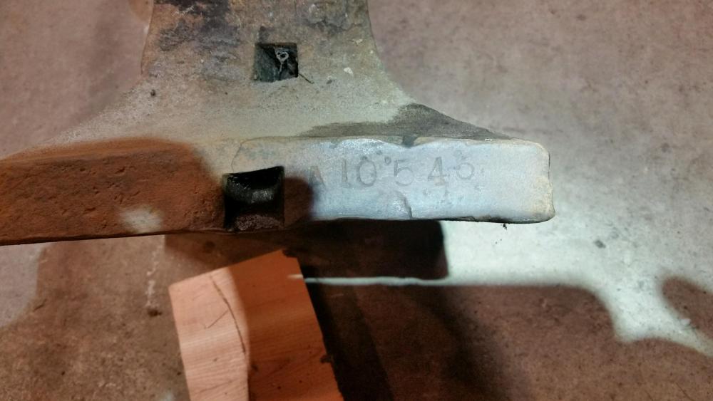

 That is a Trenton anvil with the Buell Patent  stamp.  Please take a close-up picture of the serial number on the front foot under the horn.
Thanks you guys! I should have some more pics in a little bit. I'll post em soon thereafter
Ya definitely farrier anvil. Numbers I see for weight is 129. Almost looks like a decimal between 2 and 9. I'm able to move it pretty easy so I'm guessing that its not using the "hundreth" scale or it would be upwards of 180. Not going to go crazy but I will give it a cleaning.
I like farrier anvils. That little shelf is very handy to start scrolls. :)
