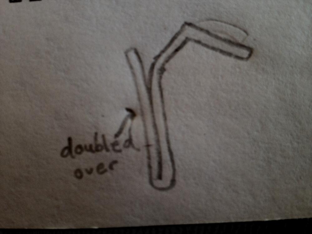

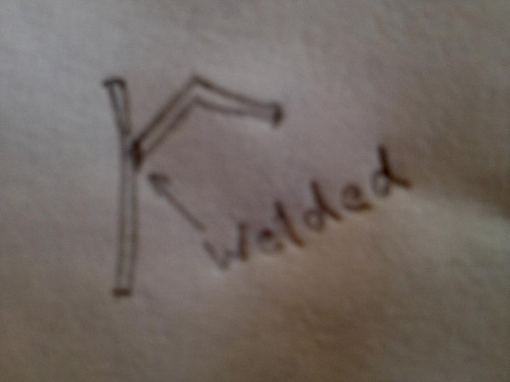

C-1ToolSteel Posted October 16, 2017 Share Posted October 16, 2017 Ah, now I'm starting to picture it better. Yes, both of those tricks are good ones. I keep a role of wire in my smithy, and you bet it has come in handy. Wire and Playdough can do some of those really complicated, brain frying, mind bending math problems that us humans avoid like the plague! It just comes naturally to them... The two simple ways to get this project done are... 1: Double the stock over for letters that have a piece branching out. (See example pic) 2: Weld on a seperate piece instead of doubling up. This generally looks better that #1. Sorry for the poor pics. Tell us what you are tracking on, and it will be easier for us to try to help out. Quote Link to comment Share on other sites More sharing options...
