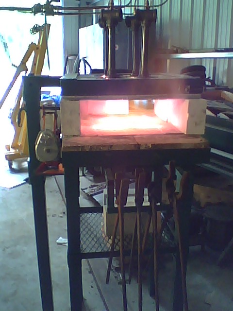

Sorry, I don't have a pic that directly compares to yours. I don't run a burner outside a forge so aren't going to look the same regardless of how they're tuned. This is my silly too large shop forge running all four burners, probably in a test. I've only ever fired all four at once when 3-4 guys were working in it at once. It only has about 1 1/2" of Kaowool in the lid and the flames are extending maybe that far into the forge. That's what my burners look like and that is maybe after 4-5 minutes of lighting it or everything in it would be yellow.
Looking again, this has to be a test run, all the soft fire bricks in the sidewalls are intact, after 3 or so firings soft brick starts crumbling, they are just not intended for this much heat.

When I said the flames don't compare directly I'm referring to how they behave differently in different conditions. Firing into a super heated chamber as opposed to open air. I don't even try to tune mine to run in open air so I don't really know how to compare them. I can offer an opinion about the fuel air ratio yours displays as shown but it will perform differently in the forge. I never tune a forge burner outside a forge.
