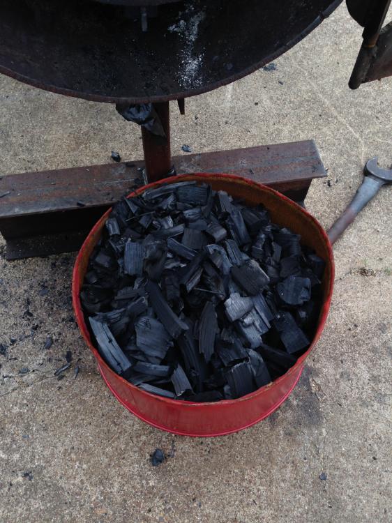

Kal Posted October 21, 2015 Share Posted October 21, 2015 Steve, you might want to check out Alex Bealer Blacksmith guild at http://www.alexbealer.org/ We meet the third Saturday of each month. Charcoal can be made in a steel barrel, a 55 gal one works best. If I remember correctly:place a screen of heavy rod about 6 inches or so from the bottom.cut a hole in the side below the screenplace a draft pipe from the screen to the top of the barrel. I'm pretty sure it should have some holes in it.align the pipe with a hole in the lid.fill the barrel with hard wood scrapsLight a fire under the screenYou can adjust the draft by blocking off the hole in the lidThe charcoal is ready once the smoke becomes clear, not smokeyThe whole idea of charcoal is to burn off most of the impurities and leave only the carbon from the wood. Of course if I have got any of this wrong, feel free to add to or correct these lines. Quote Link to comment Share on other sites More sharing options...
Nobody Special Posted October 21, 2015 Share Posted October 21, 2015 I play with this occaisionally. I'm in north Georgia. I go to the Bealer group when I don't have to work. Hmmm....I don't know about points north, but there's ore beds all over the cartersville area. S'where I get mine. Often ore wasn't mined if it was missing one of the crucial elements in the mid-1800s when it was mined here. Water, wood to make charcoal, or easy transportation.Charcoal? Knock a bunch of small holes in a 55 gal drum and stand it on some rocks or cinderblocks. Light a fire in it. Throw in small chunks of seasoned hardwood til full-ish. Put the lid on and prop it up a couple of inches. Let burn an hour or so til the smoke changes color, and possibly lights on fire from wood gas. Drop the lid, and CAREFULLY lower it to the ground. It will be shooting flaming wood gas out the bottom, and the sides will be at a red heat. Place rocks on the lid to hold closed and push wet dirt around the edges to prevent air getting in. Let sit 24 hrs minimum. Open. If it catches fire again, close it. Make more than you think you need by a factor of um....a lot. Quote Link to comment Share on other sites More sharing options...

GottMitUns Posted October 21, 2015 Share Posted October 21, 2015 Black steve, I think the pressure tank need to be inside the 55 gal drum to be effective. bring a vent line off the top of the pressure tank and down to the bottom of it so that the wood gas that is generated burns and adds heat to the tank. you should not need a leaf blower.Russell IMG_0404.MOV IMG_0404.MOV that was one we built for The Goliad Forge Quote Link to comment Share on other sites More sharing options...
