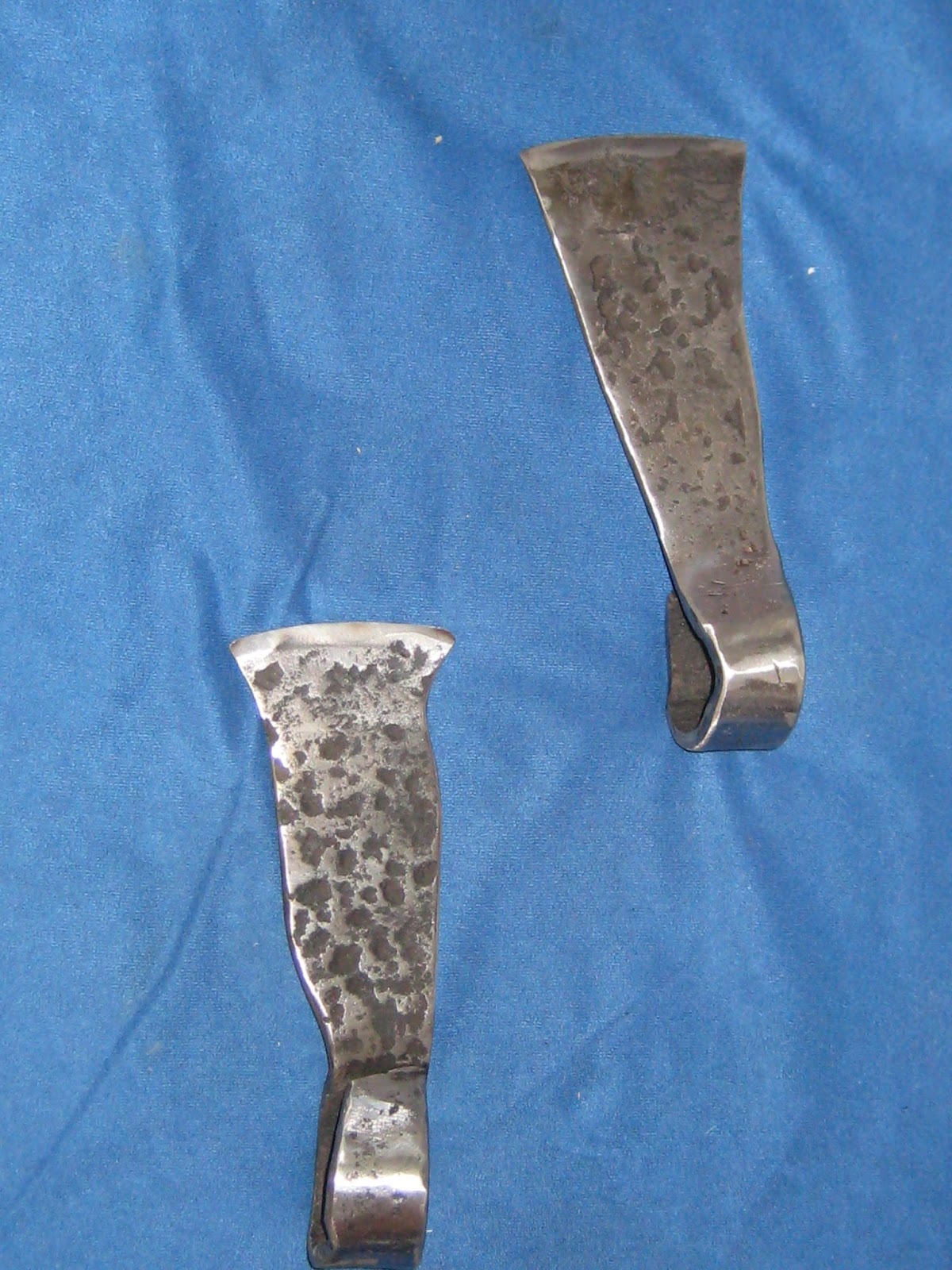

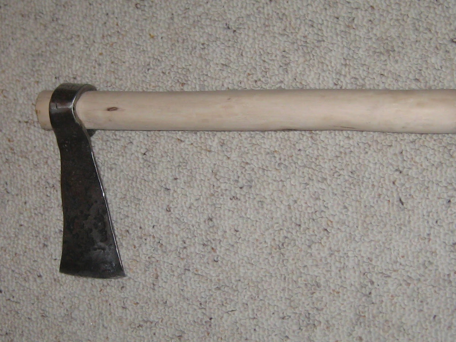

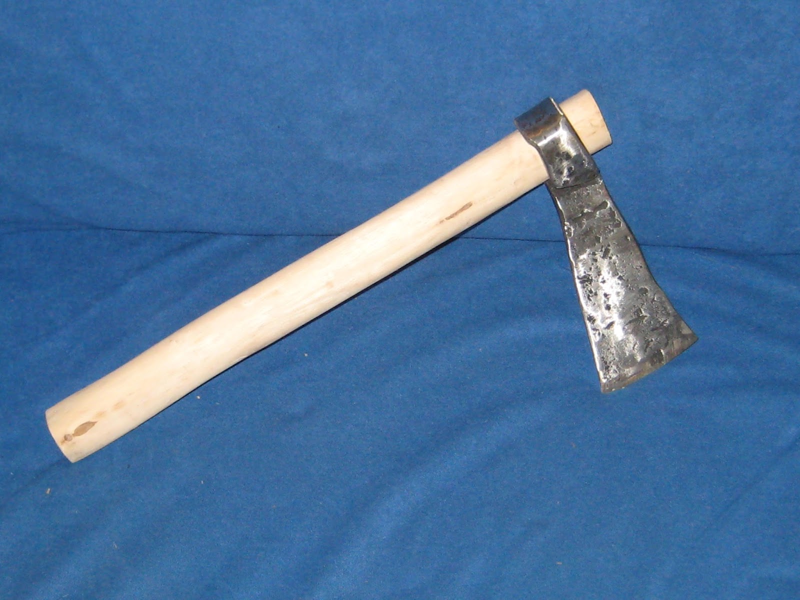

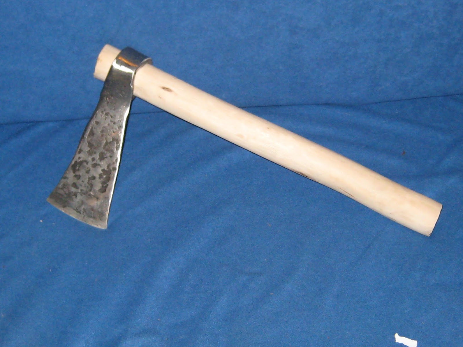

Frozenthunderbolt Posted October 18, 2015 Share Posted October 18, 2015 One of my fun little side projects has been playing with making a couple of light little frontier style hawks with a wrapped tapered eye.I know that there are those that will say that the wrapped eye isn't as strong as a forge welded or drifted one. They are right, but sadly forge-welding is currently beyond the capabilities of my current forge, and my current skill level. Thankfully, frontier style hawk is made with a tapered eye so it slides up the handle from the bottom, and locks in place as the handle swells towards the head.My concept is that with a wrapped eye, spring tempered, this increases the adaptability to different handle sizes anyway by my way of thinking. I started by cutting some rough bits of leaf-spring (hence my disinclination to put a finer finish on these two pieces). I then tried two different tacks with the two pieces;1. I tried wrapping the eye first and then disrupting the steel to thicken up the steel.2. I reversed the order - this lead to a better blade, though I achieved a better eye on the first one. I tried differential quenching on these blades - dipped 2-3 cm of the edge in my oil quench until it stopped bubbling, pulled from the oil until the heat crept in and blackened the oil and then re-dipped the entire head until cool.Result? Sharpened the better head (than I put a 45cmish handle on) cut through 15 cm of seasoned, sound olive wood without chipping, rolling or appreciably blunting. Happy with that. Here are the pictures of the rough forged bits: Shined up a bit on the angle grinder: Handle (hand cut hickory) on the more robust of the two heads (Note: Not yet finished with boiled linseed oil, but it will be). In the end I'm pretty happy with the second more robust one that I have hafted; reminds me a bit of a franchiska but lacking the up-swept tip.I cut through about 15cm of 5 year seasoned olive with this one with no blade damage.I worked on another two of these yesterday with square ends on the wrap and drawn out (not quite enough - eyes are a shade to small) from shorter stock.Interestingly, I experimented with water quenching the blade edge on one and succeed in getting my first ever crack! Now I know with my eyes as well as my brain why you only quench leaf-sping in oil! Quote Link to comment Share on other sites More sharing options...
dickb Posted October 19, 2015 Share Posted October 19, 2015 Never had a crack on anything I quenched in oil (just plain used engine oil) . I am using 1084, 1095 , automobile leaf and coil springs.But I did crack a couple of pieces edge quenching in water. It's disappointing to crack a piece after putting a lot of work into it so I am sticking to oil quenching. I have read a few articles about using clay or Rutland black furnace cement to differential heat treat a blade. I am going to try that on some blades where I am not satisfied with the shape as forged. Quote Link to comment Share on other sites More sharing options...
Worshipdrummer Posted December 1, 2015 Share Posted December 1, 2015 I have thought of trying something like this because I lack a hawk drift right now. I wondered about the wrapped handle eye but I had a thought to punch a small hole in the wrapped section and install a nail into the handle to "set" it firmly on the handle. You have inspired me I think I will give it a try this weekend. Quote Link to comment Share on other sites More sharing options...
