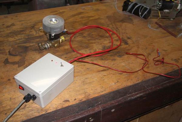

post-39957-0-92238800-1382247044_thumb.j
Interestingly got the solenoid valve out of a dumpster at work as they were having a major cleanup. The valve was part of a water cooling control panel for a vacuum furnace. It's indeed amazing what is thrown out.
The fancy looking ex-CPU fan and heat sink have been added to cool the solenoid which gets quite hot as it really meant for use use with water which would carry the solenoid heat away.
Unfortunately nothing is quite as simple as what I have described above as lighting the flame requires no forced air but some gas, so the air flow sensor needs to be temporarily bypassed while the flame is being lit.
So I made up this control box (grey box in middle of photo) that has a few bells and whistles to enable a safety aware startup to take place
post-39957-0-42725300-1382247029_thumb.j
A small switch temporarily bypasses the the airflow sensor. At the same time the bypass displays a red LED and sounds a piezo buzzer to warn the operator that the airflow switch has been bypassed.
The operator can then manually open the gas line just a whisker to light the gas (this generates a yellow smokey flame about 150 mm long)
The the air supply is turned on just enough to get the flame approaching a green colour.
Then the gas is turned up some more, the air some more, and this is repeated until a satisfactory flame is generated.
At this point the air flow is sufficient to keep the air flow switch closed so the bypass switch can be turned off.
This also switches off the red LED and the buzzer, and also switches on an orange LED
If the power fails at anytime during start up the solenoid will still active and turn the gas off and the orange.
The control box contains the 240/24V AC transformer and the rectification circuits for the LEDs and Buzzer.
post-39957-0-76443400-1382247032_thumb.j
