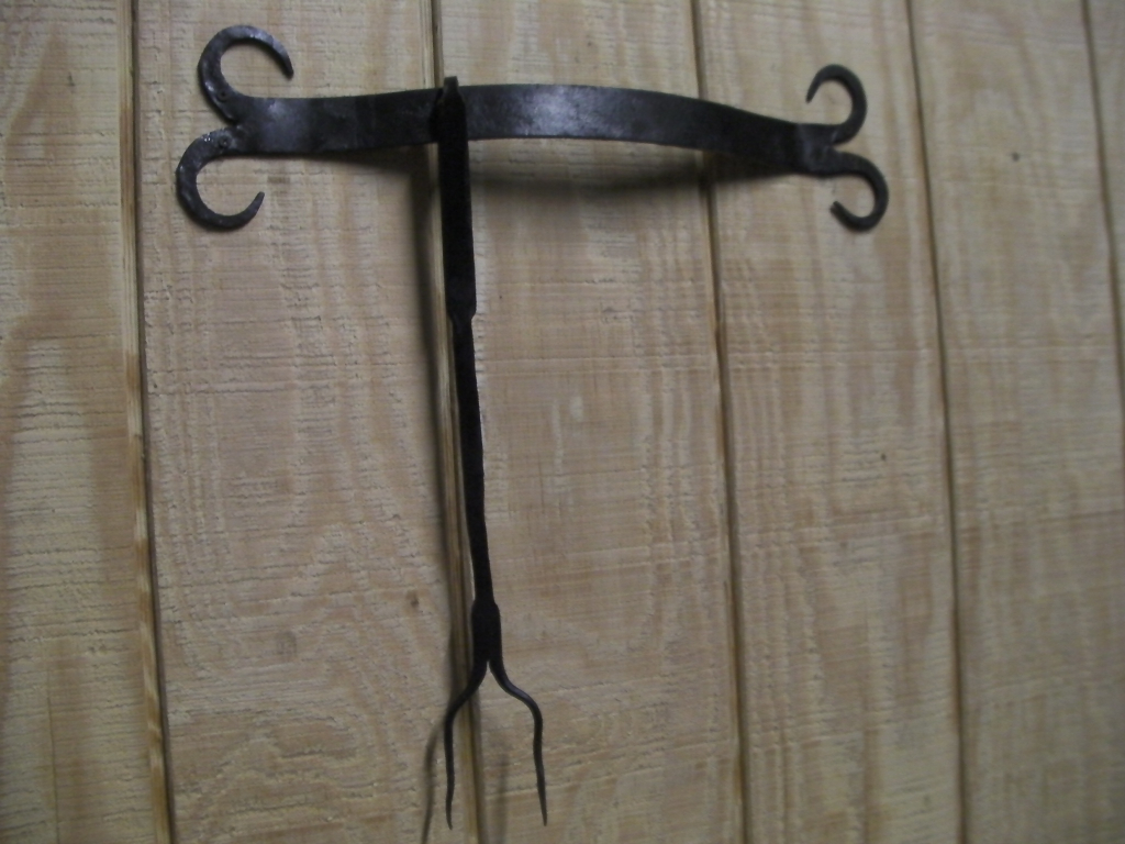

Since I have been working on my log house, I haven't had much time to do some "new" just for fun projects in the shop.
I am wanting to do all the iron work for my log house (right down to forged nails for the flooring), I know it's a pretty big under taking, but it will be a showcase of my work.
Right now I am working on a 18th century cook ware set, so far I have forged out a roasting fork and the wall hanger.
Here is a pic attached
I am wanting to make a ladle for the set, but I don't know how to make one. Any of y'all know how?

There are many ways with everything from monolithic construction to forge welding, forge brazing or even riveting the bowl to the handle. As real wrought iron was used at that timeperiod, (modern mild steel starting around the 1850's with the Bessemer/Kelly process), a lot of quite delicate forge welding was done---much harder to do with modern materials.
Riveting is the easiest method.
Monolithic would be to take a piece of stock large enough to make the ladle bowl, isolate the bowl section and forge down the rest for the handle---definitely better with use of a powerhammer!
As always, Thomas makes a lot of good sense, riveting is a good way to go.
If you wish to try two somewhat more difficult methods you can:
1) Take a larger piece of stock and either draw out the handle, or draw out enough of the handle to allow you to forge weld the stub to a longer and narrower handle than the ladle part.
2) Or you can enlarge the end of the stock by either upsetting or forge welding. For example, you can roll up or fold over one end, forge weld the resulting mass into one lump, then you have enough material to forge the end out into a ladle or spoon.
For better or worse, there tends to be numerous ways to smith stuff. Ask 20 different smiths and you might end up with 20 different answers. ;-)
